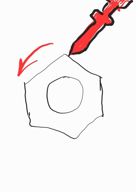

Years ago I needed to replace the clutch fan on my F150. The nut was 1 5/16" from memory (large). I tried everything. Then remembered I had an air chisel. It was right hand thread so I put chisel on nut flat right at edge as shown. Bad drawing but you get idea.
It was easy, apparently the vibration spun it off and as it turned put it on the next flat as it turned.

Good idea if I can get the chisel in there. Do you remember whether there was any damage to the nut? I have done similar with a screw driver and hammer in the past.
I think the trick is that there is a lot of instantaneous power released every time the hammer hits....more than you apply with a wrench.
Thanks for the suggestion.

I used a chisel that needed sharpening and no damage to the nut. In my case the new clutch fan came with new nut anyway.
It worked well for me.

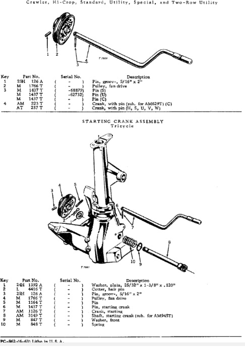

Update. Decided to just try and remove the belts from over the fan. That was a success. However, there is one tight spot that has become a problem in installing the new belts. There is a spring loaded shaft that is pushed into a couple of detents on the crankshaft for crank starting the engine by hand. The old belt fit through the gap between the start shaft and crank pulley because the belt was worn so thin on top. However, the new belt is much wider and does not want to go through the gap.
Any ideas out there? Can the spring loaded starter be removed easily....or pulled back somehow?

I think I just figured out the starter issue. Apparently this type of hand starter only exists on the tricycle model of the JD 40. There is a spring clip that holds the starter in position. Pop that off and the starter can apparently be pulled back out of the way or maybe removed. I may not be able to put it back once it is off because it is tight in there....but when will I start it by hand anyway? I have no clue where the hand crank is....

I agree Kroil or good penetrating oil. In my case with air chisel it was super easy after hours of trying everything imaginable. I wasn't using lots of pressure either and just the vibration and that angle was enough. Once started is all that's needed.
Like everything, use your own judgement.
