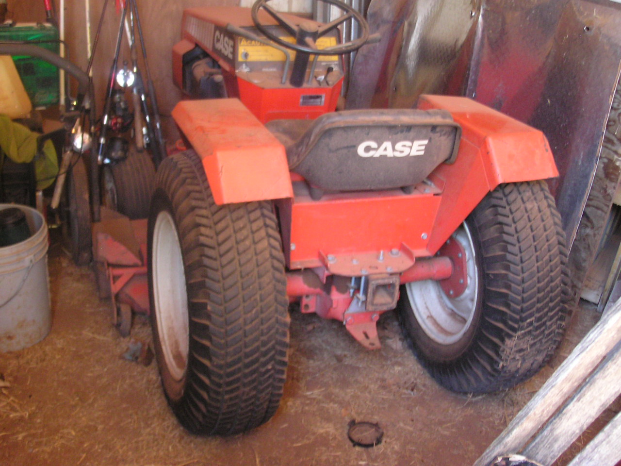

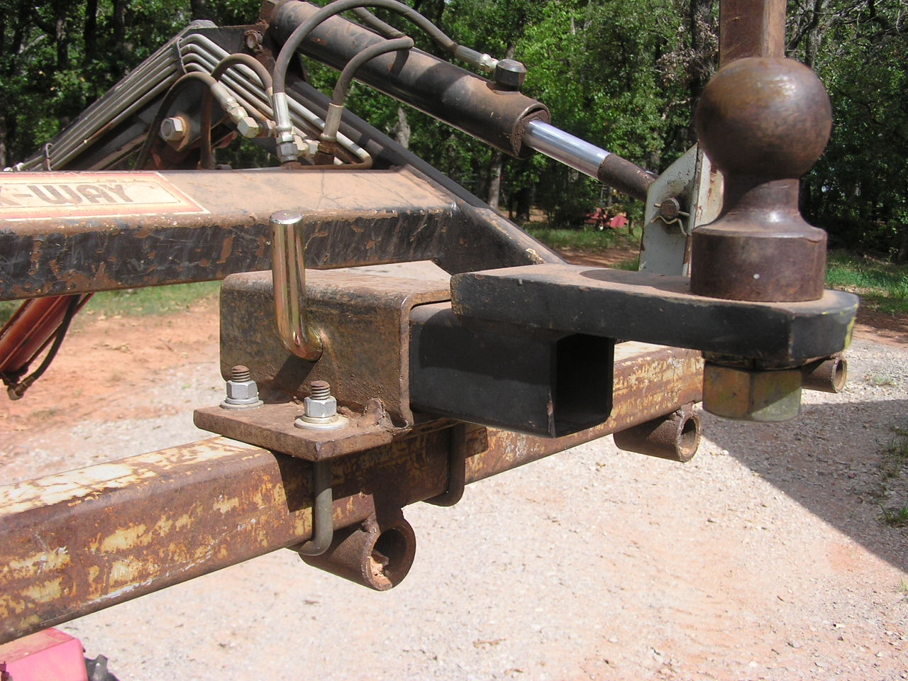

If you don't weld, it can be clamped on with long bolts and strap iron like this picture of my 446 from 8 years ago:
And using square U Bolts like on my brush fork frame:

   / 445 - 2" receiver setup at rear hitch. Options? #15
I've seen a couple of pictures with a 2" receiver setup attached to the rear without a 3-pt hitch. I DO have the click-n-go system in place.
I've looked around, but can't find something that would hook up directly.
Here's a picture of one I found - but didn't know if it was commercially available, or just something that was fabbed up.
Thanks!
There are a few options available that could be made to work. A step bumper receiver plate would probably work. Harbor Freight also sells an "ATV Hitch Adaptor" that would bolt to the hitch pin location on most mowers.
