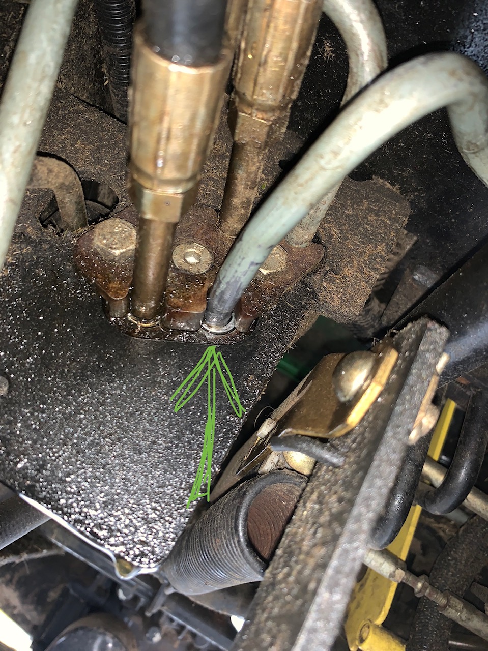

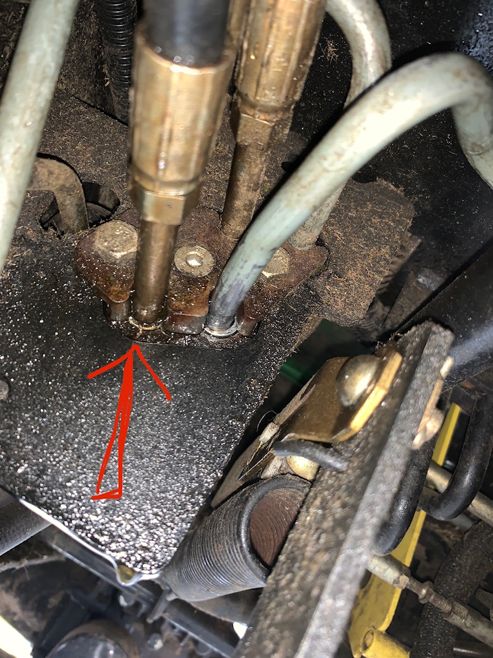

Got it! I missed that scrolling though my phone. Although fluid was spitting everywhere when sh*t hit the fan, I don't see any apparent breaks in a hose. But when I start it quickly, fluid seems to be oozing where the lowest hose enters the valve, see photo. Thanks again!! IMG_0965.jpg

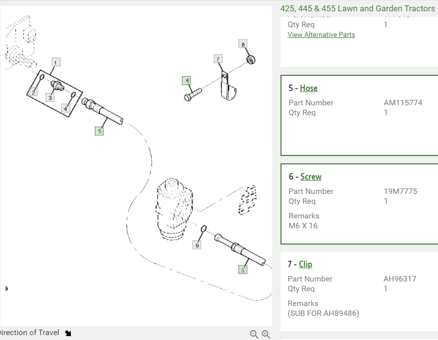

John Deere Power Steering Hose - AM115774
Does that hose connect to the transmission where the pump is located?
Schematic from jdparts showing the hose supplying the power steering box.
Maybe just o-ring replacements needed.. your call.

It's the hose that goes out to the steering cylinder. However, there is no retaining clip on the hose you pictured and so there is a small cut in that line although not enough to leak. I only noticed today crawling around under the tractor. So that hose will need to be replaced and finally the retaining clip installed. I'll get the hoses pulled off and see what the ends look like re: just replacing the o ring. :dance1:

Nevermind! Its not the flexible hose, it is the hard line and it sheared off right at the pressure plate. Looks like there is another post in the forums about this same issue. That gentleman had it soldered back together.

Help!! I've got this question posted on another thread so I apologize for that, but I am really stuck after 5 hrs of trying to get this fixed. I have the hard line in place, one end hand tightened onto the SCV and the other line is sitting in the steering valve. However, I am going to really need to push this into place so it sits in the correct port. Right now it is sitting nicely in the port just to the left, where the main hose from the transmission is supposed to go. After all this kicking and screaming, I am hesistant to really push this hard line into place. Has anyone done this repair that can offer some guidance?? Please and thank you!!
   / 445 busted hydraulic hose #19
If the correct receiving port is clean of any debris and the o-ring is the correct part number, then (although admit to not having done it) I'd force it in or rely on the bracket that holds it in drawing it tight when snugging up the two bolts.
