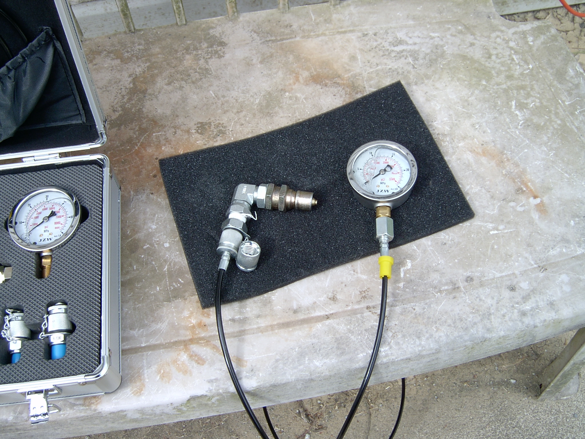

I just tested the loader svc with a kit I got off ebay. Nice kit. Here is a pic of the kit and the setup I used to test. I got 2800psi when lifting the loader arm up and 3000psi when back to the ground trying to lift front end of tractor up. So I'm guessing relief pressure is 3000psi. Or, it may have been 2800psi both times. There was a bubble right where the needle was pointing. So I'm happy with the pressure there. I'll test backhoe pressure later this weekend.

Pretty neat kit. What do all those adapters fit? Assuming they are adapters.

It's a maintenance hydraulic test kit. The adapters are for different size valve, cylinder and pump hookups. Metric & SAE. I had to buy the 1/2" elbow to connect to the quick coupler separate. $5 from TSC. Kit was $52 to my door from EBAY. So far, I like it.

Yes, but is there a list of what styles/sizes of fittings the adapters fit? My problem is that with all the different fittings used today, I never know which one I'm dealing with until I take one off. At one time If I had adapters for NTP or J.I.C. I could get into most any system. Those days are gone. Now I need a forty lb box of fittings and adapters, and more often than not I still have to run to town for something else.

True. I understand that. The fittings are all NPT. 1/4" to 3/8" and 8mm -14mm. That's why I had to buy the NPT to JIC elbow to fit the quick coupler to plug into the loader SCV. I bought the smallest kit listed. They had others with more fittings and adapters. More money tho. There was a list of what each fitting and manufactures they fit in the add. If I would have connected to the cylinder line on the loader, I don't think I would have had to buy the adapter. I just didn't want to take anything loose. For my needs. this kit will work fine. From Winchester I see. Been there a few times to work on strapping machines at a printing company there. Name escapes me at the moment. That's what I do. Work on strapping machines. Bunn string tyers, pallet wrappers, scrubbers and conveyor systems. That's what the company I work for does anyway.
