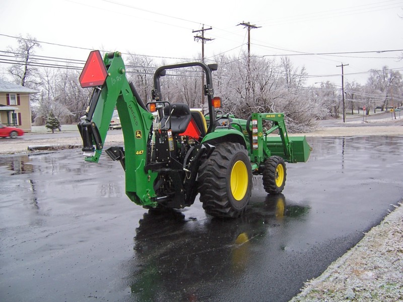

I bought a 447 back in January for $5900 cash and carry ,including the power beyond kit.Did the install myself ,not that bad ,probably 3 hours and I took the fenders off (you can drill clearance holes for bolts,but I,d rather not).I have a 4300 but I,m sure its similar.I actually dont live to far from you (I,m near Batavia) .Got mine from Goodridge in Oakfield ,good people to deal with.
Jeff

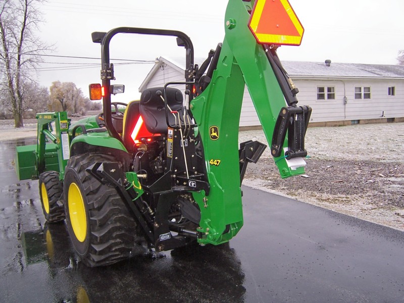

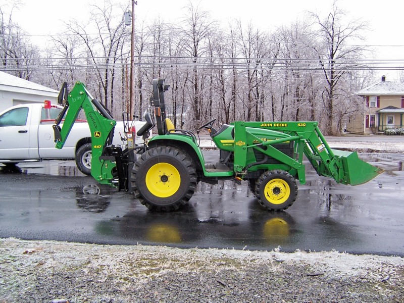

A few pics before I put the bucket on.
