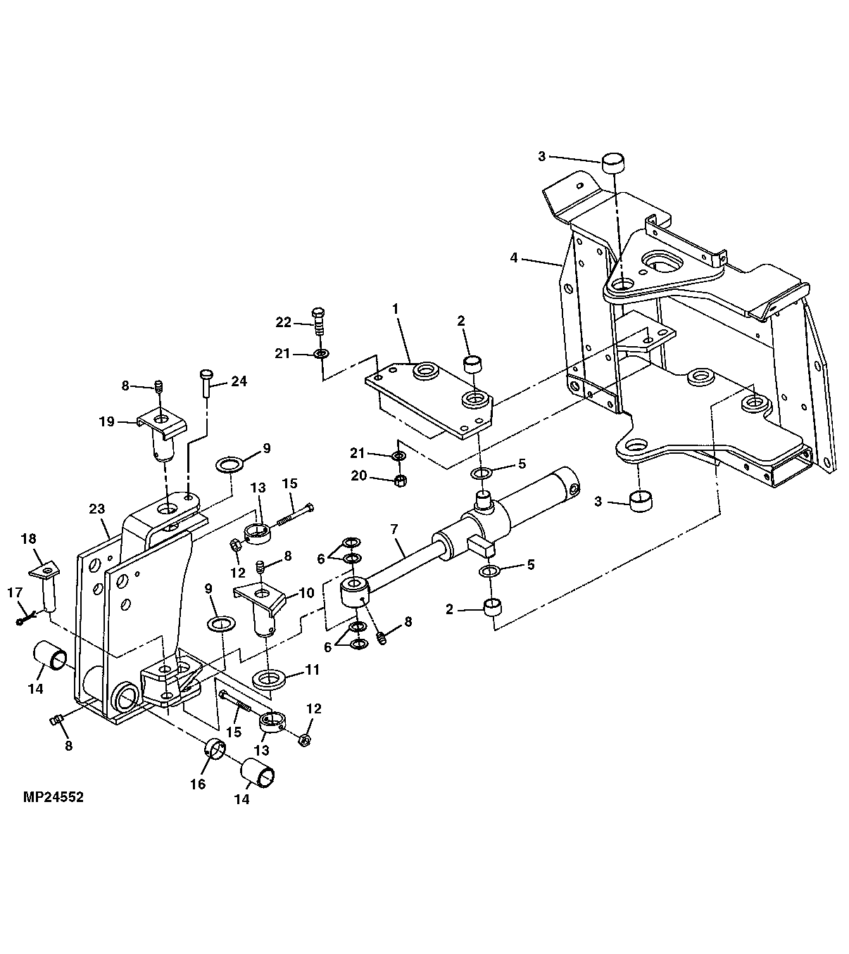

Hi gang:
Lower pivot has become impossible to grease. I have removed the zerk and it is not the issue. Has anyone disassembled this pivot and can offer suggestions? I have been using JD grease, so hardening should not have been the issue, leaving me with a grease port / relief that has either twisted out of alignment or has had metal smeared across it.
I have tried unloading the weight using a jack, swinging full arc while pressurized, using a "super pressure" grease gun.
exploded view would help. I could buy the shop manual, but I don't know if that would help or not.
Thanks

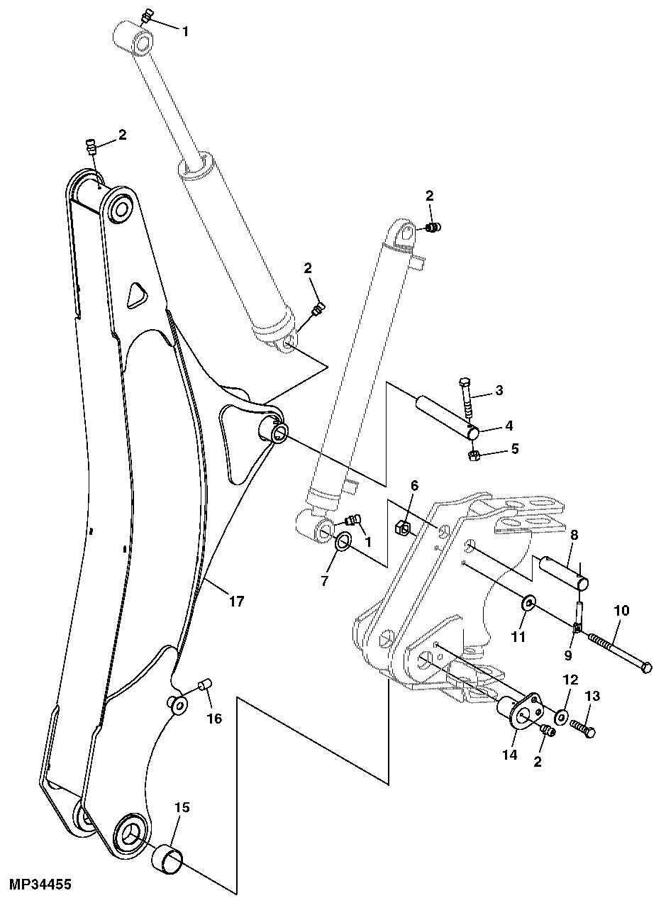

Some are from the 48 BH because the pictures did not come up on JDParts for the 448. Should be similar though...
OOPPS, two are the same...
