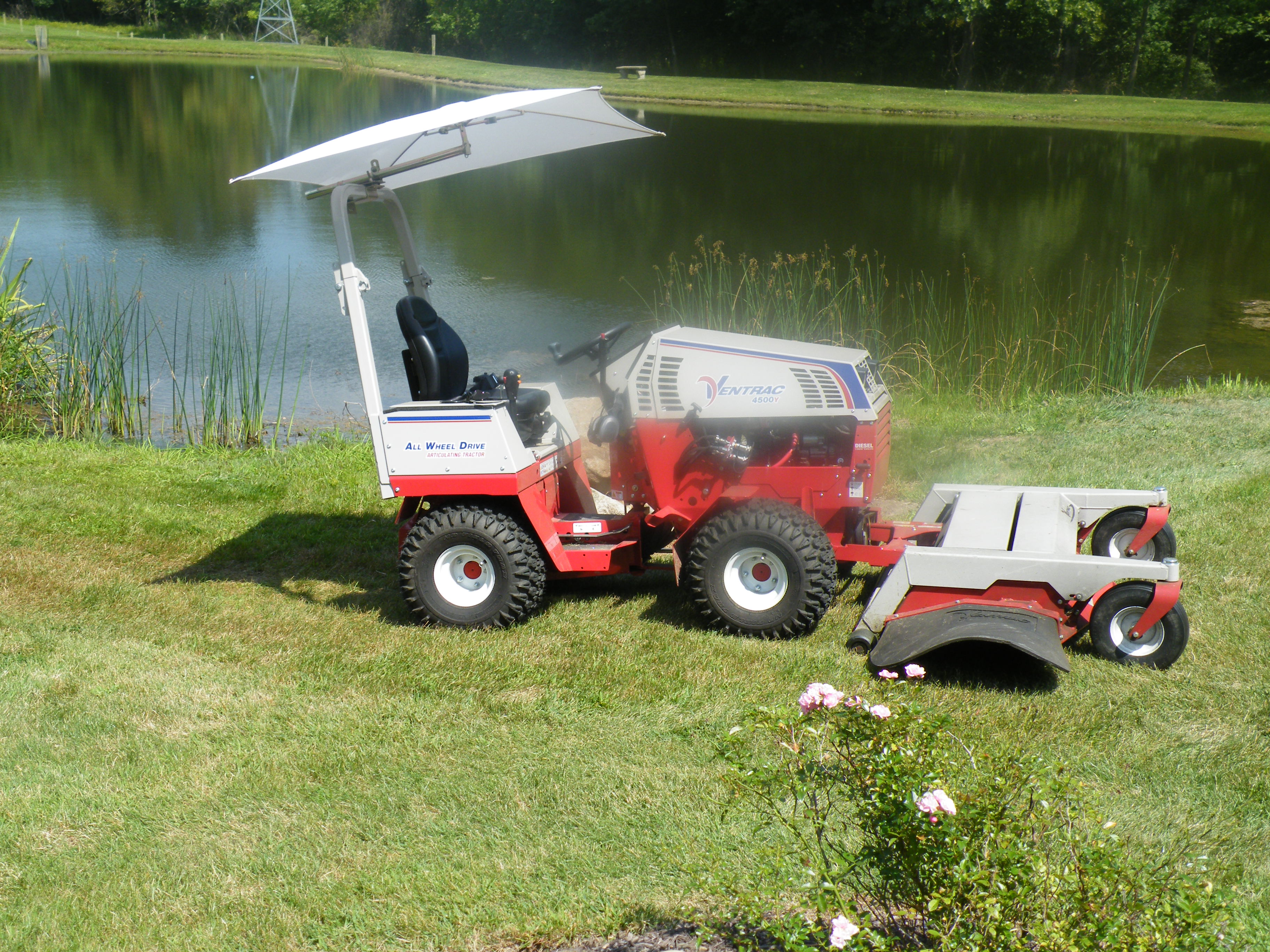

I have the foot pedal and the hand control with a Femco sun top.

Does the articulated deck have that rear roller apparatus?
Yes, each of the three sections has a rear roller.
What about leg room? I am 6'3" and notice no problem with leg room. On very steep right leaning slopes my big ole butt does tend to press against the SDLA lever, I modified the arm rest to take that weight.
Do you have a sun canopy? It looks like it would be a tight fit for headroom based on the height of the rops.
No, but TN Marks does have the canopy and he is not little fellow either, seems to him well. I have too may trees for a canopy and typically have the ROPS folded down unless on severe slope.
Do you use the hand controlled hydrostat or did you get the foot pedal.
I have both. The foot treadle is mechanically linked to the forward/reverse function of the SDLA. The treadle is very handy when in brush or other situations where a hand needs to be free.
