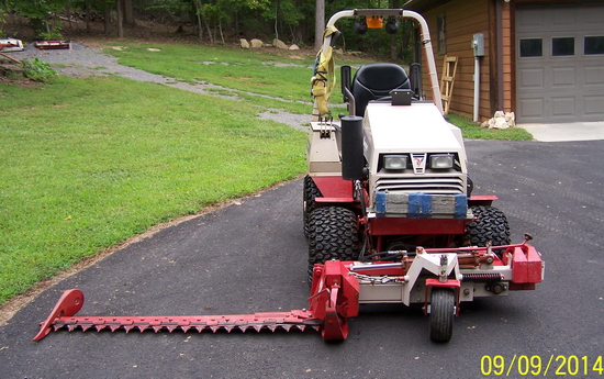

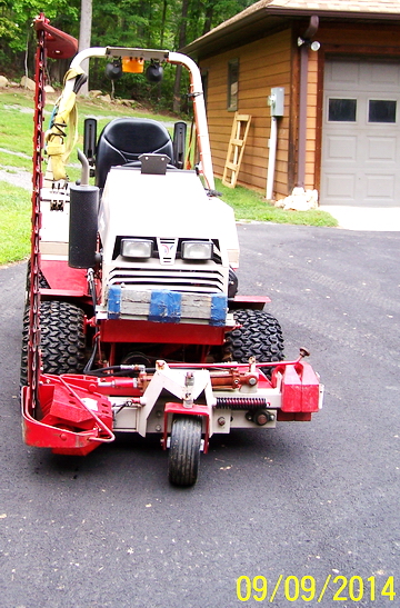

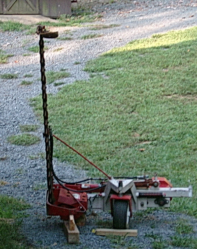

BK, sounds like you've had a couple good units. I'am a firm believer in routine maintenance and agree with your philosophy of oil, filters, grease, and radiator screen clean after every use. I'am so ocd that I'am embarrassed to say but am in the process of waxing and detailing the tractor and attachments right now. Got about 2 more days before time to mow again. Where did you come up with the sickle bar mower? I have been searching for one to mow pond banks with. All I find is one that connects to a bucket and is 38" long. Gotta be to close to the water with that one for me.
   / 450cause the seat to lower enough that 0P 50hr service and evaluation #9
Ventrac had a Sickle Bar mower made for them by another company for a short time. I had asked my dealer and asked on this Ventrac forum about one and one of the Steiner brothers actually found one that was sold, but rarely used by a DOT in the south - I contacted the dealer that had it and had it shipped here.
You might be lucky enough to find one - this is 5' - I wish it was 6' or 7' but it does a nice job.
