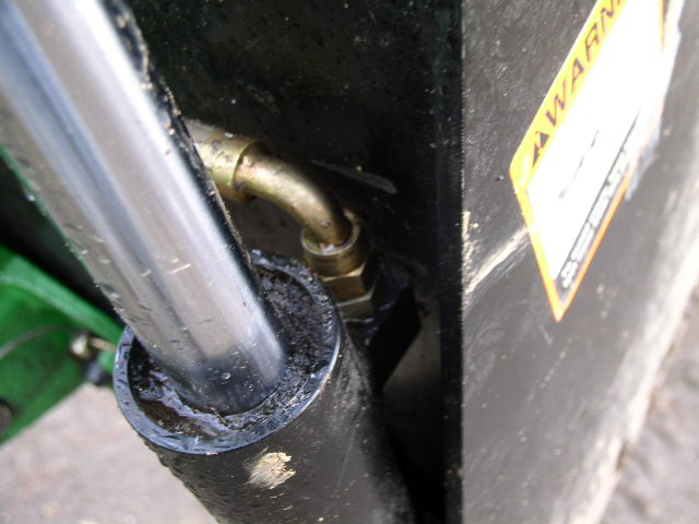

Looks like JD recognized that there was a problem with too little clearance between the bucket and inlet, and fixed it. If there was a recall then your dealer should have tracked you down. Although, according to my guy here, it doesn't matter where you bought your tractor, all the dealers should be prepared to make it right.

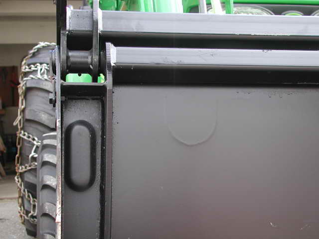

Jon, the sun came out today so I was able to position the bucket to get a good photo that shows the indent. This one is from the front...
   / 4520 with 4n1 - put to work
#14
... and here's one from the back. The indent is a less obvious, but it extends up well beyond the end of the hex fitting.
Also, on my 4-in-1 the square post that the hex fitting threads into extends beyond the diameter of the fitting, so even if the bucket were able to bounce back that far, it would hit the post and not the fitting or the hose.
Hope this helps...
Tom.

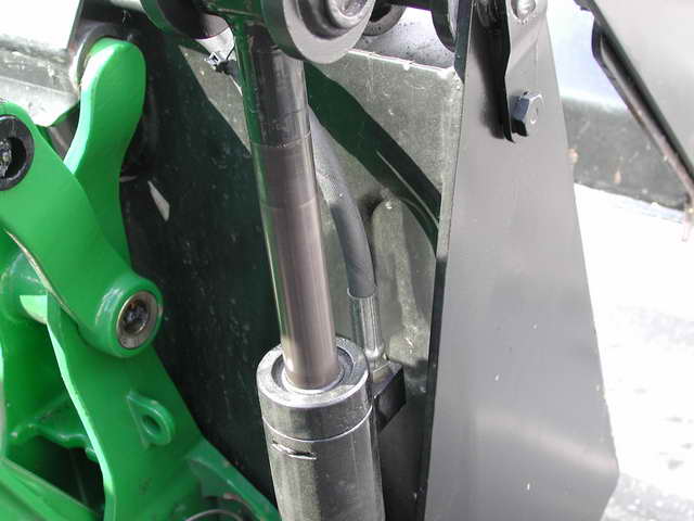

Thanks for the pics. Yep, it sure looks like JD changed production to address the problem. I've taken some shots of mine as well. You can see the mark left where the bucket impacted the fitting.
Seeing this, I can't but think they'll make it right.
Jon

Another shot, this one of the damaged OEM hose.
Jon
