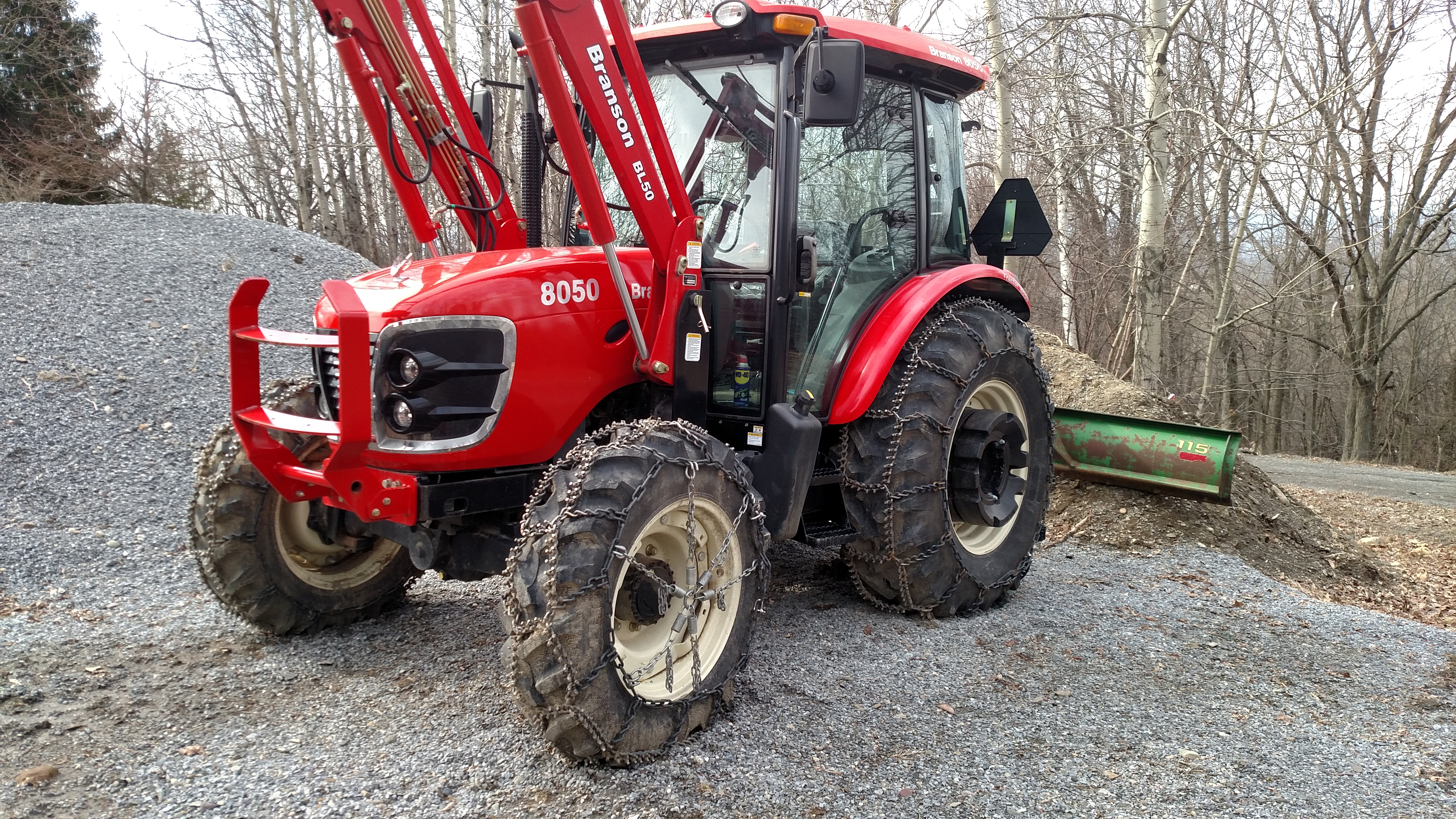

I have chains for the front of my 8050 but I almost never use them as I can use my rear chains.
I only mount the fronts if a major ice storm is predicted.
In your case not being able to use rear chains if I was going to use front chains only I would be a bit concerned as the front would be working all the time and pulling the rear end.
That said you will not get much more traction with chains then then when working it hard in 4wd in the summer.
I would recommend the Euro style chain as you will be getting uniform traction not the slip and grab of conventional chains.
These are good chains;Trygg SMT Flexi Studded Alloy Tire Chains
They are expensive but the traction and smooth non vibrating ride of this type is exceptional.
