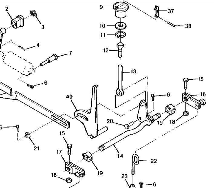

Near the Adirondack Mtns, NY
John Deere 455 AWS
I could use some help with my new-to-me 1999 455 AWS w/ 60" deck. I'm trying to adjust the deck height and suspect something is broken. I hydraulically raise the deck and try to adjust with the adjustment wheel as per the manual. The indicator doesn't move, the wheel binds up, and when I lower the deck it goes all the way down onto the wheels. The indicator is pegged at "all the way up". I know this is a mechanical stop. Anyone ever have this problem? Thanks.

Don't have the problem, but it sounds like the stop is on the wrong side. May need to remove the fender deck and get to that adjustment mechanism.
With the deck raised, the adjustment wheel should move easily and position the height finger where you set it. Then lowering the deck it will stop at that finger position, carrying the deck there.
Here is layout of the linkage. Possibly removing the deck and looking at the lift mechanism from underneath will help you identify the problem as well.

Posted a pic of the mechanism.
The fender deck follows removal of the seat, then just follow the bolts/nuts that hold it on. As mentioned, if the mower deck is off, looking at the underside to see how that height mechanism works may identify the problem.

I poked around in the service manual for the 455, and have these items from there, including a write-up of the adjustment procedure for the linkage. It may help to make a bit more sense out of the mechanism. For me, I wasn't aware of the warnings pointed out in the third pic, about not raising the deck too high. Something I may be guilty of and will need to look closer at mine. ;)
