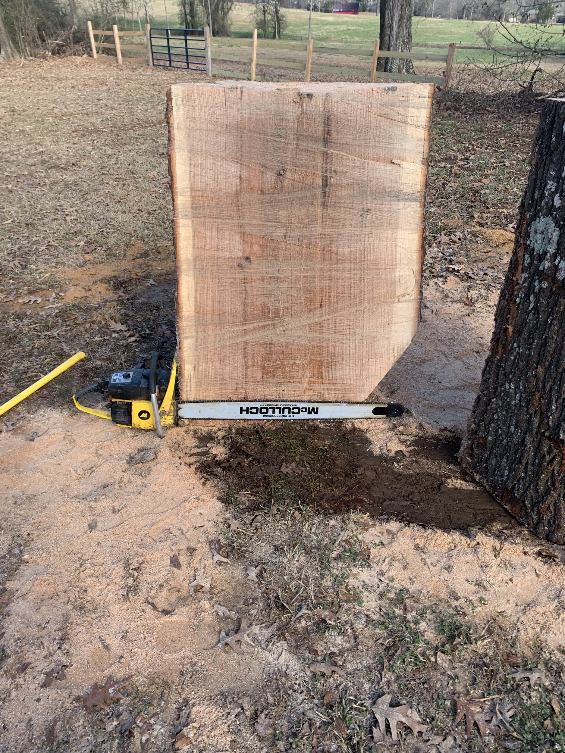

I replaced the factory bar on my 455 with an oregon bar...the oiler holes didn't line up and I had oiler issues took me a while to figure it out. .
I replaced the oiler and messed with oil, ruined a couple of chains and the bar.
I ALMOST threw it away i was so mad.
I decided that for a 50cc saw its kinda weak as well considering it was sold with a 20" bar.
I replaced the 20" oregon bar with a 16" Husqvarna bar and it suddenly had no oiler issues, I got to comparing the bar and it was not the same configuration of holes. I use it for a different use now.
Found and rebuilt a Mac Super Pro 82. Works MUCH better for real work than the Husqy.
I had to cut this redo I picked up for free in half to fit on the LT15.

For those 50 cc saws and people that are well experienced using a full chisel skip link chain on the 20 inch will make that saw come alive, and eliminate the weak feeling. And as a side note I have had customers complain that I put their bars on upside down.
The reason I said experienced is the full skip chains seem to come off the bar easier when encountering side shift of the chain, and also have to be experienced in dealing with kickback since it is a non safety chain. May be some full skip chain with the anti-kickback qualities if somebody looks for it.
