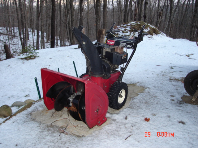

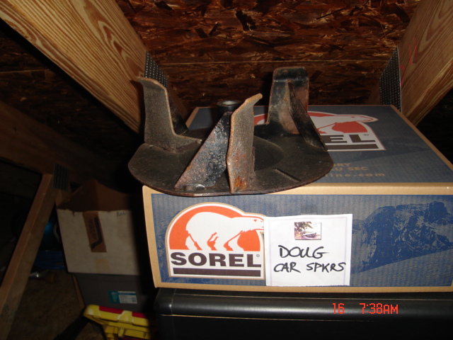

I'll go along with the impeller-to-housing clearance issue-- my ol' Toro walk-behind would have some serious throwing problems due to bent impeller blades ..rocks:eek:... While it never dropped to one foot, it would easily halve the normal 6-8 feet to 3-4 feet.
Heated & bent blades back into position twice, then went ahead & replaced impeller. The difference was due to an increase in the clearance from 1/4" or less to 3/8" to 1/2"-- enough to seriously affect throwing distance!
Took me a while to figure out just what the problem was, but when I put 2 & 2 together it all made sense. With the clearance dropped back to normal, machine acted like it was new again!
Too bad it didn't have bolt-on (replaceable) tips on the impeller; at one point I considered trying to make some, but that may be a bit beyond my talents. Still sounds like a good idea, though. :rolleyes:
