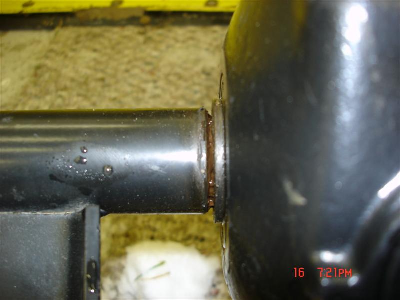

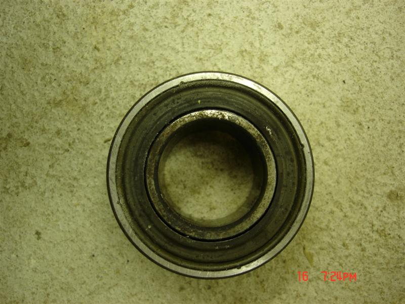

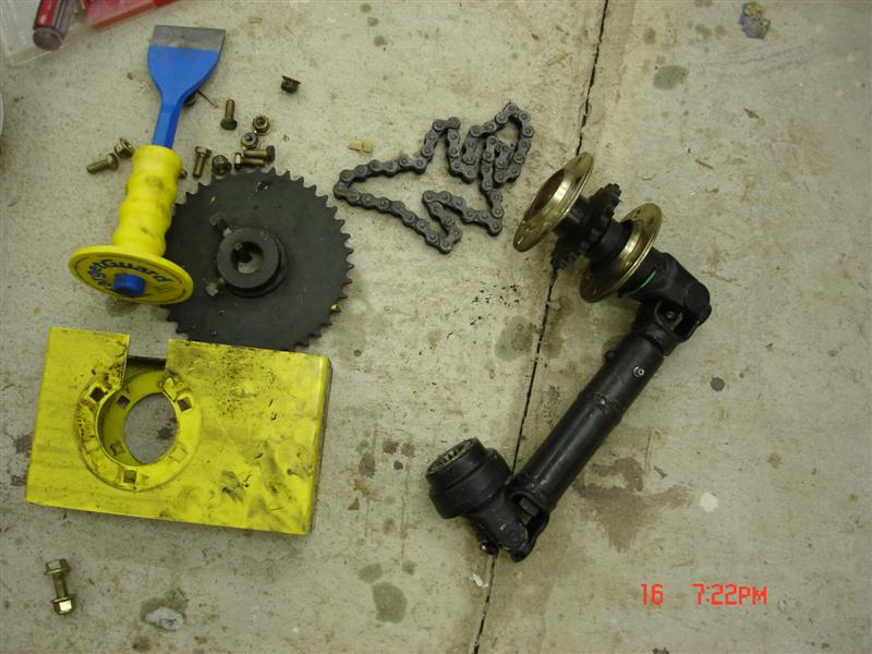

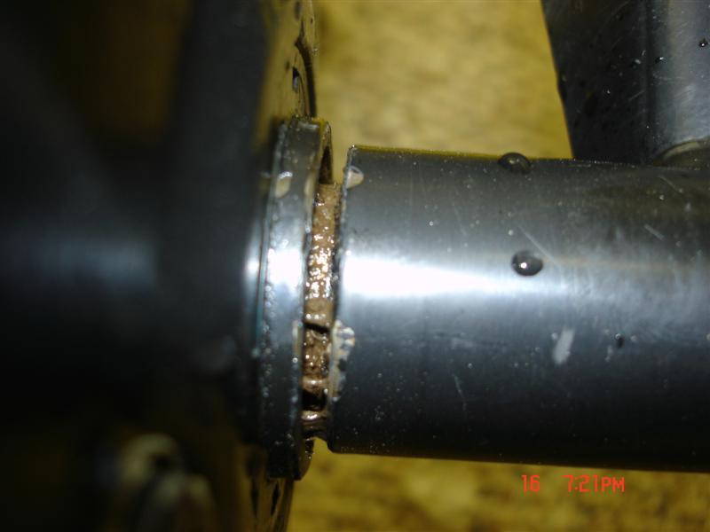

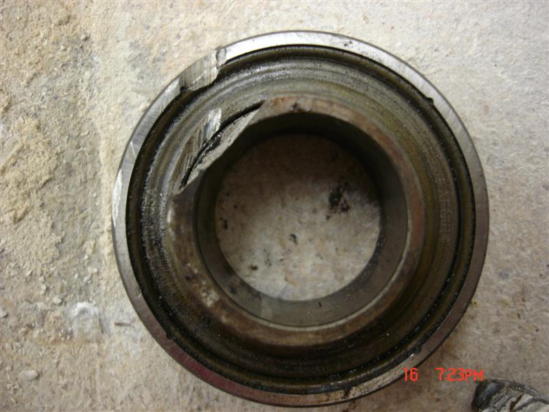

Well, I couldn't take it anymore so I tore the whole thing apart tonight. I found that the dealer didn't take apart the bearing behind the large sprocket because the ring with a set screw that holds it all in place was stuck so bad I had to grind it off. You can see in the attached pictures that the bearing is worn on one side which could either be the problem or damage from the shaking and wobble. In another picture you will see the gear box on the auger and there is a gap between the auger tubes and the gearbox. I don't know if this is supposed to be tight here so if some one would check I would appreciate the advice. Other than those 2 things I cannot find anything else that looks out of the normal. There was another guy on here that had a problem with the gearbox and since I'm too much of a chicken to mess with it I will leave it alone. I'm a computer tech by trade but a decent mechanic and woodworker. I don't usually tackle these kinds of things but I had no alternative. It ticks me off that my dealer said he did this and he didn't. I will be in his face tomorrow morning. I have a pre tear down video I should have up soon as well. Let me know what you all think.

I just got back from the dealer. I was way wrong. The bearing is designed that way to lock onto the shaft. The only other things it can be is the short shaft with the sprocket or the gear box itself. I checked out a new one on the floor and the gaps right next to the gear box are supposed to be there. I'm going to put the short shaft on a lathe and take some measurements. While I was there they started up a 2305 with a new blower. It made the same noise when lowered but only about 10% as bad a mine. I will keep you all posted.

Has anyone checked the drive line? Make sure that the crosses of the u-joints of any telescoping shafts are aligned. If they aren't, the shaft will barrel stave.
Make sure that the u-joints work smoothly and that the shaft telescopes smoothly and is short enough to telescope at all height settings. The blower may move a bit closer to the tractor when pushing into an accumulation of snow.

the bearing in the first pic is not supposed to look like that. By that i mean the gouge/grind marks. The eccentric on the end of the inner race is for the lock ring. While you have it apart slide the augers off and take the shaft out of the gearbox looking for wear in the key/keyway on the shaft. This doesn't require actual dissembly of the gearbox itself. When troubleshooting mine for noise I found this to be the problem...
   / 47 blower problem possibly solved? #8
just looked at the vid...that is the EXACT same noise mine was making before key replacement.(bear in mind mine is on a 425). Def.would check for any play in the auger. somehow lock the impeller shaft from turning and see how much you can rotate the augers, shouldnt be more than a few degrees. The reason this makes so much noise is that any driveline not in perfect alignment actually accelerates and decelerates 4 times every rotation, simulating what happens when you grasp the augers and rock them back and fourth very rapidly. Incedently the driveline for these blowers can never be perfectly aligned by design, especially when you take into account the movement of the hitch. Same reason a p/u truck uses a double cardan joint (sometimes called constant velocity joint) at the transmission, and the joint at the axle is setup to have no angle except under extreme tourque ie. leaving from a stop w/ heavy load...enough to cause spring "wrap" -the vibration does occur then but the sepeed is so low it is unnoticeable...
Making sure the driveline is setup properly(phasing, angles etc.)can reduce the noise dramatically but it will never eliminate it fully due to the design of the single pivot hitch. I'm guessing the similar 47 blower for the 300/400 series is much quieter for no other reason than the parrallel link hitch design that it uses and its ability to keep the driveline angles aligned properly.

As said earlier in the thread do to the angle of the u-joint the noise will never totaly go away on the sub compacts. But if you know someone in a machine shop that can make you the small shaft/gear an the larger gear assembly so that there isn't such a extreme run out you will cut down alot of noise. JD allows the manufacture of the gears to much tolerance of run out. They have been making this blower for aprox 15 years so they think that everything is just fine. The dealers have told JD over and over about the noise. The only why that they will do anything now is if the customer contacts JD. I mean everybody on all these threads. There is a number to customer service in your manuel or you can go on there website. They will tell you to contact your dealer but you need to tell them that you have an your still not satified. Tell them it's not a problem with the dealer you talked to people all around the country that are having the same problem. LET YOU VOICE BE HEARD THATS THE ONLY WAY TO GET THE PROBLEM FIXED.
