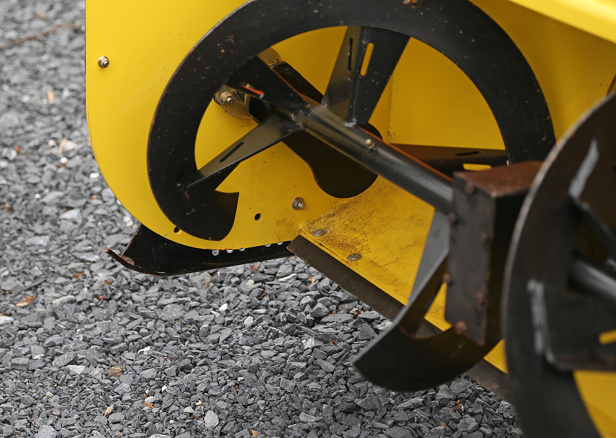

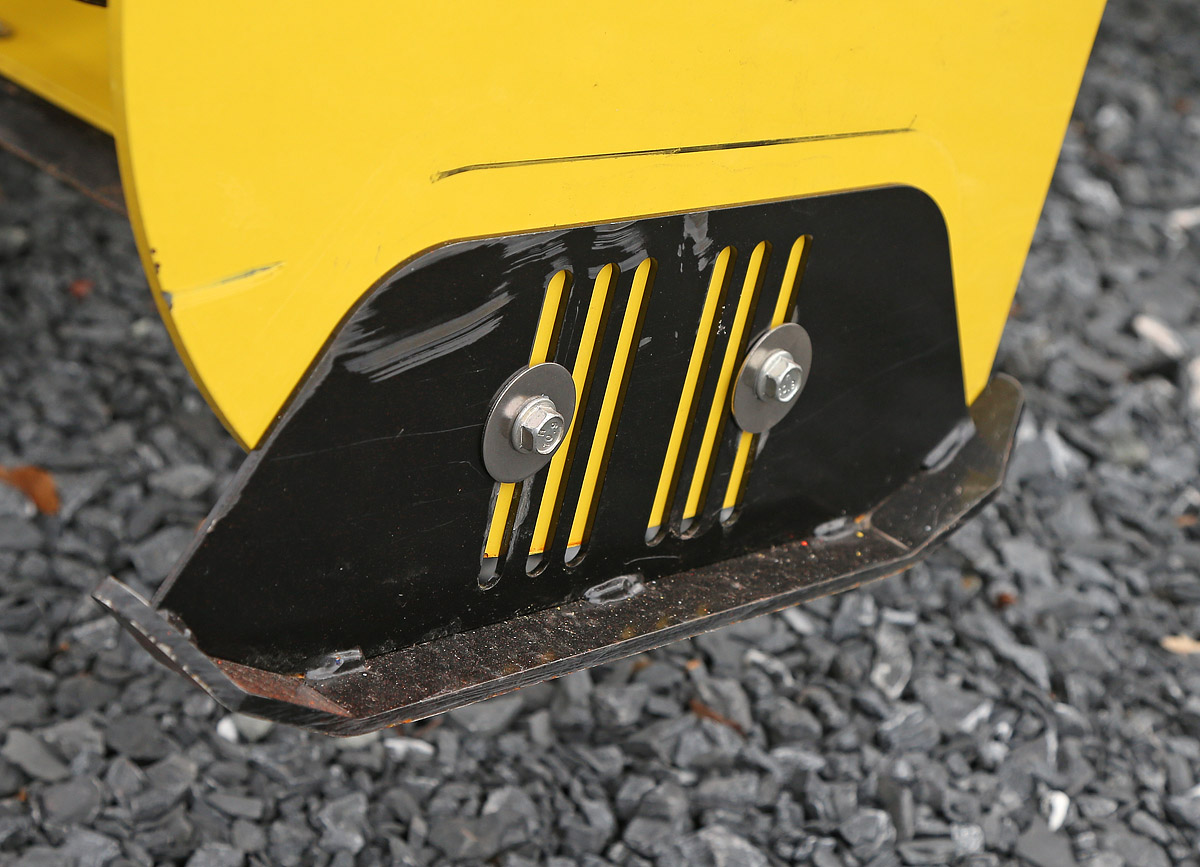

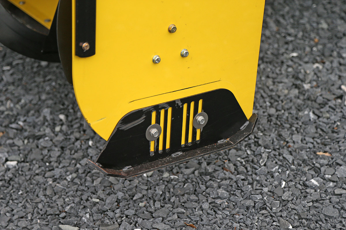

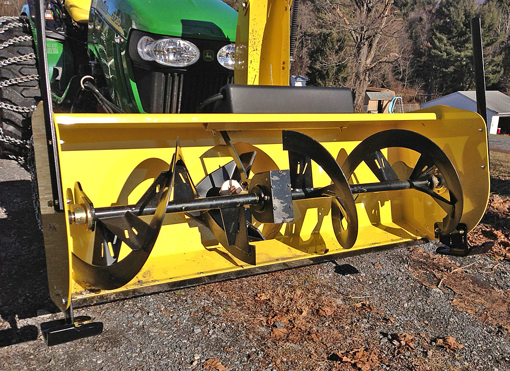

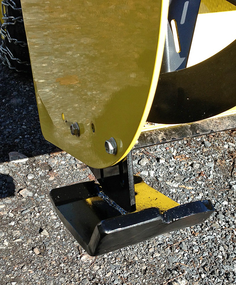

I have a 54" blower and while cleaning the neighborhood driveways I need to switch between gravel and pavement. I had the same issue with the original shoes digging into my gravel driveway. I tried enlarging the shoes but it didn't help at all.
So last season I tried a pair of larger skids from SnowBlowerSkids | Replacement parts for your snowblower
These have worked much better than the stock skids. I drew a reference mark on the side of my blower housing to mark the position of the shoes for gravel and paved driveways. I carry a set of wrenches in my toolbox and it only take a few minutes to make the change.
