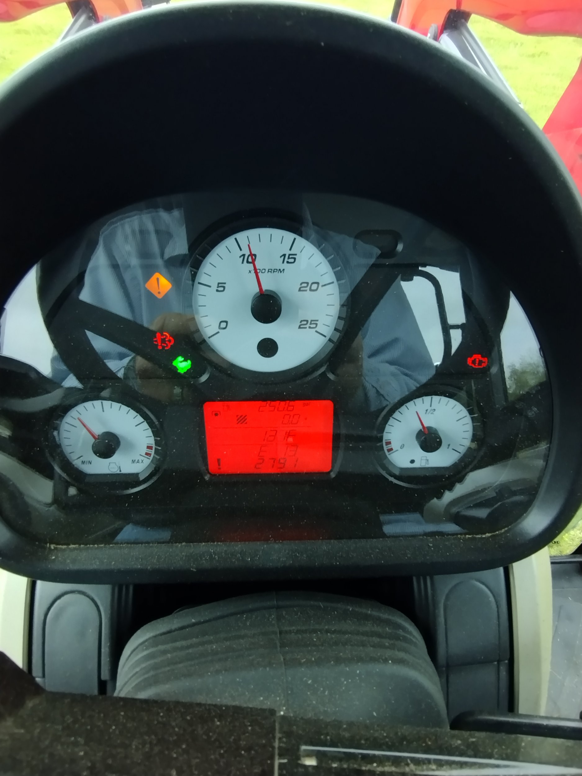

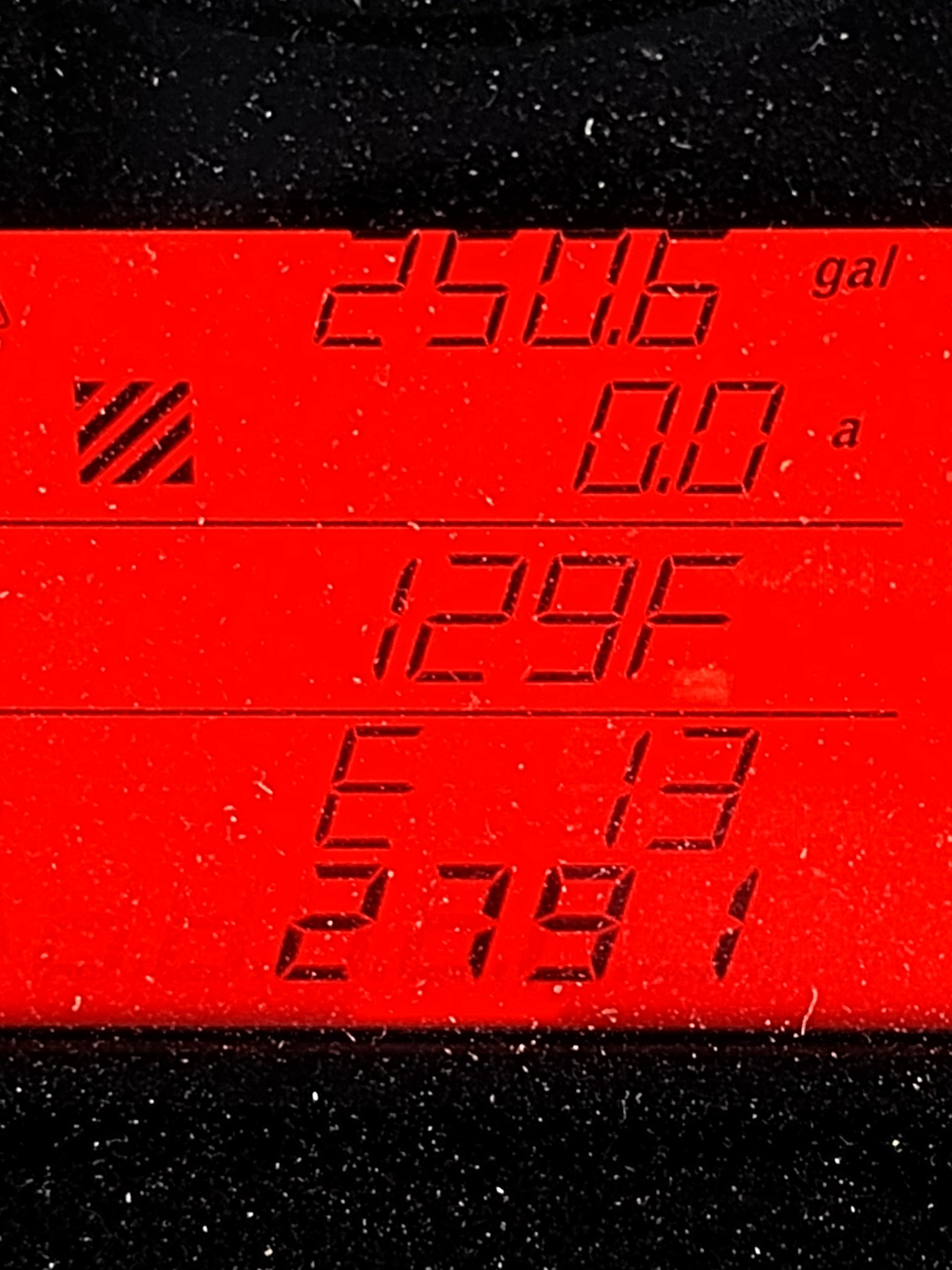

Anyone know anything about this . Tractor losing power three indicator lights came on within minutes of each other.
Dropped from 2000 to 1790 rpm
All fluid levels are in the safe range .

All fuel that is placed in the tractor is double filtered from transfer tank .
   / 4707 code E13 #3
That "blowing air" light looks similar to my "clean air filter" light. Just a thought.
   / 4707 code E13
Changed
That's a DPF light I think.
Fuel filters, it doesn't have DEF nor Regen.
Found linkage off put back on but not knowing if clocked right. Restarted the tractor E13 code and engine light went away but still has that light on that looks like exhaust blowing. Running approx 10 min at full throttle as rpms dropping

Looks like the EGR linkage. That’s probably what lit up your little exhaust light, and why it’s not running properly
   / 4707 code E13 #8
Agree - its EGR linkage. There is a bulletin or something on it. The linkage came loose and is out of adjustment. Easy fix.
   / 4707 code E13
#9
It's at dealership for the reset of egr and flash codes . Thanks
