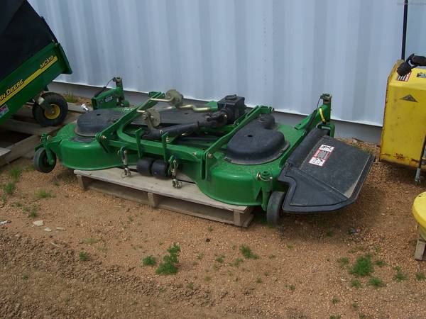

Here is a couple of pictures of a mower like mine that I found off of Craigslist. It seems like the gearbox on the 4710 mower is about 4-6 inches further back.
   / 4710 Mower Deck on a 3520 #13
The arms on your 60" are the same as I put on my 72". The biggest difference I can see is the brackets on the front and the rear of the 72" The gear box looks to be further back compared to mine. I am not sure if it would cause a pto shafts length issue. But you have the choice of the 60" shafts or 72" shaft. Nothing they cannot be overcome, but may be pricy to get a custom shaft. I am curious what you decide.
   / 4710 Mower Deck on a 3520 #14
We need a picture of a 72" deck from a 3520. Any one have one?
#15
I just talked to someone who tried to put a 4710 mower on a 4300. He said the gearbox was in the wrong place. Probably going to pass on this mower.
