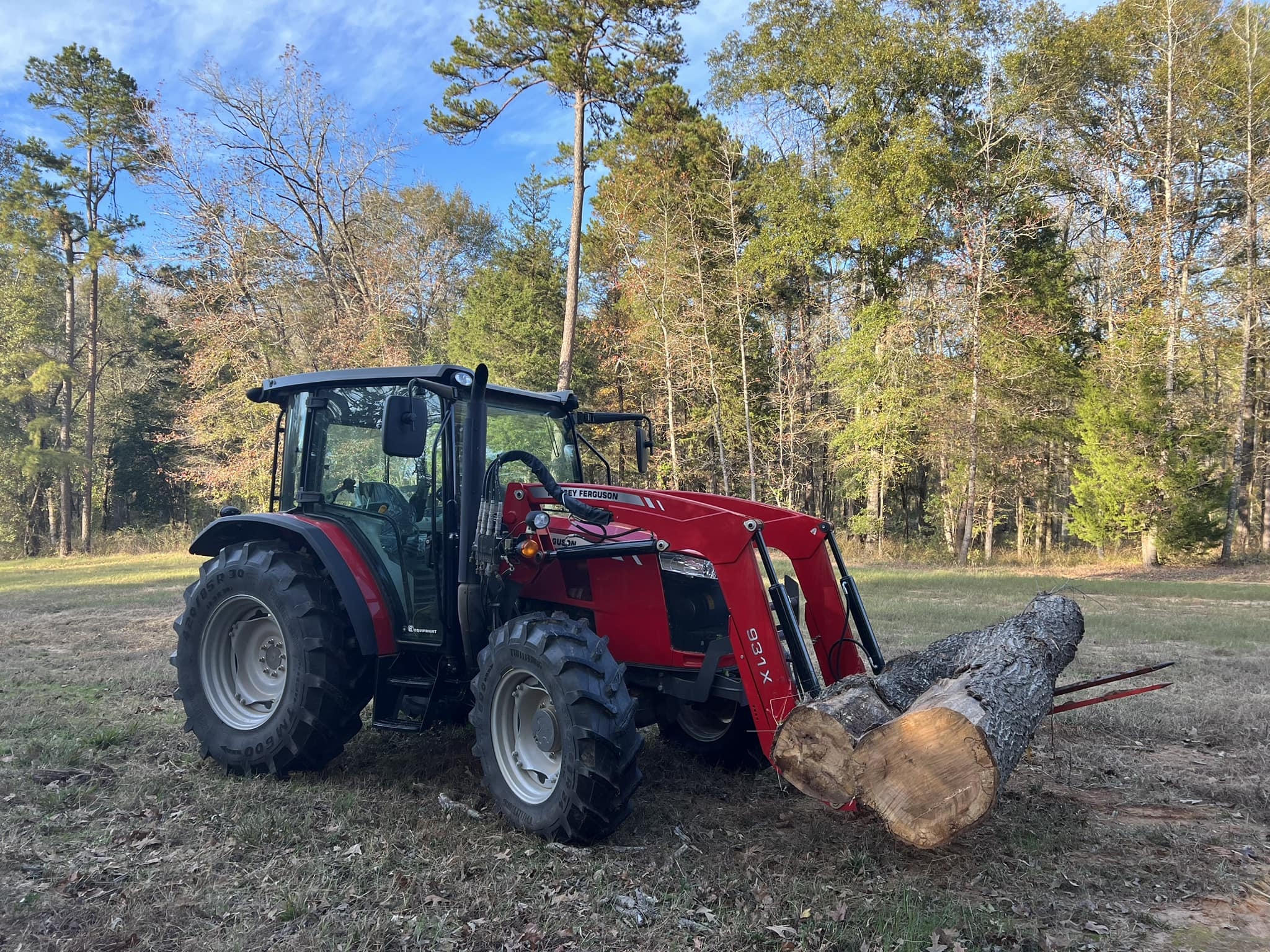

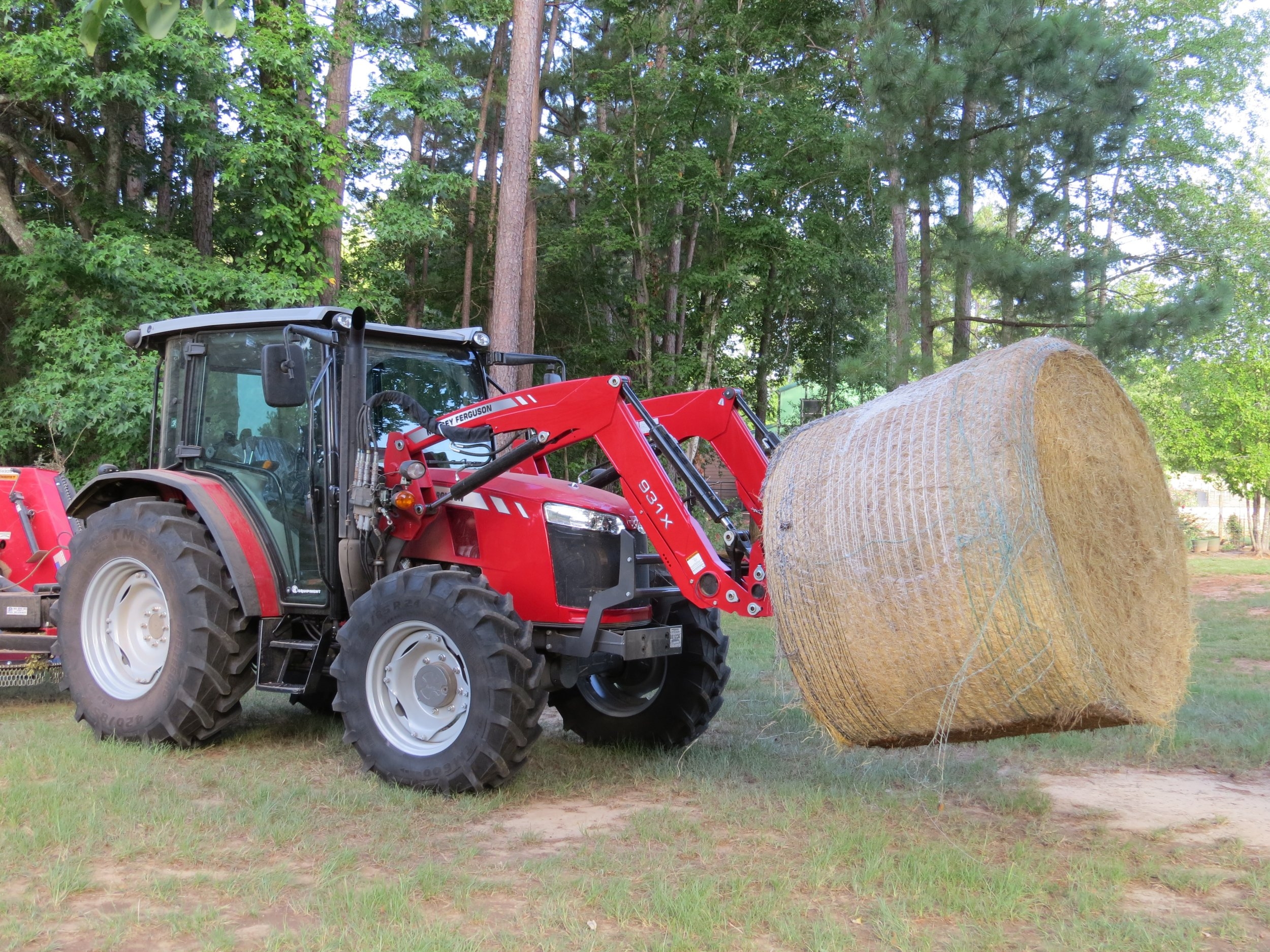

The 4700 series tractors come standard with radial tires and should not be "loaded" with anything. While my 4707 has the wheel weights, they don't come close to adding enough ballast, so I made a "do all" 3pt hitch attachment that I can quickly back up to and lift a concrete counter weight that I also made. The counter weight is about 2,600lbs and the 3pt hitch attachment adds another 200lbs.
/ 4710 Pricing #12
Absolutely no reason not to load the trellborgs, it’s just personal preference. Packing a chunk of concrete around isn’t feasible for 99% of ag applications. The only reason not to load tires, radials, is you will 1-2% of the already 13% increase in footprint over bias.
My tractor was delivered without fluid but had weights. Dealer was out of fluid. The tractor was super bouncy going down the road and on hills. Dealer got fluid in and came and got it and filled them. Greatly improved roading and feels better on hills. I did lose a little of the fold at the bottom but not much.
