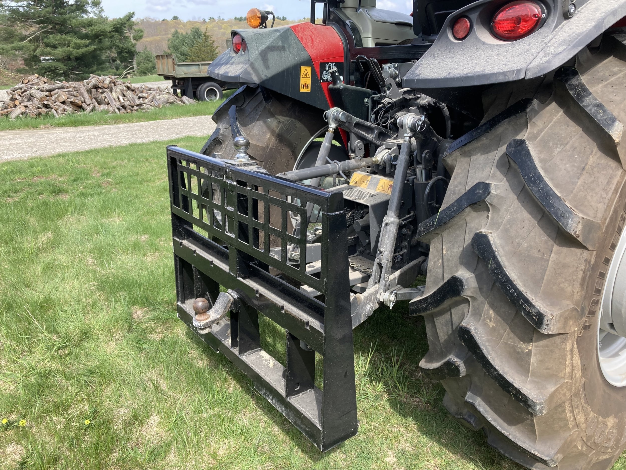

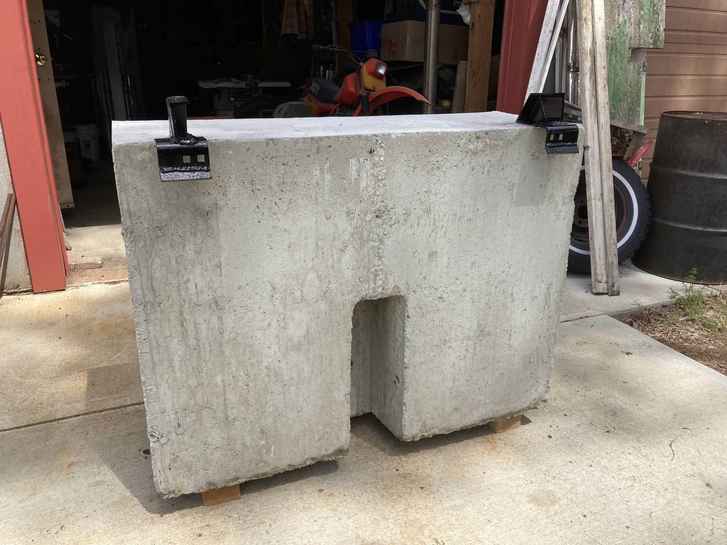

The 4700 series tractors come standard with radial tires and should not be "loaded" with anything. While my 4707 has the wheel weights, they don't come close to adding enough ballast, so I made a "do all" 3pt hitch attachment that I can quickly back up to and lift a concrete counter weight that I also made. The counter weight is about 2,600lbs and the 3pt hitch attachment adds another 200lbs.
