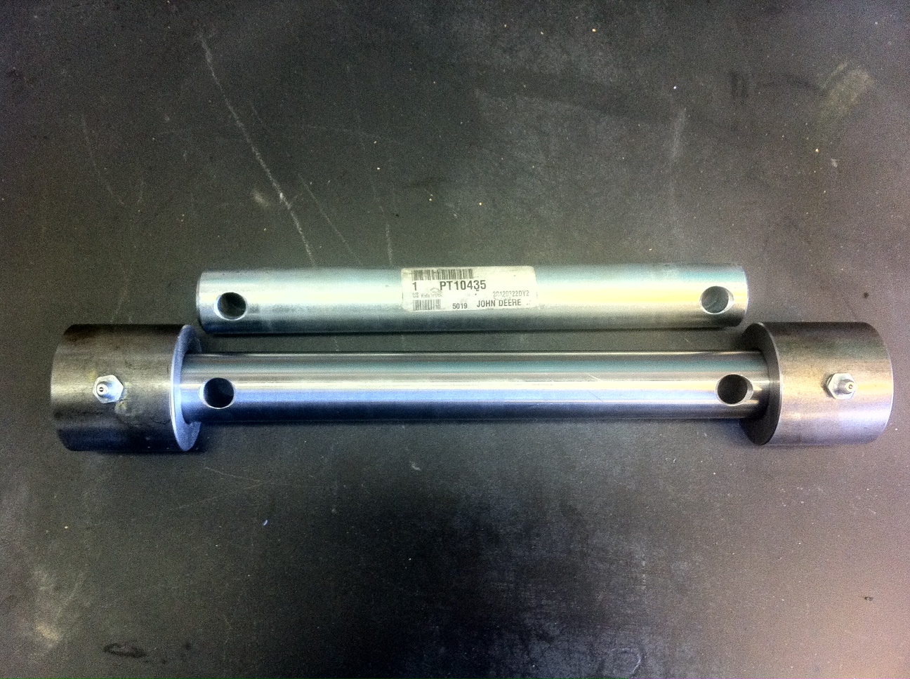

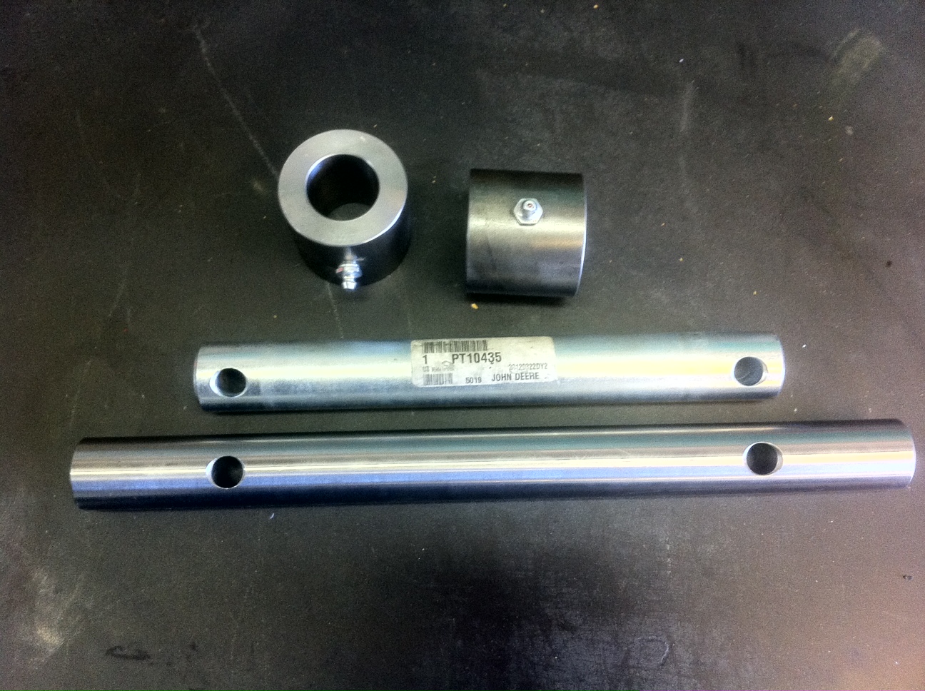

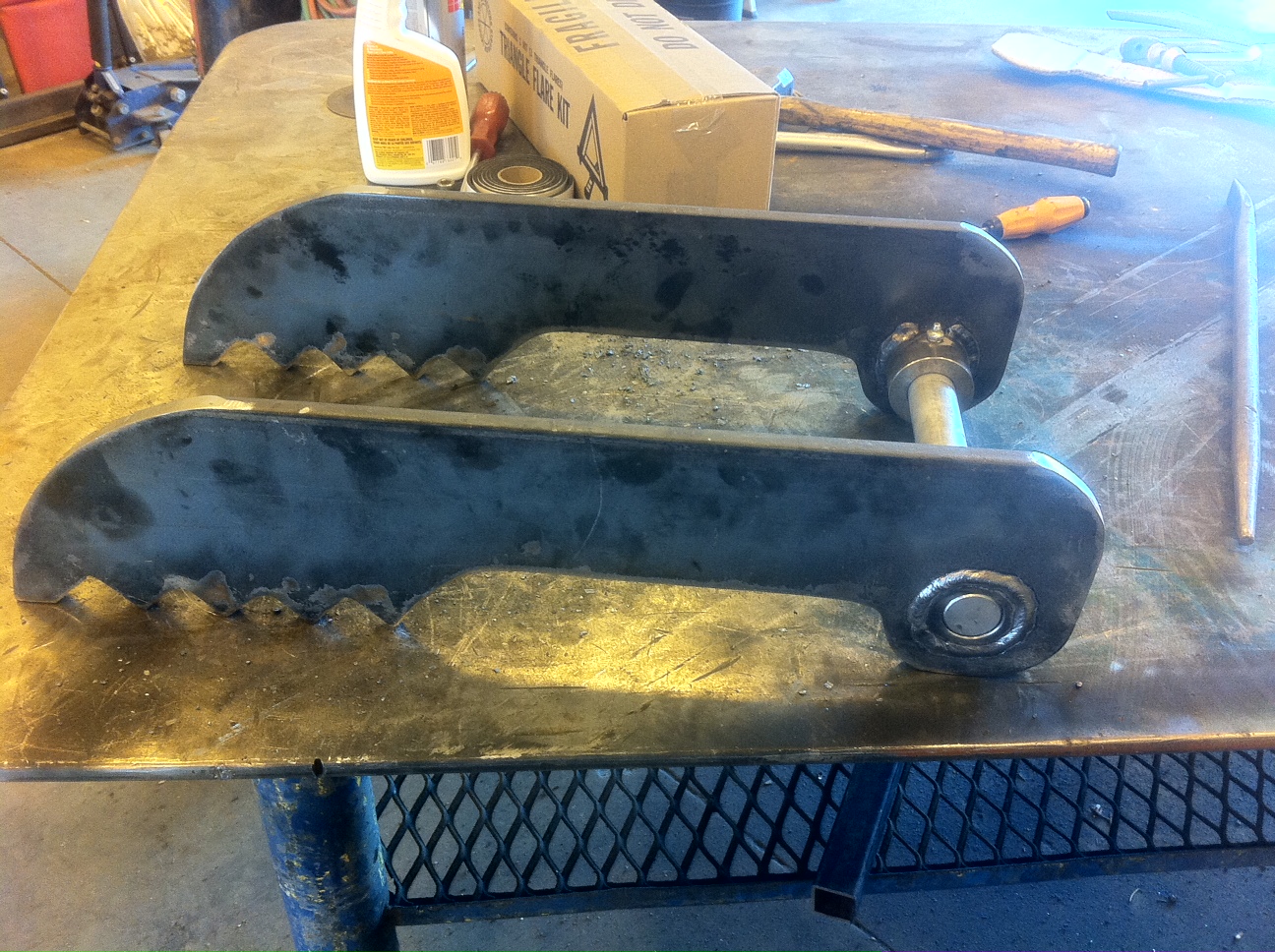

I had the creep to reposition feature but I returned it before I installed it. I ran another one with that feature and it was a bit of a pain. I found it was just easier to hop off and move the machine. You can't open the rear window when your sitting on the backhoe. It might be OK with a cabless model... You are correct on the plumbing, and mine is currently that way as well, but I am going to change it. I am going to put it all back in series as if the PB/485 is just like another valve bank. This will allow the 3 & 4/5 valves to work. They are just dumping the oil back to sump after it goes through the 485, but I am going to route the return oil back to the other valves. I did start to build a thumb today. This is what I have so far. I also ordered up a hydraulic cylinder which should be here this weekend. Pin1.JPGPin2.JPGThumb1.JPG

Are you going to put a relief valve on the thumb so it will have "give" when bearing down on it with the bucket? Just curious if that's an issue.

I will check pressures once I have the thumb installed. I may need to pull the plug on the dump side of the bucket section and pop in a relief. I'll tee in a gauge on the bucket and see what happens, as well as on the thumb cylinder.
