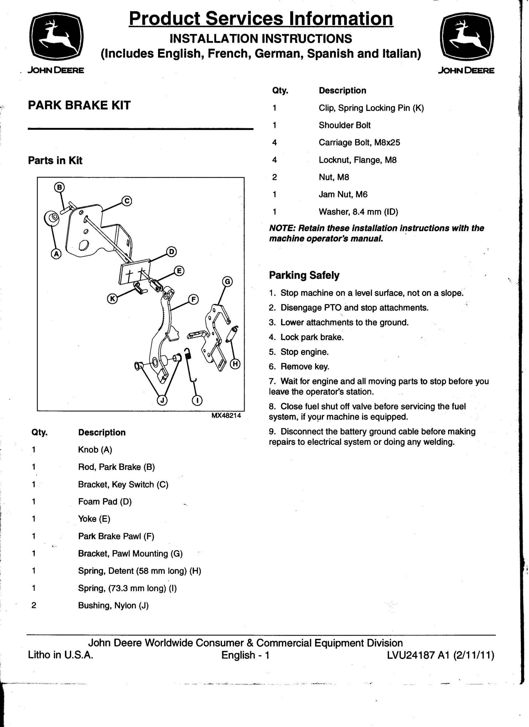

Just to add my 2 cent's. I have a 4320 cab/2006 model. This has to be 7/8 years ago at least. When the parking brake cable broke I went John Deere/ Land Pro and ordered a new cable. What came in was the upgrade kit. $42 dollars sticks in my mind. It's all a rod connection now, no more cable. Attached is the front page of the instructions. There are 7 pages total. Loader needs to taken off. My memory of this is that it was a PIA. If it was a new cable that would have been easy. I vaguely remember using my grab it, stick magnets etc. Have at it.

Thx. I found the install manual in my file. That is it LVU24187A!
Linda t. This is Part number. I did a parts look up but it did not come up. Good luck I could not find my invoice but same installation manual as OT 66 used
