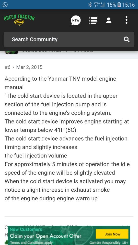

Ok guys and girls, I believe youæ±*e not understanding my issue. So letç—´ say itç—´-10c outside, tractor has been running for an hour and is at full operating temperature.. I turn it off for 2 minutes..I go to start it up and it goes to fast idle immediately..and stays there for a while.. just a pain in the *** and totally unnecessary. Thatç—´ the issue
That's a whole different situation. Something definitely hung up in the electronics. It would be interesting if a computer could read the real time sensor signals when it's doing it. I don't know if a diagnosis software exists that works that way.
   / 4720 fast idle #15
Green tractor talk has this conversation started 2/28/15. Someone on there explains where the sensor is. For the life of me I can’t get that post to copy and send it here. The posts title is 3 cylinder yanmar cold idle speed.
   / 4720 fast idle #16
I took a screen shot. I got right there after I typed in the search on Google. Screenshot_20210205-151644_Chrome.jpeg
   / 4720 fast idle #17
That is pretty clear that the fast idle is intentional.. now will birchbark try to disable that feature?
   / 4720 fast idle #18
I think his problem might be in the IP itself.
   / 4720 fast idle #19
The 4720 does not have a Yanmar engine. It has a 4024 JD engine. It has 4 individual unit pumps and not one pump for all cylinders. Probably works off of same principal though.
