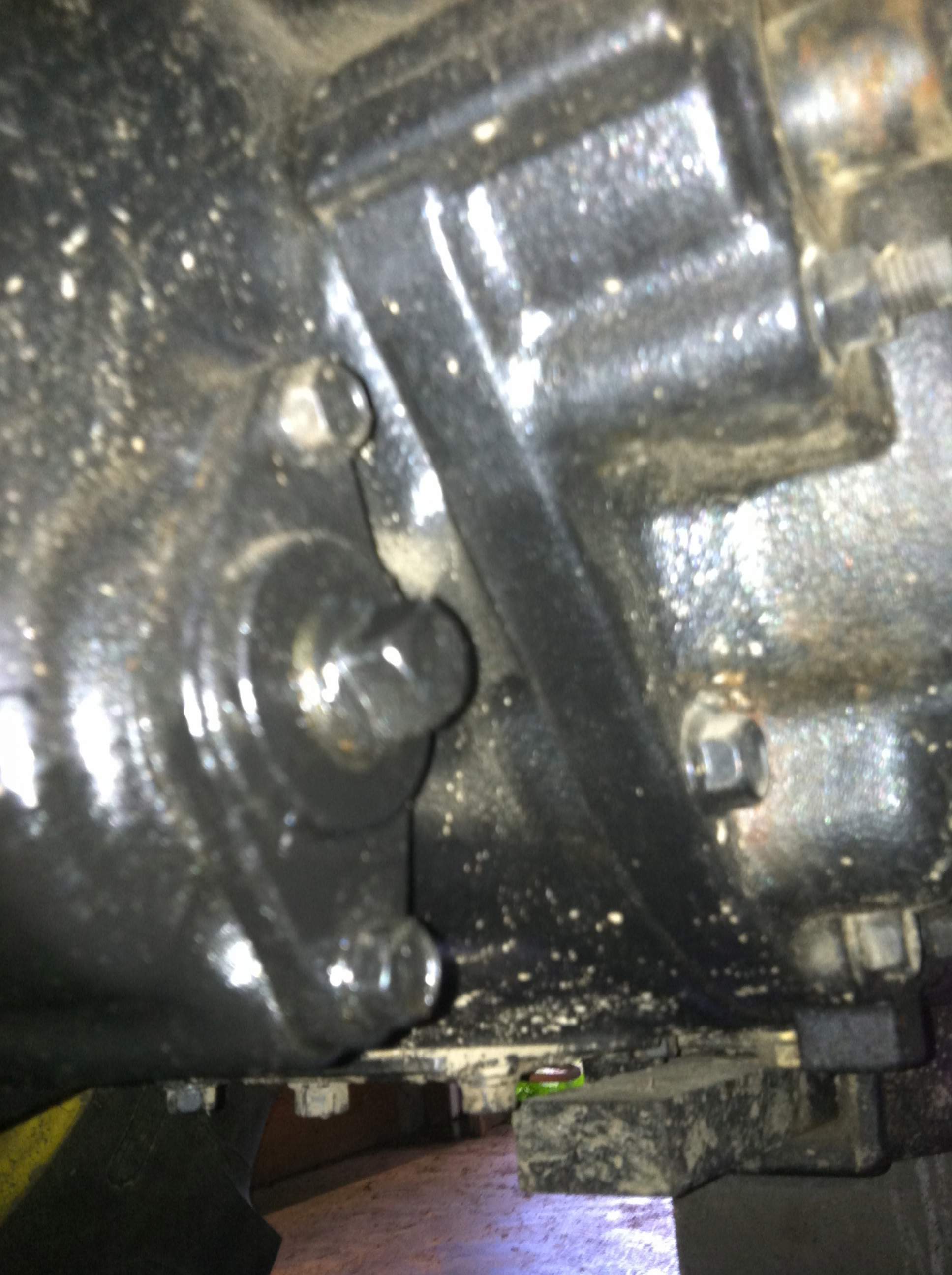

Whenever I have a heavy load on my 400X loader, raising/lowering while trying to "slip" the bucket control is difficult whenever I am handling a heavy load. Anyone have any clue? Obvious question-am I experienced? Yes.
Also, can anyone tell me what this plug is? It is rear of the trans drain plug and to the right side of the machine looking rearward.

My open station works OK, I mean it's a little sensitive, but I got used to it, and can "feather" it smoothly. I think the cab models have a cable, as opposed to the linkage that the open stations have. The cable may be a little more prone to jumpiness. Maybe you could try lubing everything up.
The plug is for the transmission heater (I think).
