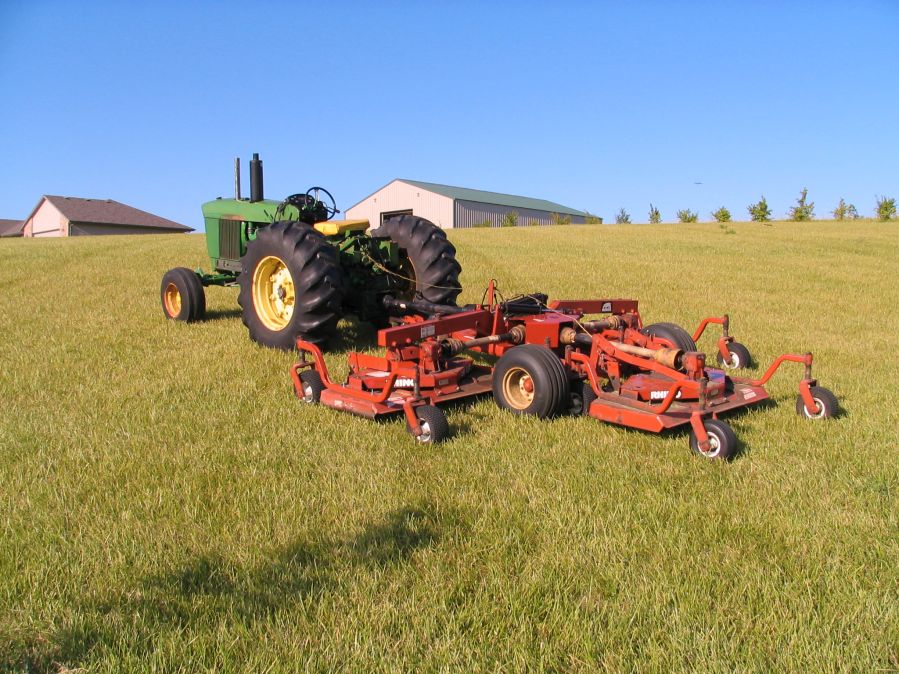

Steve, I won't be replacing the 3020. Its one of 937 diesel utility versions made. I nearly have everything overhauled as needed from front front to back. I'm hoping for paint this winter. I've been using a 13'5" flex-wing with it this summer to get the engine broke in and to check for leaks. The engine barely notices the steepest part of my hill, and with the PowerShift trans its pretty close to driving a hydro. This combination while fun, is just to big and heavy for continued mowing on my lawn. I got a good deal on the flex-wing since it needed some work so I plan to sell it next spring to help pay for the next tractor.

If the mechanicals on that tractor are in good shape I think you will be amazed how much fresh paint, new seat and some fenders would make. I also suspect you could pull that batwing without rear ballast no problem either. Nice tractor
Steve
   / 4720 vs 3720, should I upgrade? :) #18
I've been working for two years off and on getting every thing restored. It doesn't look like much yet but my stack of receipts is impressive! I'm rebuilding the seat suspension now and the fenders will be next.
It doesn't even no the batwing is back there, much better than my 1020 could muster.
