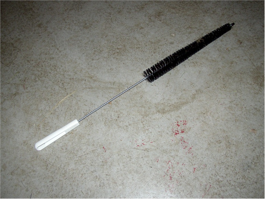

. This is frustrating in 100 degree heat! I have to blow out the intercooler, oil cooler, condenser, and the radiator out every 2-3 hours. When I blow them out, I can't be sure I'm not bending the fins with the air or nozzle because of the spacing between them.
Cleaning that every 2-3 hours would be a pain you don't need on a hot day. FWIW, I use this brush to clean the narrow slot between the oil cooler and radiator after I slide out the screen. Does not dent or otherwise harm the radiator, but does somehow grab all that bad stuff from the fins. May or may not be useful to you. It is a dryer vent Fuller Brush I bought at Lowes for about ten dollars.
