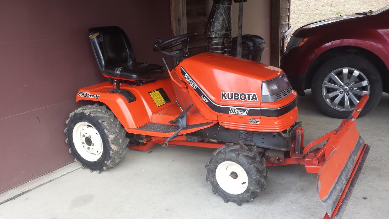

Thanks for the good responses. Ryan, you're right, the lawn sure doesn't need mowing in late November! I've just recently acquired the G1900 and have been testing it out. My issue wasn't lack of power, the tractor has power to spare; my concern was traction and the deck wheels cutting into the turf in turns and on uneven ground.
tcreely: I did try chains. They sure provided great traction, but damaged the turf. Ag tires, however, seemed to work very well for my needs. Great traction. Got the rears from my local tire store and got lucky and bought the front tires at an equipment auction for $30.
John Thomas: thanks for the advice about using the hydraulic lifters to support some of the weight of the deck. I'll give that a go next spring. I have the plow installed now and am waiting for snow!
My wife thinks I'm crazy for buying such an old machine, but I love it! Here's a pic. Kubota G1900.jpg
Jeff
