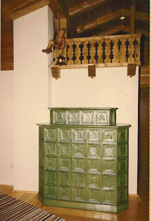

The most comfortable winters I have experienced were in Austria... radiant heat is very common and used throughout the home with many zones... walking into a bathroom with a warm tile floor and heated towel bar doesn't get any better...
Plus the ancient ceramic tile ovens called Kachelofens found in living rooms provide warm dry heat without any of the problems of drawing in outside air as the fire box is often located in a utility space or backside of a wall...
It's been over 30 years now but the year I spent working construction there provided a wealth of practical experience...
These types of ovens were found in workshops along with radiant floor heat... very pleasant in sub zero temps... plus the heat source was often multi fueled... wood, heating oil, natural gas... etc.
