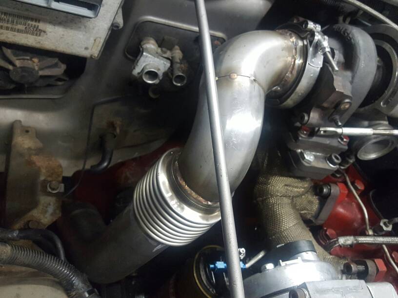

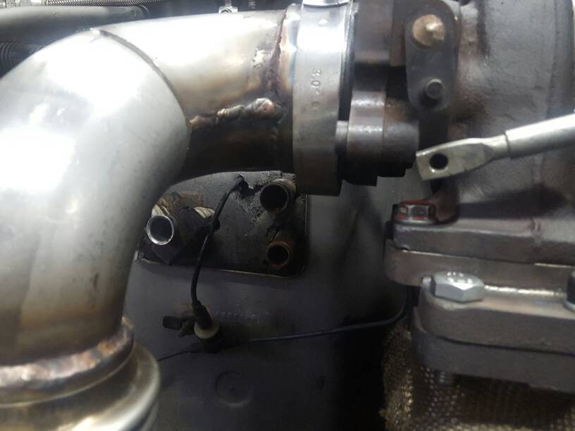

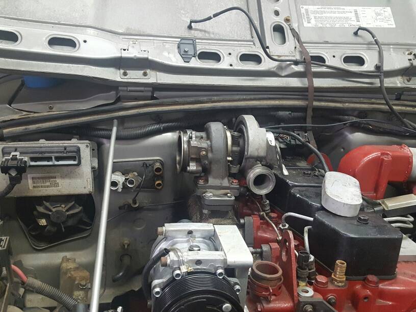

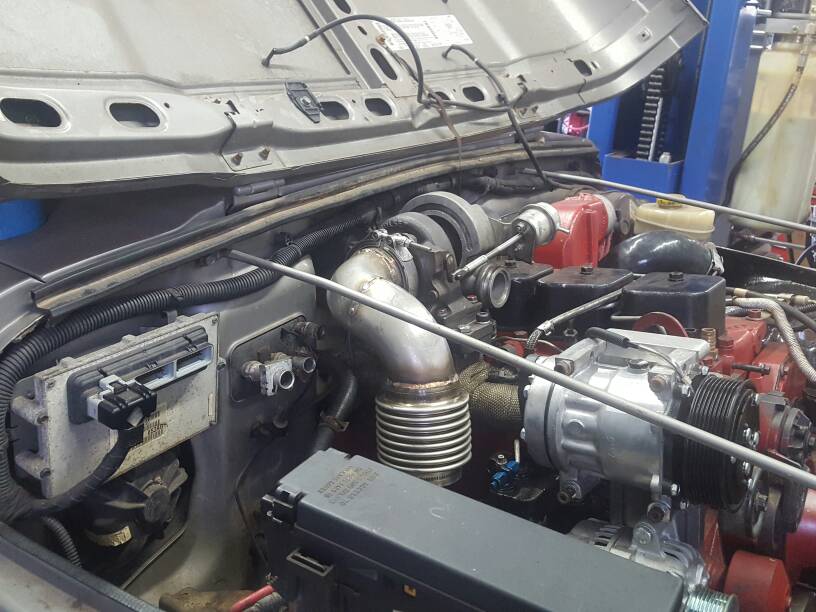

#326
Turbo placement has been a pain but might has a solution by turning the charger 90 degrees
