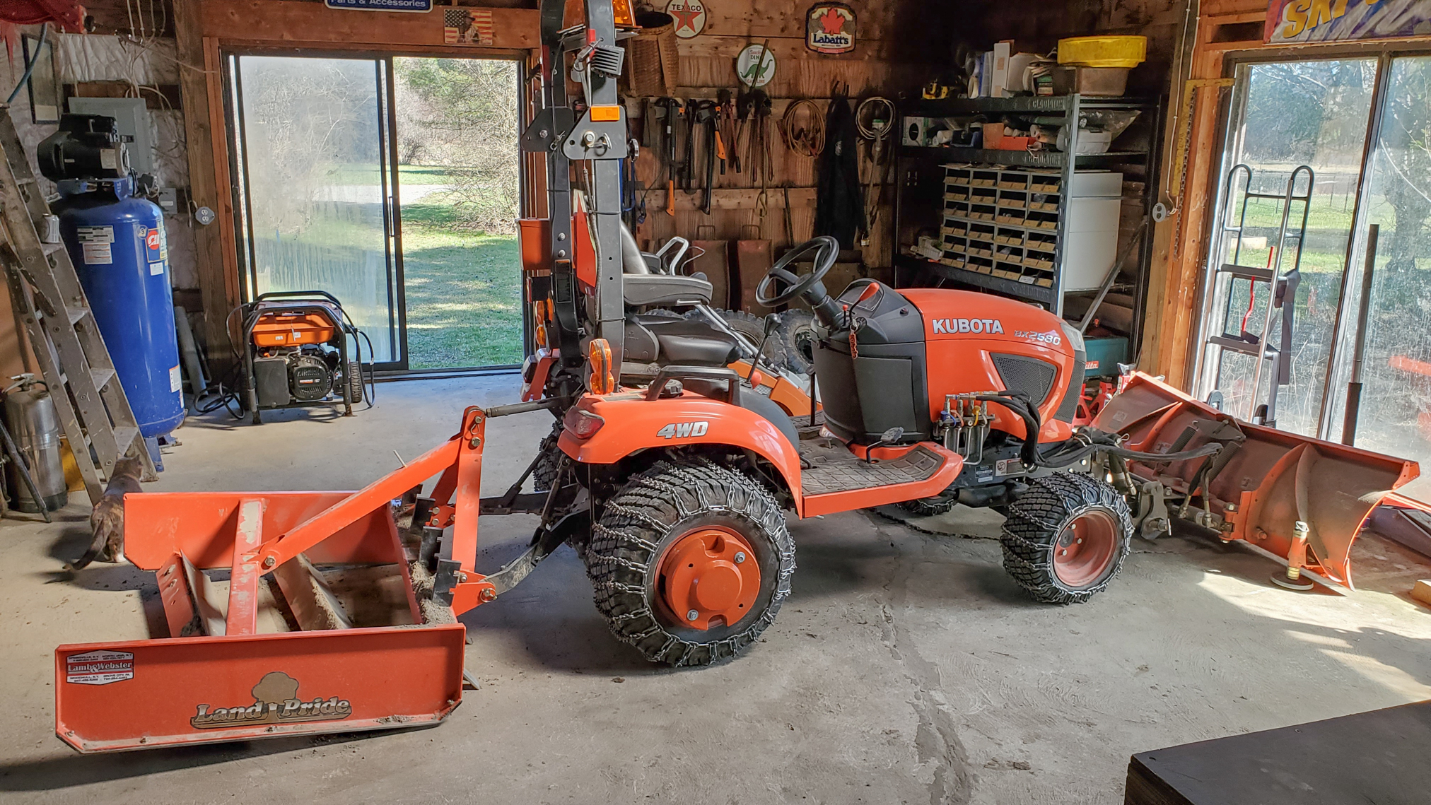

I have a BX 2680 with a 48" land plane. My advice is getting the 48". When I start digging down deeper to get the potholes out, I can feel the tractor struggle. I have the GS0548 and its plenty HD enough.
Nice looking setup! Reminds me that I need a good set of chains. My tires are filled but I wouldn’t mind having a set of wheel weights too. How do you like you plow?
I like the plow a bunch. It was one of the reasons I chose Kubota. The wheel weights are from a 1969 JD 140 garden tractor my dad bought new in 1969.
