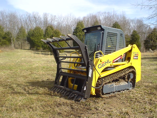

Jim,
4 in one buckets are nice for many reasons but using them as a dozer isn't one of them, in my opinion. In my hands, it can't do much more dozing than a normal bucket. The big thing a real dozer has going for it is its ability to tilt in 2 or 3 directions. That said, there are quick attach adapters that allow you to hydraulically tilt your implement from side to side, like for crowning a road.
For trash, have you considered a root grapple? I just got one from W R Long and they open wide enough to pick up about anything. See attachment.

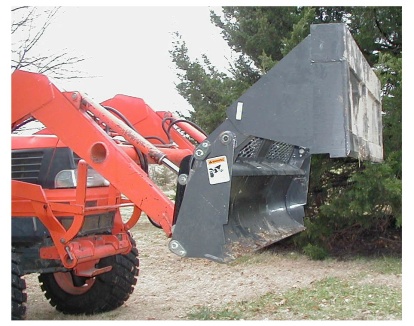

I remember this question from last year… good topics never go away /forums/images/graemlins/laugh.gif. My choice is still the 4n1. I do have both. Have not used the grapple in a long while. We had a LOT of downed trees and limbs from an unusually bad ice storm a couple mounts ago… 4n1 did everything /forums/images/graemlins/cool.gif.
As to tooth bar on a 4n1, see the attached picture, the holes on the leading edge are there for tooth bar attachment. This is a Thomas bucket and they sell the tooth bar that attaches to it. KennyV.

Hello John,
That is a great looking root grapple /forums/images/graemlins/cool.gif…

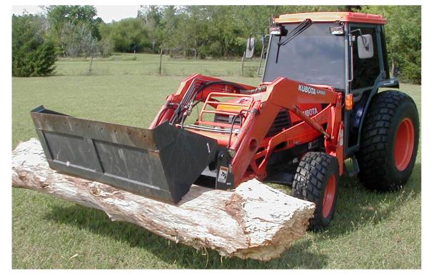

I think you are right about the angle, left/right of a true dozer blade, but for a wheel tractor this type 4n1 ‘dozer’ works ‘ok’. /forums/images/graemlins/smile.gif KennyV.
