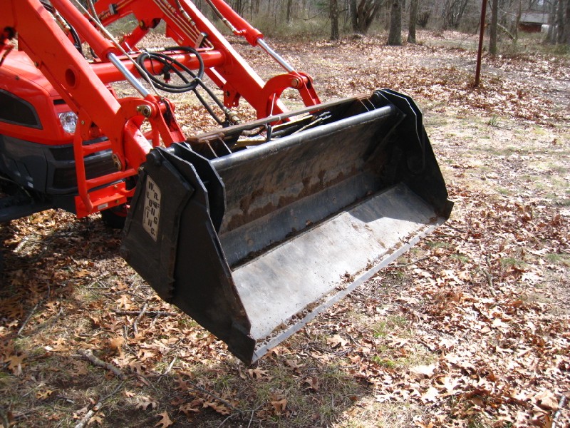

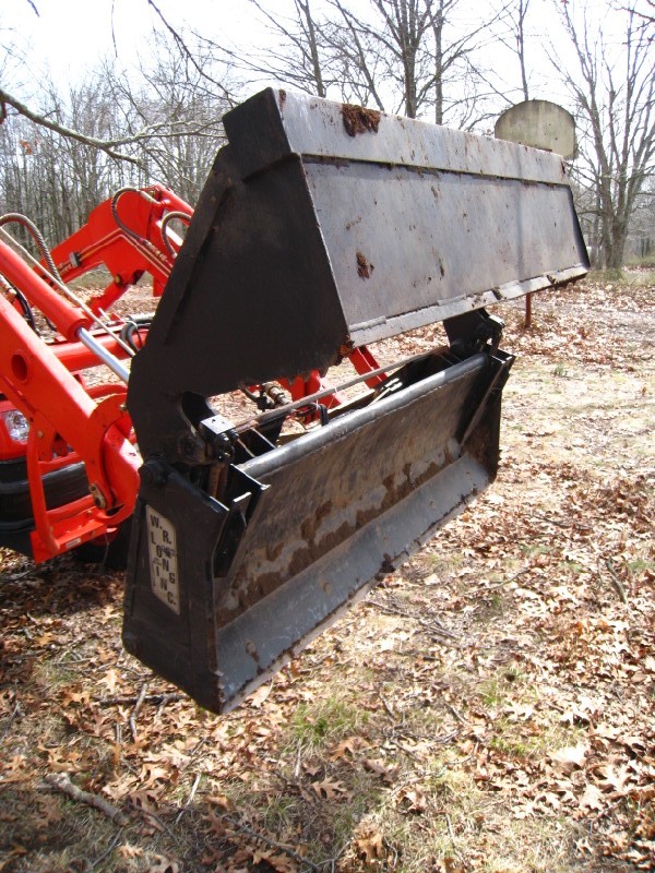

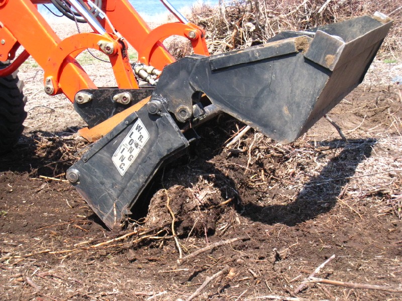

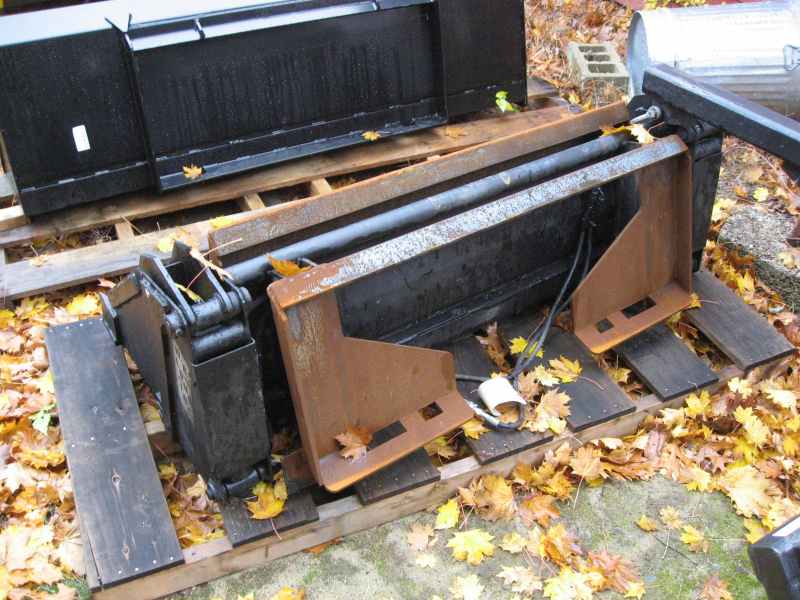

Other than shipping costs it sounds like we got twin eBay deals. I ended up having a local welding shop do the modifications for me while I watched and it didn't take much more than half an hour to cut off the JD hitch and weld on a universal QA bracket. I ended up using two end pieces and a connecting bar rather than the full QA plate and saved about 50 lbs in weight.
Good luck with your conversion.
