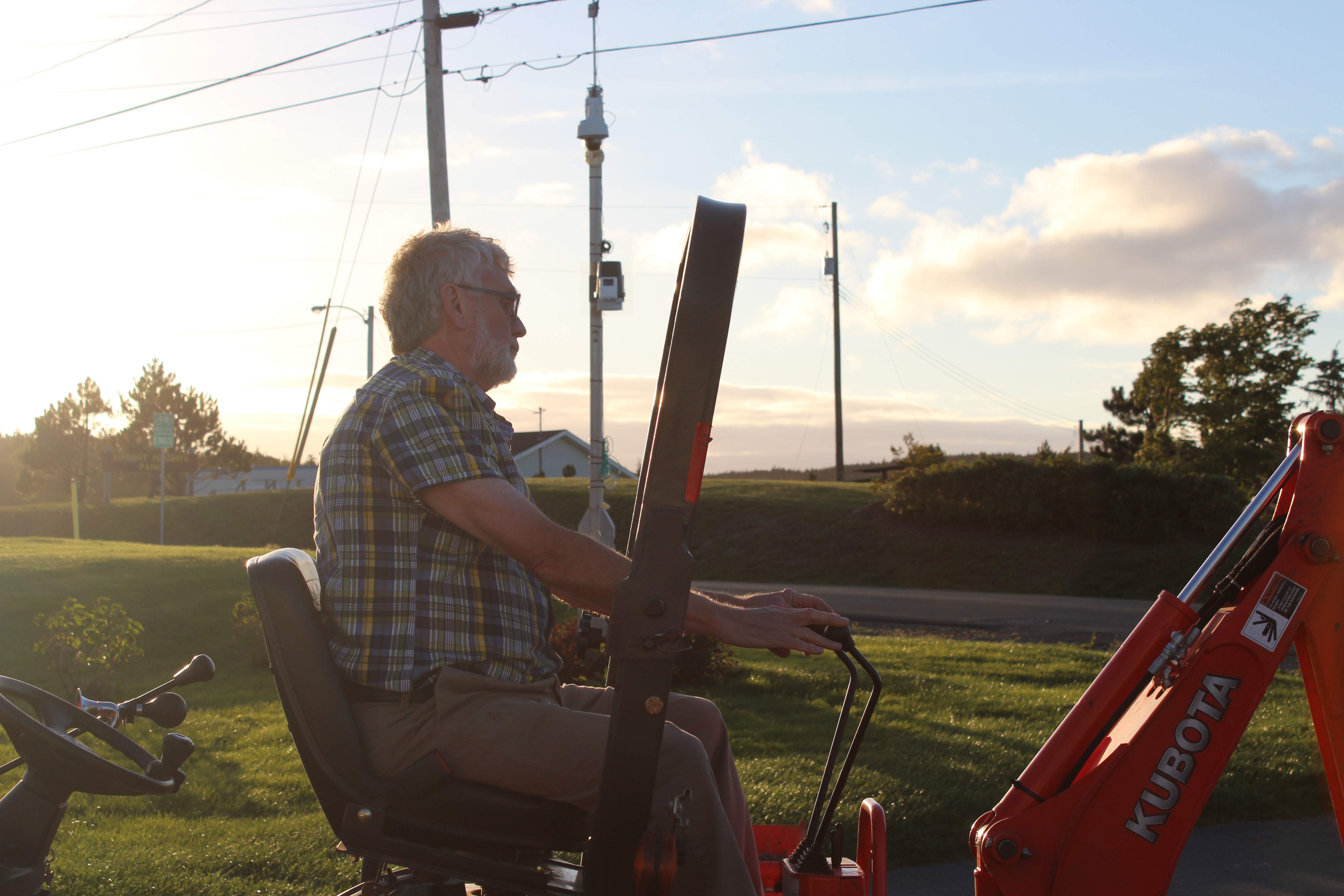

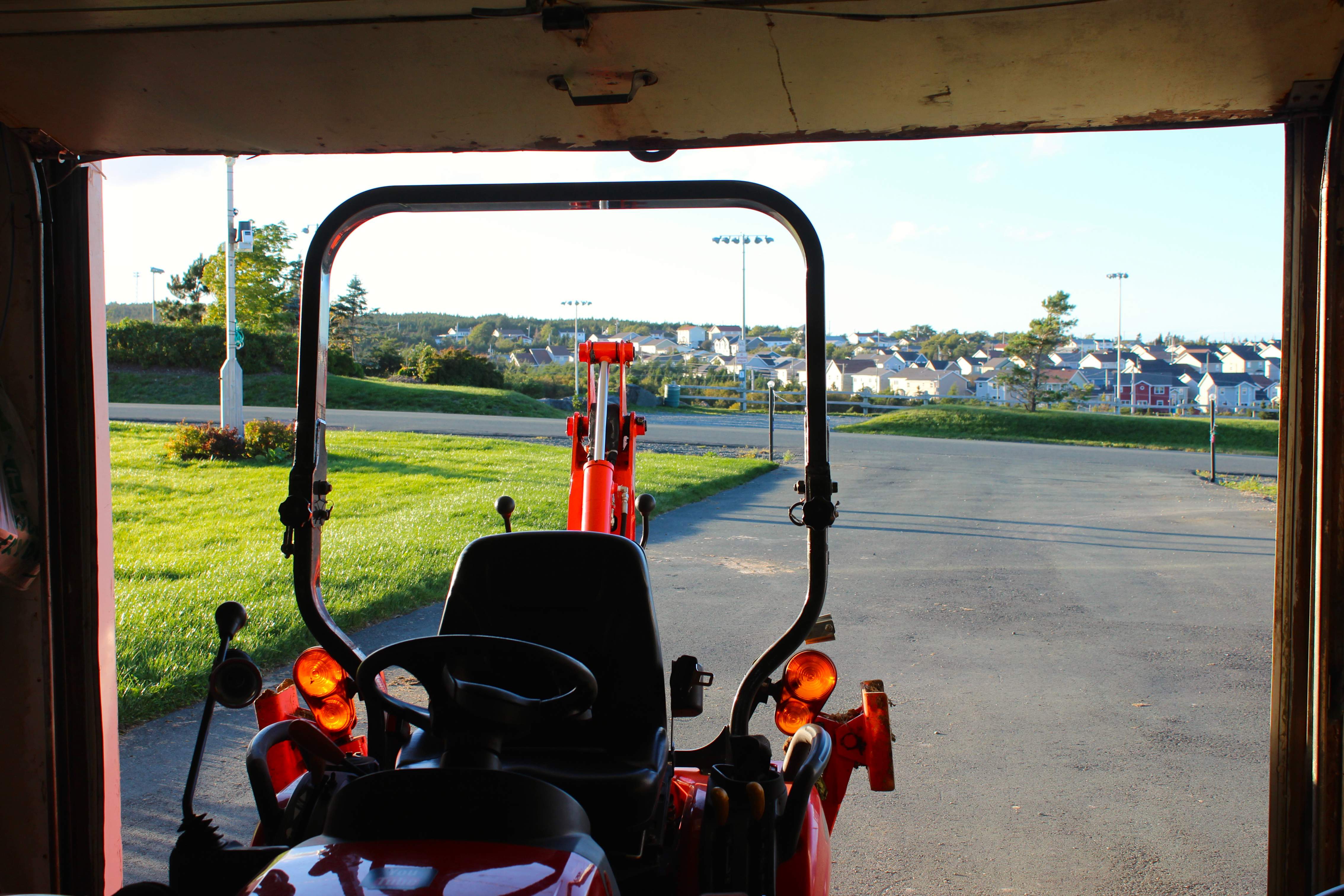

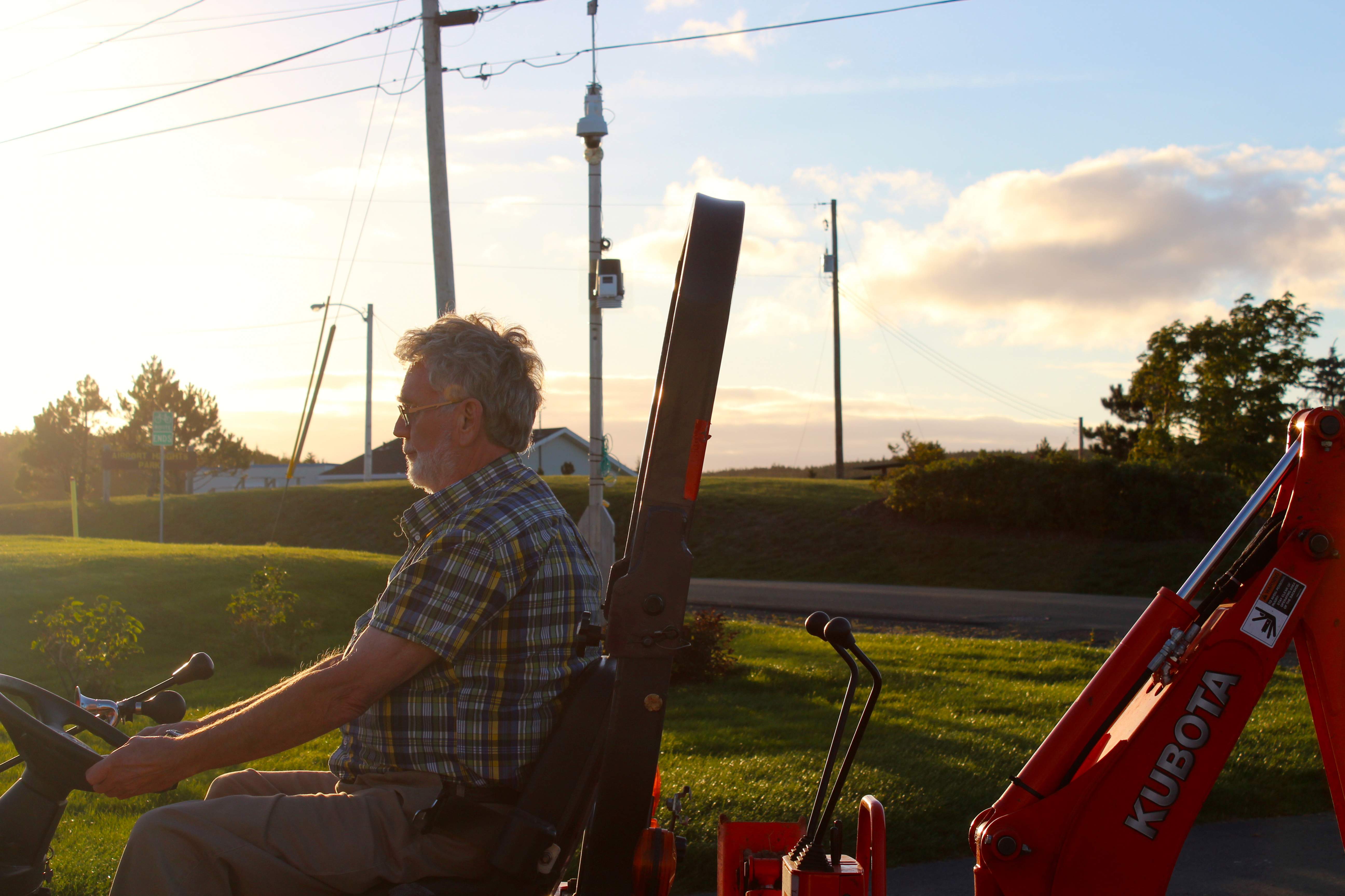

My ROPS on the BX is 1.5" too tall and I still managed to fit into the shed once with the ROPS up!
It was starting to rain and in my hurry to get it inside I forgot about the ROPS until my BX did a wheelie going under the header... talk about embarrassing!
Often thought how nice it would be to lower it 2" and never have to fold again...

I am very surprised he cut the ROPS..:eek:
I was requested to do it and I weighed in on the situation and felt the customer would be safer to have the ROPS cut and then left in the upright position than to leave it as it was and always have it folded down as he always used it before.

Another look at the ROPS and if shortened from the bottom portion, it looks like it would be just a matter of drilling some new bolt holes so no welding involved.
Good idea but in this case it couldn't have worked. The customer needed to have 9.25" removed from the ROPS. There wasn't a useable 9.25" on the lower section to cut plus I really wanted to keep the pivot points and pins in their OEM position and at their OEM height.
