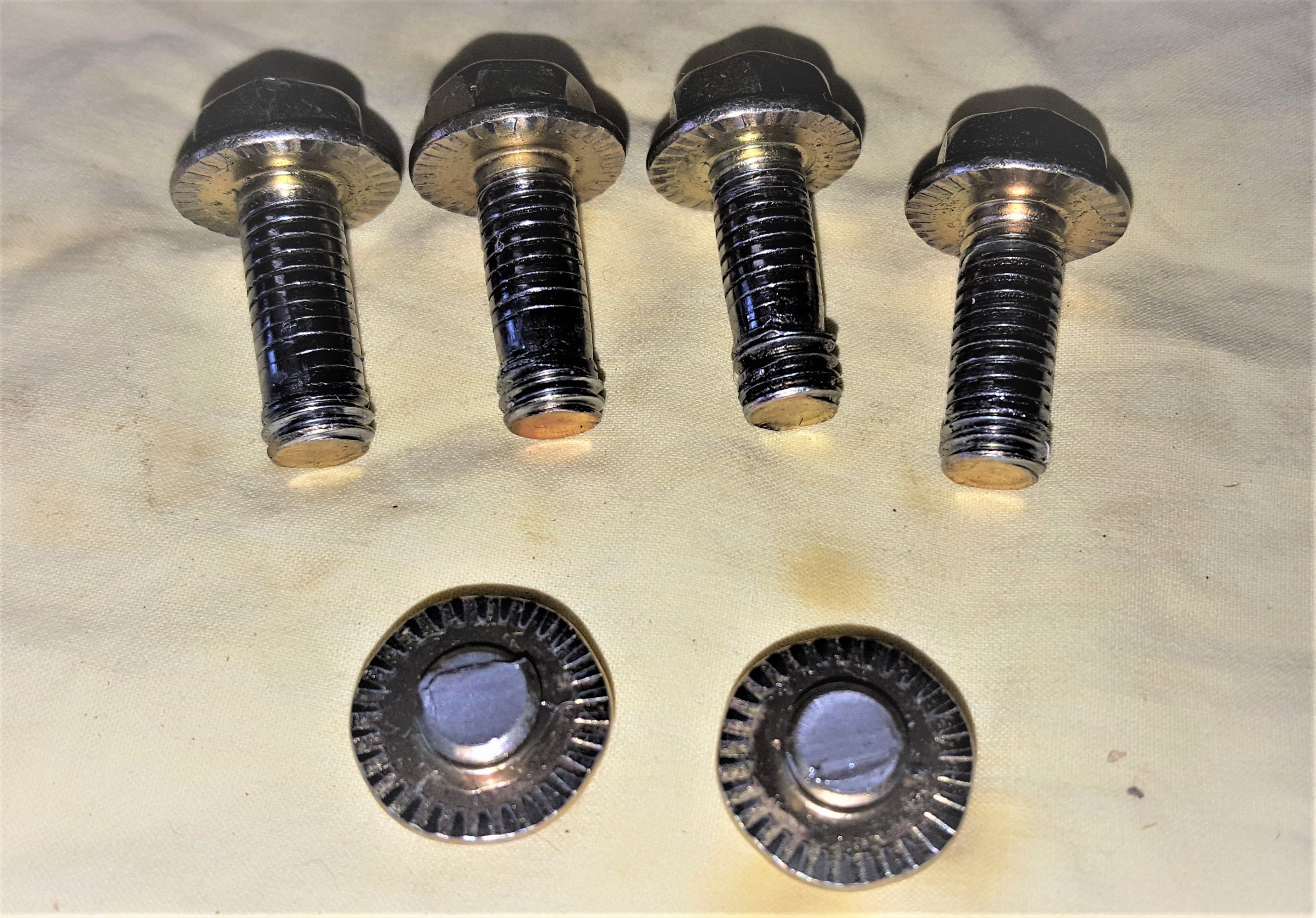

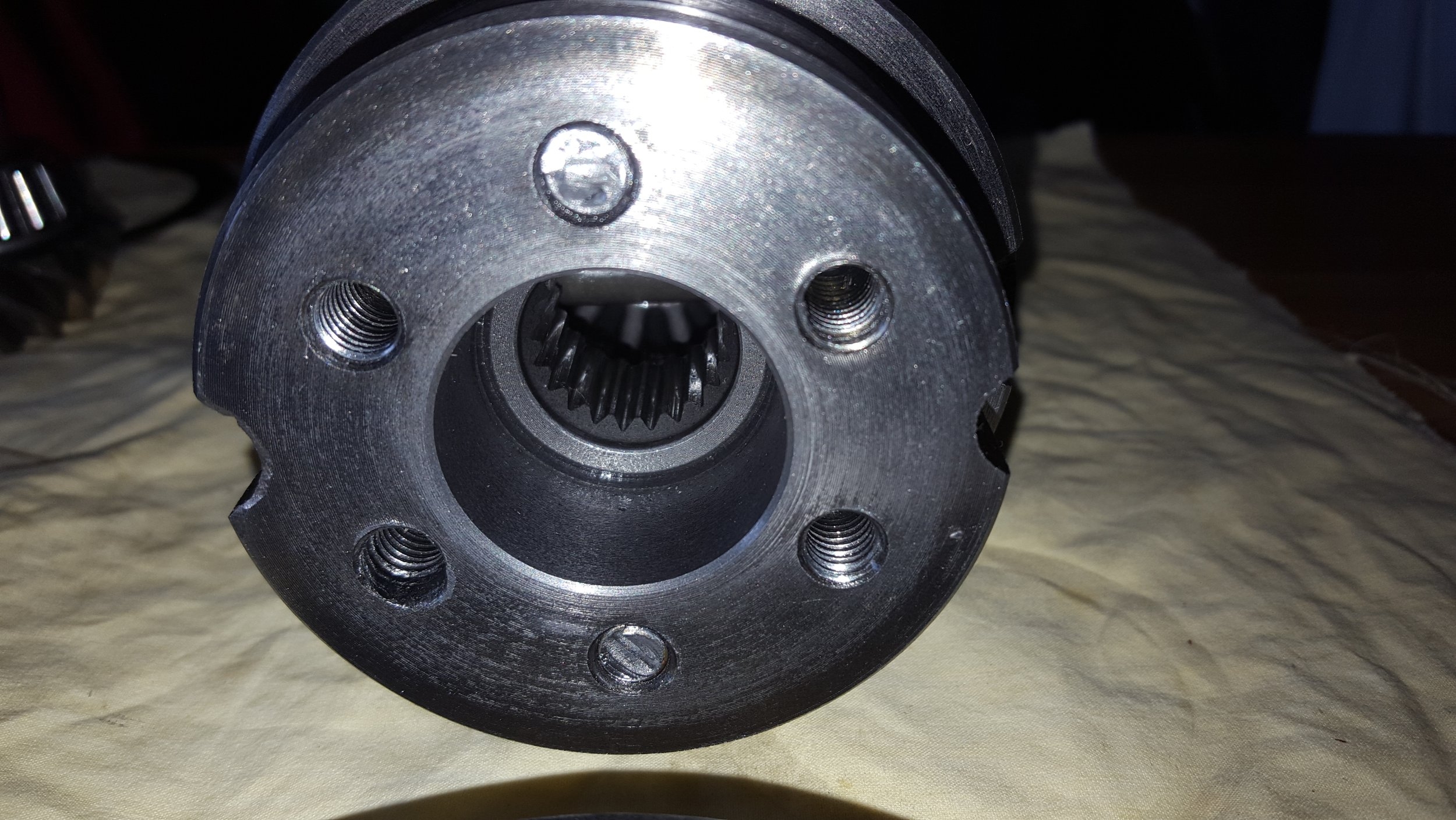

Working the loader and backhoe today and all went well for a while then I noticed the 4WD was not engaged. Shifting in and out
did not solve anything. Is there a shear pin or something that goes out on these? Is this a factory repair item? THanks! Jim in SW Arkansas

A couple things that are common to happen or may happen with these 4WD drive trains on Bransons:
1 - Roll pin on the 4WD lever that breaks or comes out so the lever will just move back and forth but not actually moving the linkage
2 - Roll pin on the spline couplers on the driveshaft from the transmission housing to the front axle can also come out, this causes the coupler to slide back and completely disengage the front 3 axle
3 - Bolts that bolt the ring gear to the diff carrier break, leaving the diff gears turning but not actually engaging the front axle. Usually only happens under really high loads on front axle while also trying to also push/pull too hard with all the weight still on the front axle.
These are the main causes we've seen on the forums over the years, but may be more. 1 and 2 are very easy to fix and only takes a roll pin worth a couple cents. 3 is a bit more complex as it requires to pull the center section on the front axle apart and then pull out the remain broken bolt that sits on the carrier.

Found the problem, the differential in the front Axle had the bolts stripped off the ring gear. Now to figure what parts are current and where to get them. If anyone of you have a hot tip, I'd appreciate it. Thanks Jim
   / 4WD does not engage, Branson 5220R #10
This happened to my 4520R about 4 years ago.
Same problem again this week. *sigh*
