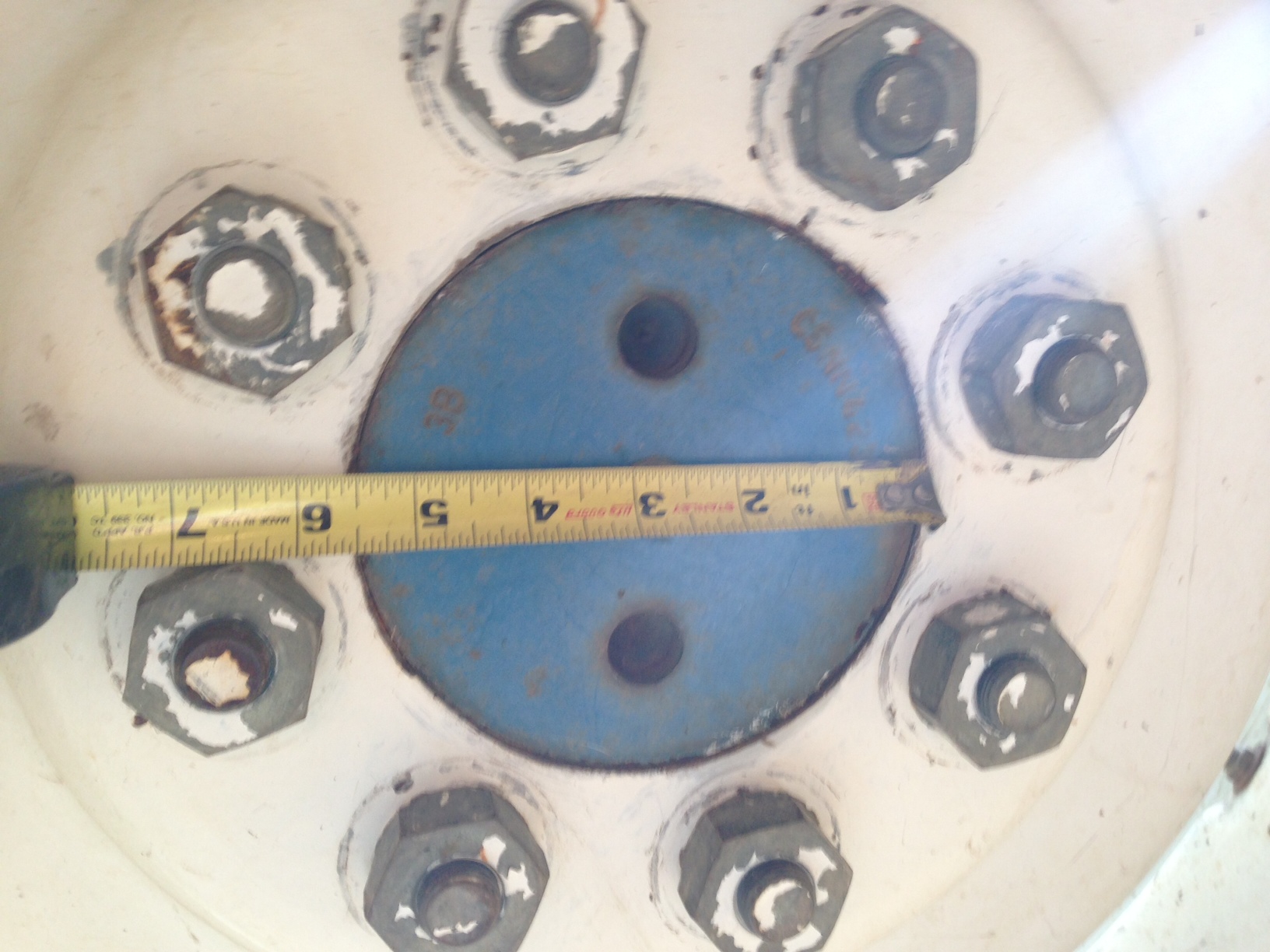

Richard, Here is a picture of my rear axle on my 3910. The axle diameter is 5.5" and the wheel fits the flange very tight.
Thanks, Bob
