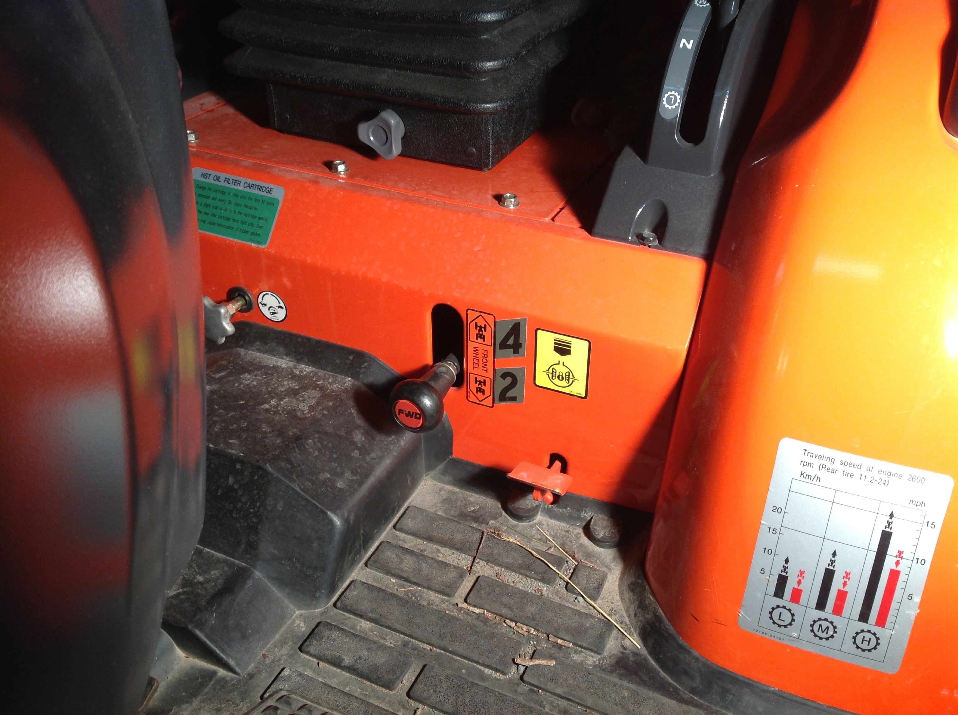

My CK35 Manual says to only shift into FWD when the tractor is stopped. My model has no FWD indicator light on dash so I stuck some mailbox numbers next to the lever so I know which wheels are engaged.

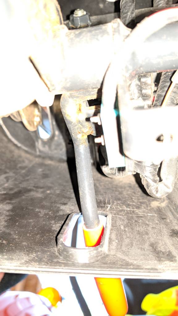

According to the decal on my tractor, my lever is the opposite of yours. 4WD is engaged when the lever is in the down position. I do like it that way, because I can be engaged 4WD with my foot.

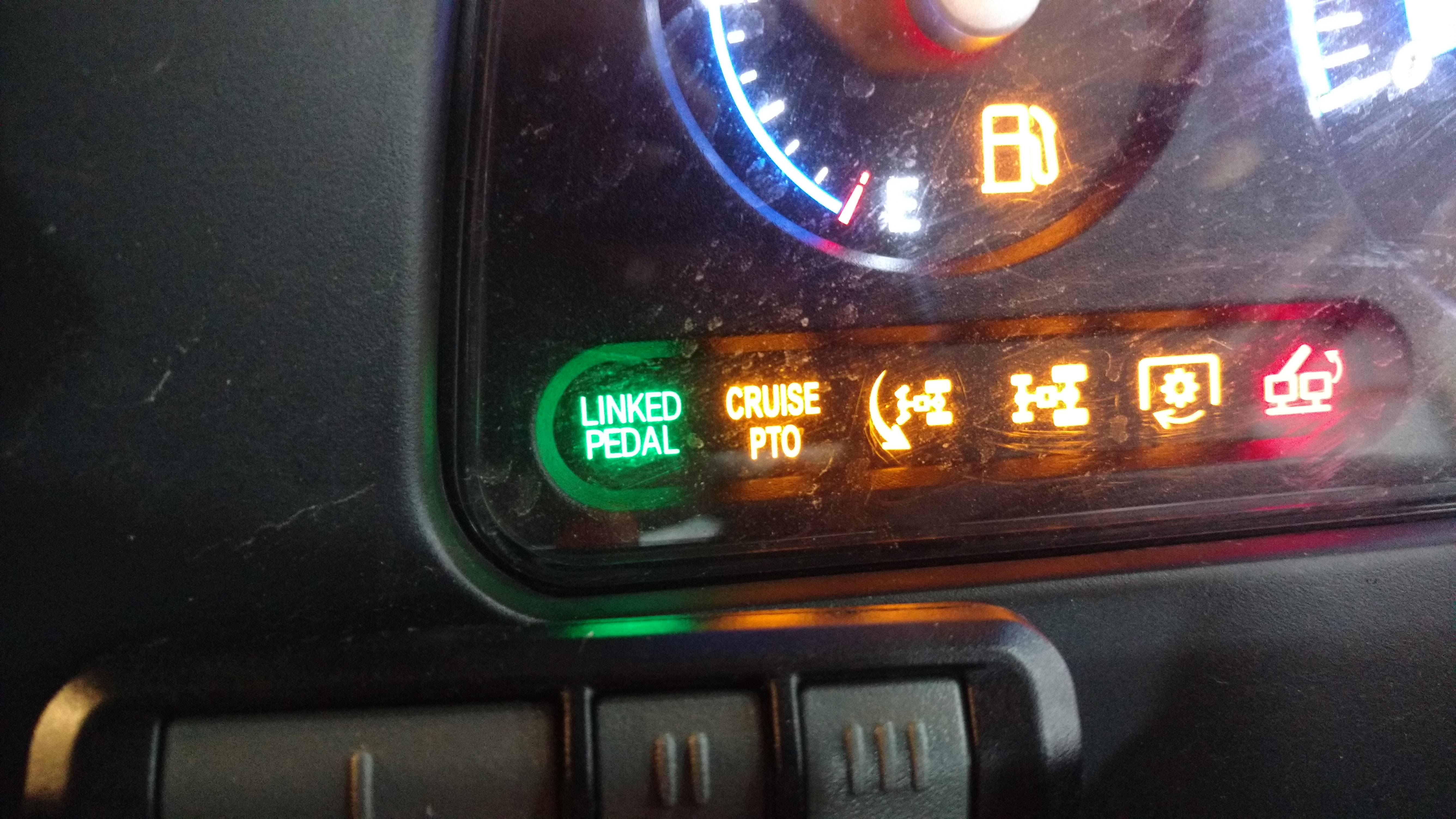

There is a 4wd indicator light on my dash. It does light when the key is turned to the on position then goes off, It does not light when 4WD is engaged.

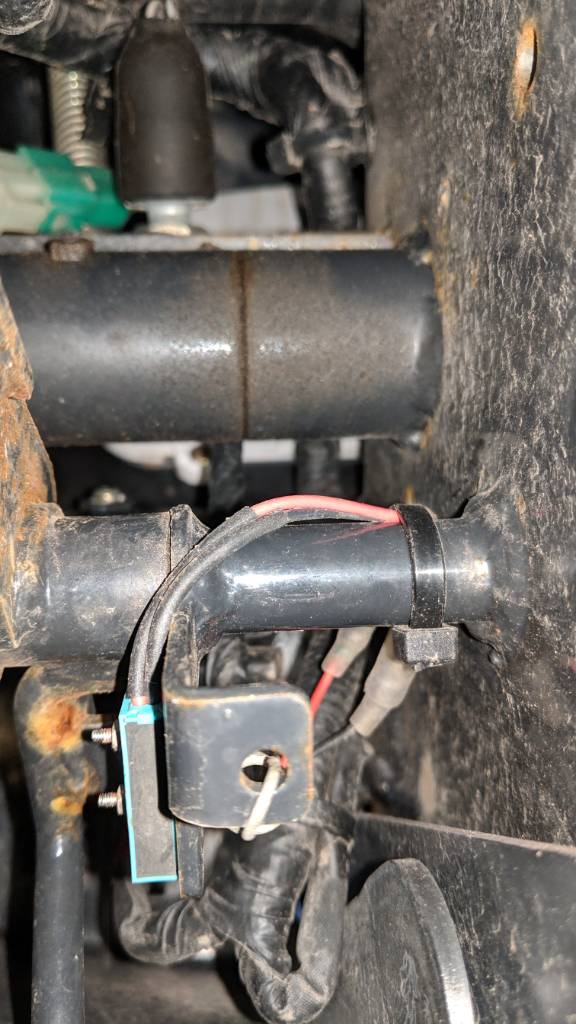

Someone mentioned a few months back that their CK park brake indicator on the dash was there but did not light up when the park brake was engaged. It sounds similar to your 4WD indicator. I have a theory. I bet the dash assembly has the function/brains built in but certain models are not wired up, maybe to reduce cost.
Does anyone have a 2 to 4 year old CK10 or DK10 series with an operational 4WD indicator? If so, what year, what model.
In a working setup there would be three items. A lever switch bolted to a bracket next to the 4WD handle, a wiring harness connector(s) close by to plug the lever switch into, and the brains in the dash assembly. If there is a connector and a welded bracket to bolt a switch to on your tractor, you may be able to add the "Option" yourself. Just order a replacement switch/connector assembly for an older machine and install it.
You certainly have me thinking since I do not see a 4WD indicator lit on my dash. I'll have to look under the seat to see if I have a connector assembly and bracket there. I am not near my tractor today.

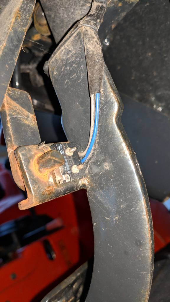

Here is a related sample. I do have a working park brake indicator on my DK and here is what the switch looks like up under the console cover. (I took this months back for the brake discussion). It simply connects to two insulated connectors. The overexposed photo shows the park brake lever. Finally, there is a photo of the lever switch for when I decouple my left and right brake pedals. These lever switch setups are all similar.

In the case of the park brake and brake de-coupling, the switch simply shorts the two contacts together to turn the light on so you can try shorting them first. I believe that should be safe.

Those #s are a great idea. Most symbols are to tiny for these old eyes to see. Half the time, I can't figure out the symbol either.
