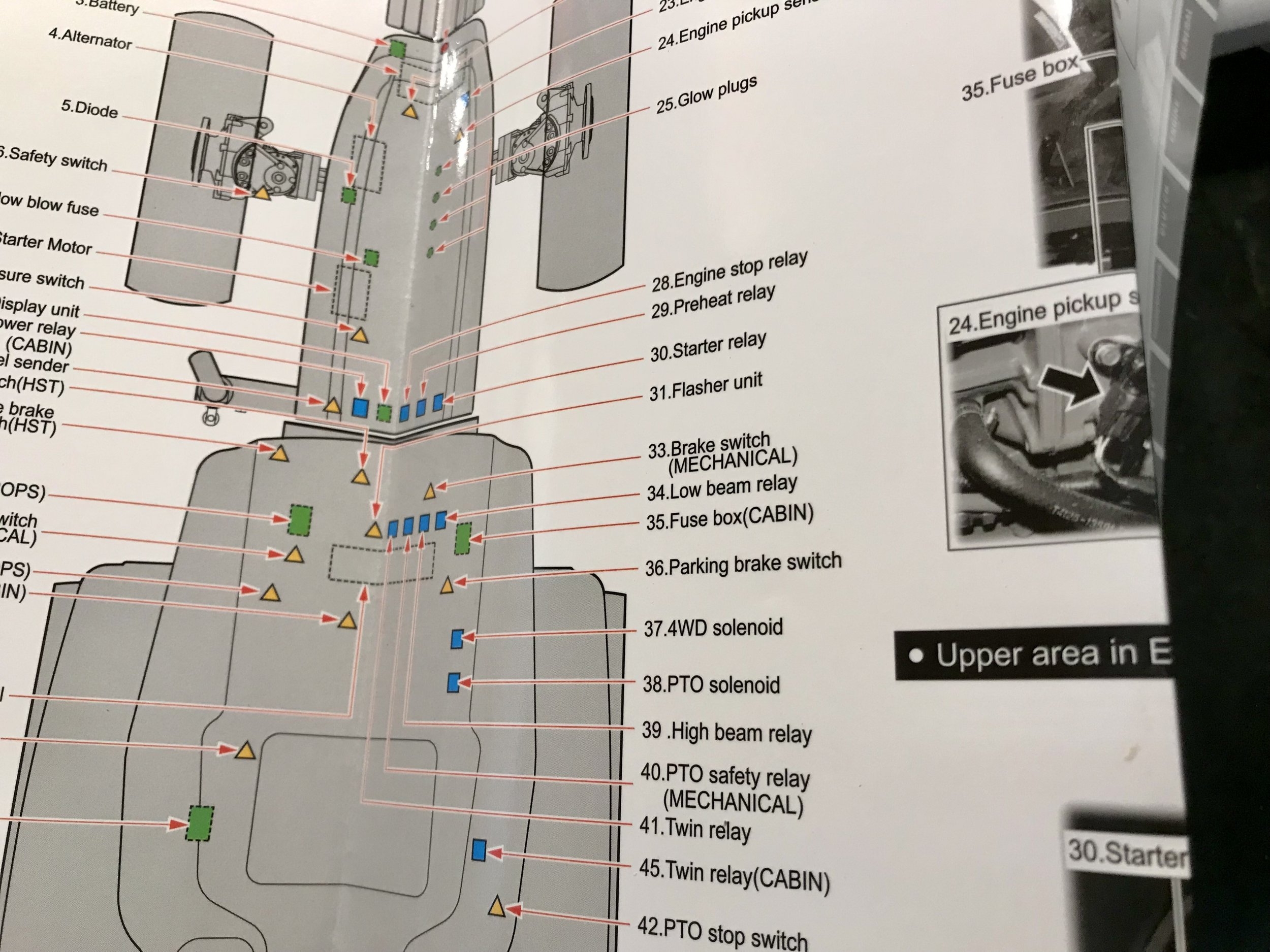

Ok, this is getting harder. So far i can only find offhand reference to 4x4 functions. Rough schematic points to 4wd solenoid as part #37. But i cant find any actual call out for it, or what it looks like. Im looking further. Also, heres the diagnostic for 4wd switch.

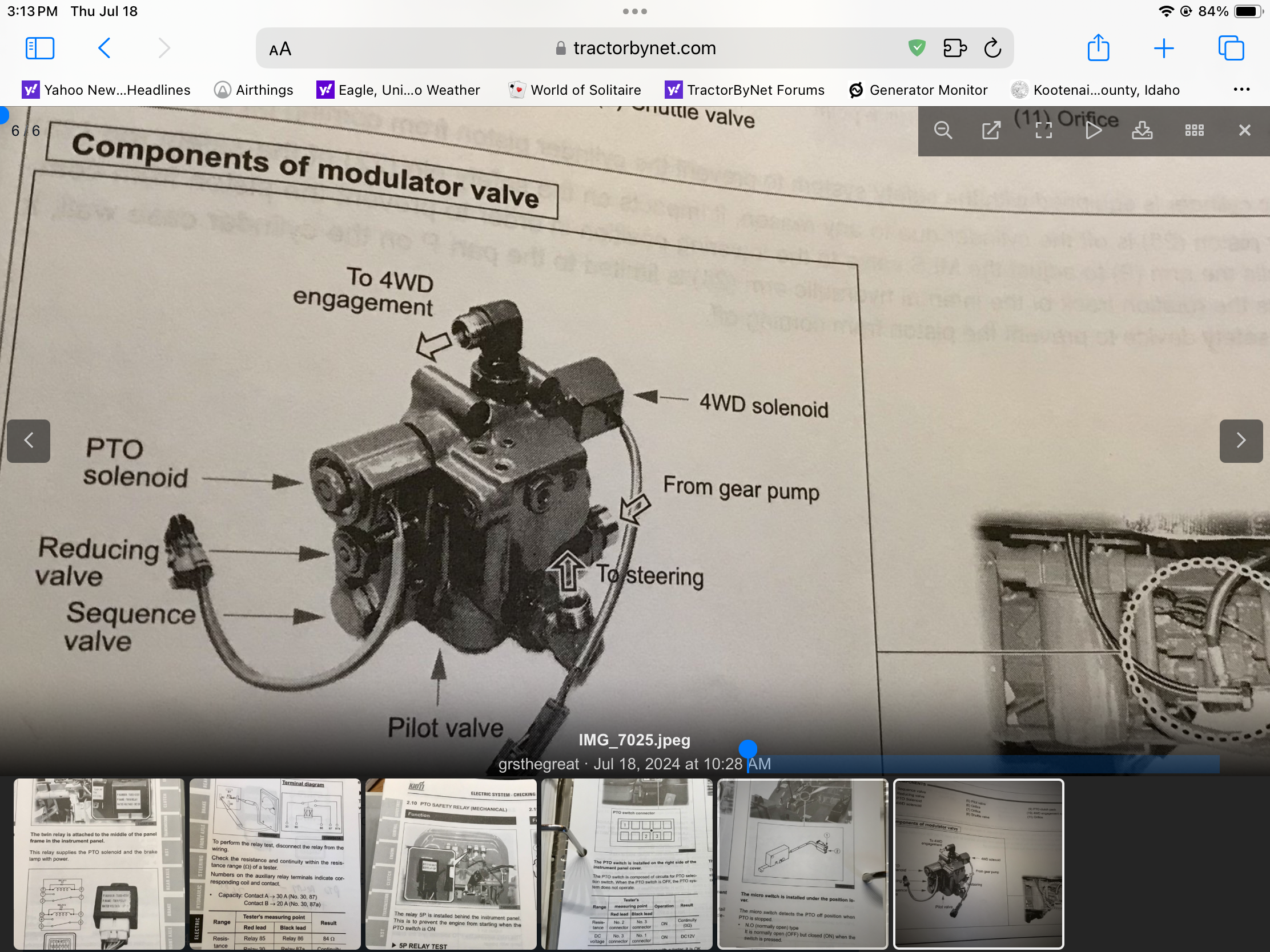

Ok, the book sucks in diagnosing 4wd solenoid, but it is part of the modulating valve assembly. Look at this diagram
