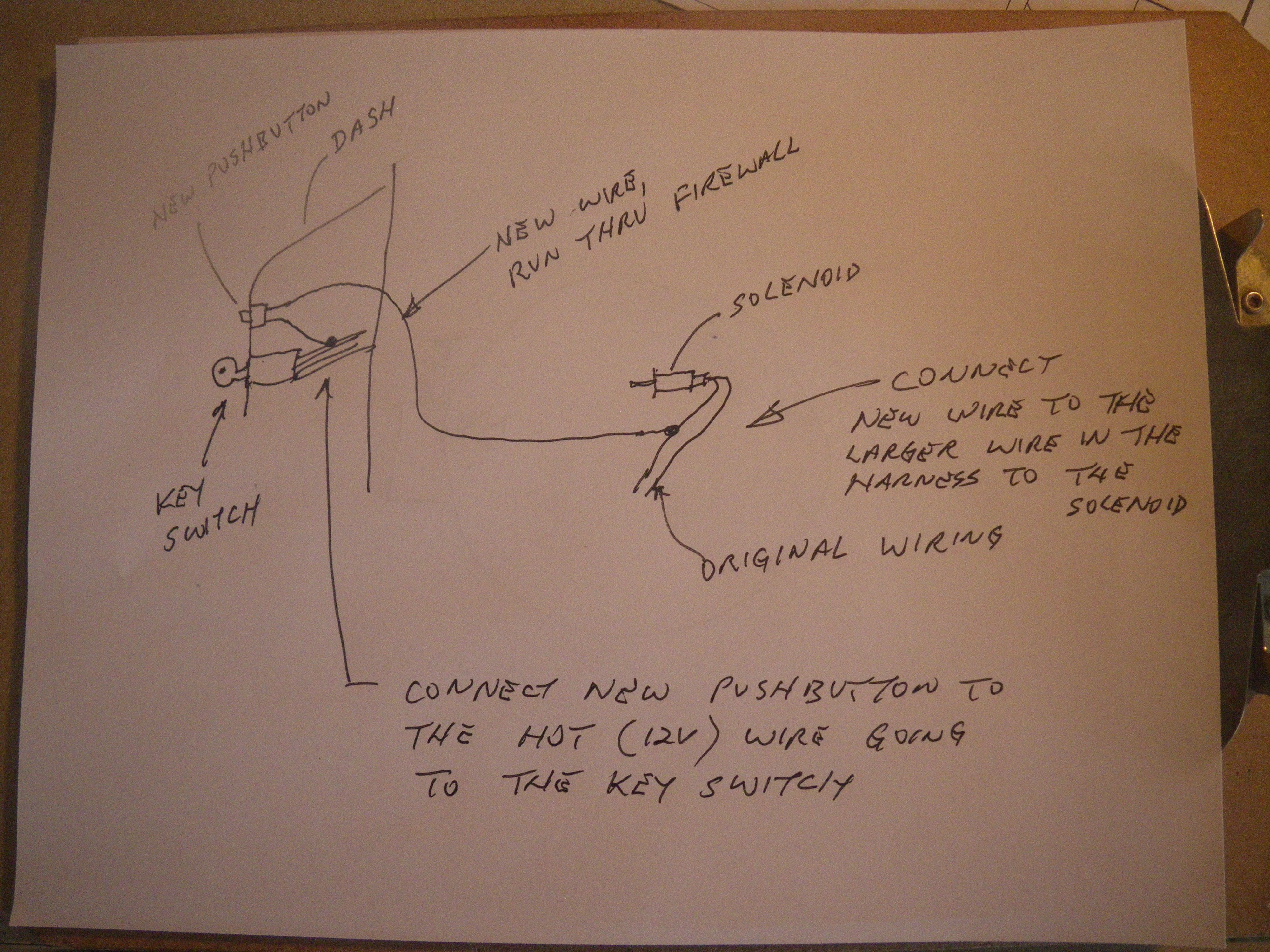

#16
Well, the new timing relay didn't fix it. I'm thinking there's some corrosion in a connector or something cutting down the voltage to the solenoid. Without a wiring and connector location diagram, I don't know where the involved connectors are. Recent shoulder surgery prevents me from crawling under and blindly poking around, so I did the bypass I talked about, Installed a push button connected to power and the pull in wire. It works great, turn the key on, bump the new button, the solenoid snaps in, and then start as normal. Not a true repair, but it works fine. Thanks everyone for all the info.
Hello. Great to hear you found a work around. I'm having this same issue with my CK35. Can you please post or send me some photos showing how you rigged up your push button and the wiring connections so that I can try doing this? Thanks
   / Older CK25Hst stop solenoid.
#20
I don't think pictures would show much, so I did a sketch instead. It's pretty simple. I did run the new wire inside a piece of wiring loom, and ziptied it in place to the existing wiring bundle. There is no need to cut the original wiring, just strip a piece of insulation and solder the new wire to it. It's been working great, except when I forget to push the button before trying to start.....
Sam
