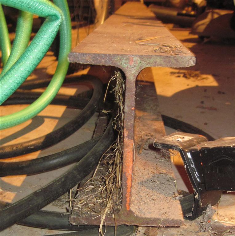

Yes, I meant twisting.
Thinking more... perhaps just a "toolbar style" 3 point mounted ibeam with one rake hooking onto each side of the tractor and possibly a wheel on each end to keep it out of the dirt.
Rough sketch: Rake hitch.png

   / 4x6 I beam, what will it hold? #13
16' long, so too short. Grabbed a picture anyways:
Would this ibeam, or a piece of box tubing resist rotation along its long axis better?
Thinking what my wife would call "dangerous thoughts" of making an arch style 2 rake hitch with this for the top and back or top and front pieces...

box tubing
