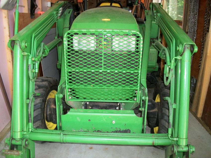

Grill guard modification on my 4300
   / 4xxx Series Grill Guard,, Ideas? #8
Your grill mod looks exactly like what I did to my JD970 (since sold). After I ran a couple of tree branches thru the mesh grill... It seemed to be a "smarter" way to work!
IMO - whatever you do for your 4105 grill - I'd make it loader compatible. 'Cause I'll bet you'll be lookin' for a 300CX one of these fine days.

My grill guard looks very similar to beenthere. Unfortunately, today is one of those days when TBN's answer to my pic upload attempts is - "you don't have permission..."
