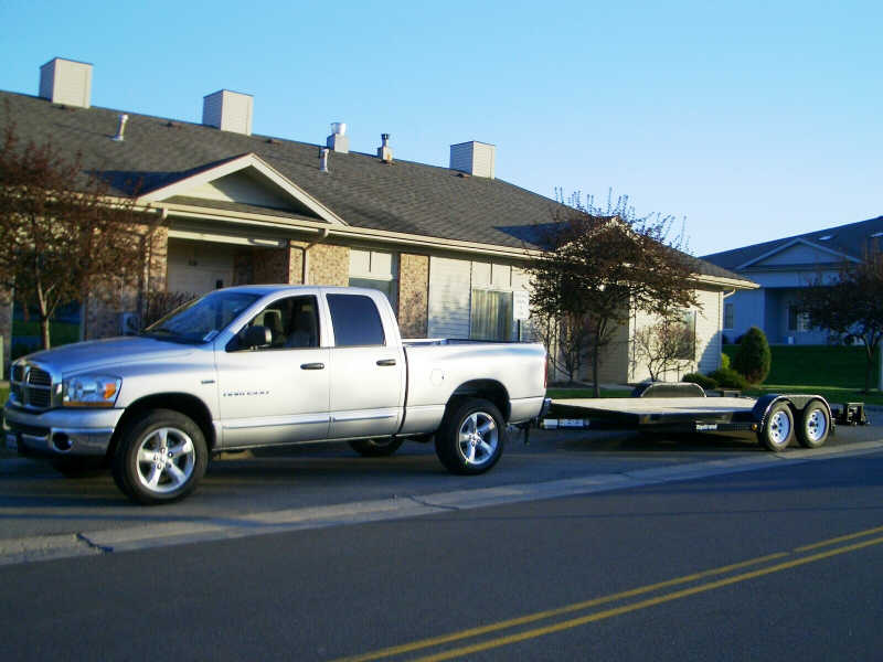

5yr/0% on a 2006 Ram Quad 1500 w/Thunder Road pkg 5.70L Multi-Displacement Hemi, 5-Sp Auto and 3.92 axle. Test towed my [empty] car hauler just fine but window sticker EPA Mileage shows 14/18. If this engine goes to 4cyl on highway, why isn't the highway mpg better? Seeking comments/experience/enlightenment from Hemi owners please...

The change in working cylinders is directly related to the power demand. If pulling even a relatively light trailer causes the computer to determine that the truck needs the additional power, you will remain on all eight cylinders. Even empty, but climbing a long grade on the highway will result in the same. The savings will be when cruising at speeds (in general) under 65 mph on flat roads without a strong head wind.
I know that sounds like a lot, but one of the major concerns of the manufacturers is to make sure that the consumer does not perceive the truck as feeling sluggish on the highway. A dealer I know very well said that he can change some of the computer settings with their Chrysler computer equipment, but the results are not what customers like because you can actually 'feel' the changes in displacement. The idea from Chrysler Corp is to make this displacement seem invisible. In other words, they are giving up a few MPG to make sure that customers don't complain that the truck 'feels' different.

Try as I might, I honestly could not feel when the fuel management system switched the Hemi from 8 to 4 cyl. On the Ram, the driver info display includes only avg mpg, not current mpg, but you could still tell it was working because the avg mpg would start up noticably after a few mins on a flat stretch. I assume having the trans in 'Tow' mode keeps the engine on 8cyl and I was avg'ing 12.4mpg pulling the car hauler around the back roads. I saw a high avg of 19.5mpg after about 5min of slightly hilly 55-60mph unladen driving. My bigget complaint about this truck was the front edge of lower seat cushion was too high, rather uncomfortable for my short legs. Pretty good hike up into the cab as well.
