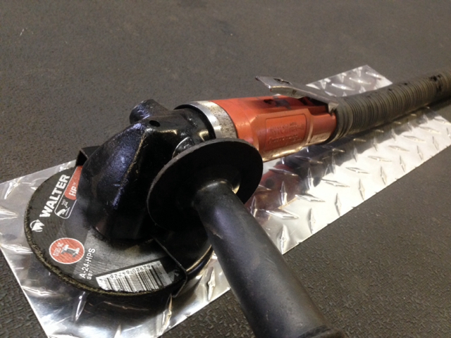

Wow, 30cfm. Better have a big compressor or you ain't grinding long.
Those specs for 30cfm must be a misprint.
I have a two stage Atlas Copco with 23 cfm / 80 gallon tank. No problems.

That spec is 30 CFM but that is at their 85psi max and no load.
If you have 23 cfm at 175 psi, you are gonna be able to make more than 23 cfm at 85 psi, and with a tankful of 175psi air, it would be a VERY long time before you ran out of air. So considering under load the grinder uses less air, probably why you dont have any issues. But about the next step down in air compressors is 60gal single stage stuff at ~10-14cfm and 120psi, what you have would probably be the minimum.
   / 5" Angle Grinder #63
Thanks for clarifying, LD1.

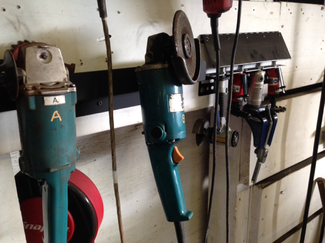

Here's the Makita 9005B that Arc Weld mentioned. Kind of the best of both worlds for switches. Instant on or off OR lockable on.
Both of mine are about 20 years old with zero problems.

I think that 9005b is the same 5in ginder I have thrown up under the bench. Switch went bad and never got around to fixing it. May have to drag it out and see what a new switch cost now days. If I remember back when the switch first went out, a new switch was almost as much as a grinder.
   / 5" Angle Grinder #72
Quick search indicates around $20 for the switch, was curious as I have one of these as well. Mine was pieced together from three that I rescued from the trash at work, mixed and matched the serviceable parts. I think that these switches might be serviceable, and could be reworked, especially if you didn't care about keeping the lock on function. I seem to recall having to remove that from some grinders as that was a no-no for industrial applications, at least in Oregon. Or so we were told anyway.
   / 5" Angle Grinder #73
Makita Parts 651128-3 SWITCH, 9005B For Makita electric grinder
I used this place before and the shipping was very reasonable too.
I got parts for a Makita VSR drill and recip saw
Googling the part number online its widely available for various prices :D
