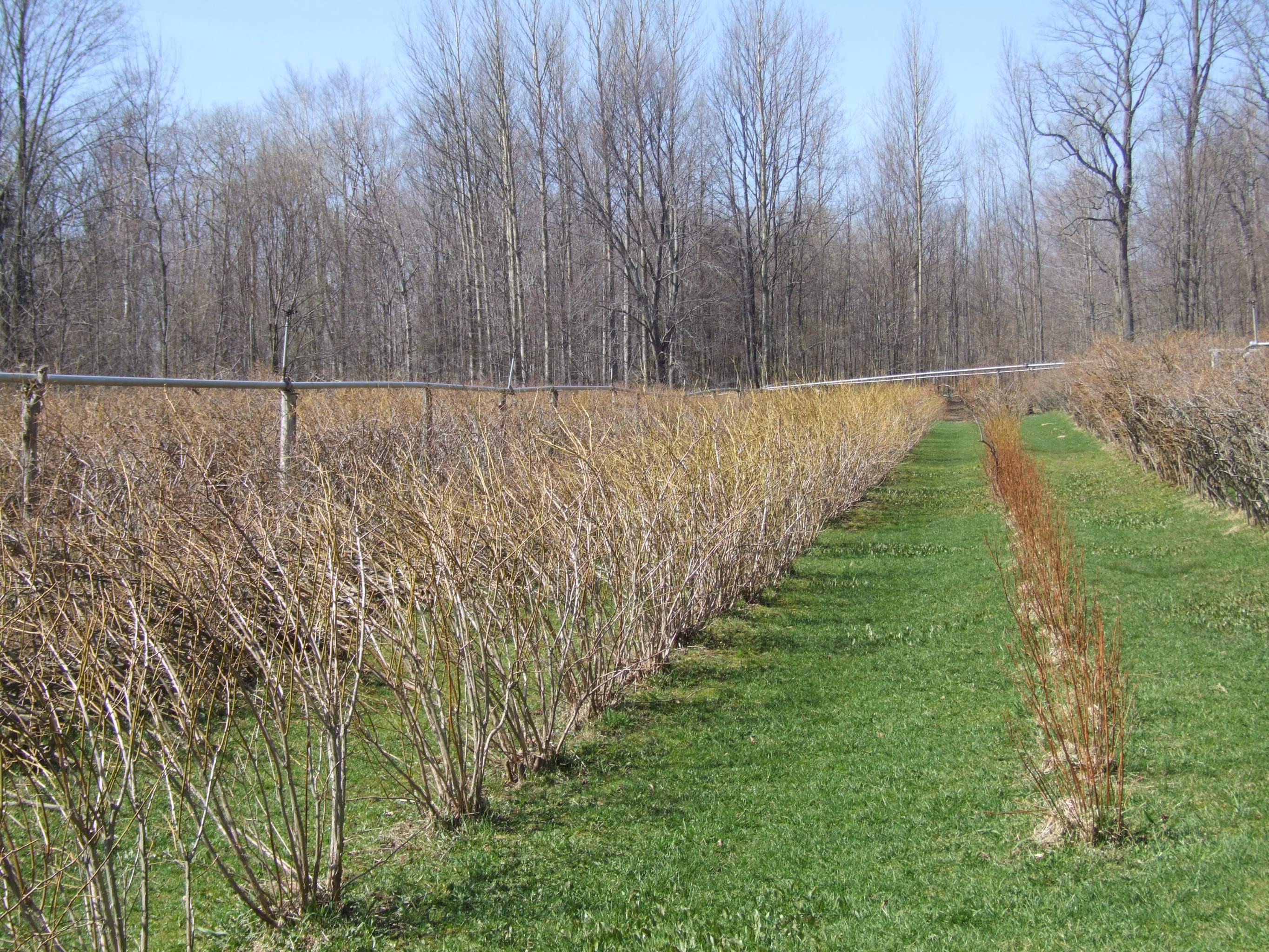

I would have to say it depends on what you are cutting and how fast you want to cut it. I run a 6ft behind my Branson 2400h but that is to allow me to mow between the blueberries and maximize the cut. I also do not go very fast between them. It does cut my time down from 4 hrs to 2 hrs since I no longer have to make two passes in each row. Which I had to do with the riding mowers. DSCF0991.jpg
