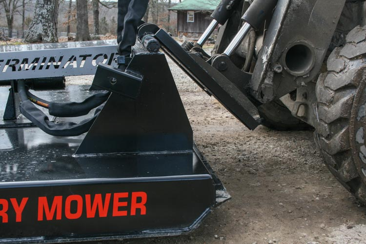

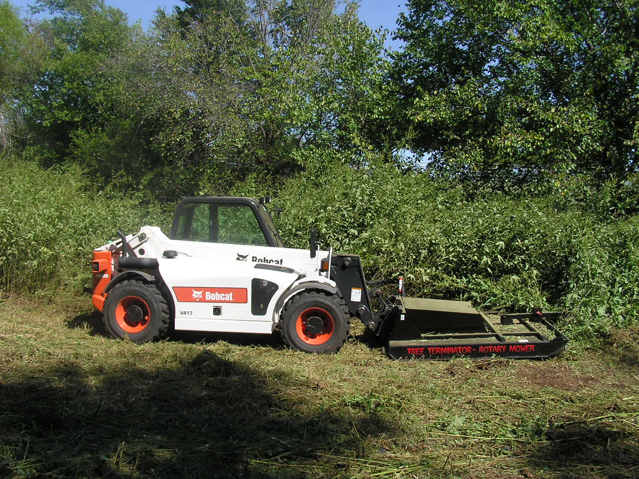

Check out this one with a removable front wheel and hinged SSQA plate: Tree Terminator Rotary Mower
I have an early version:
