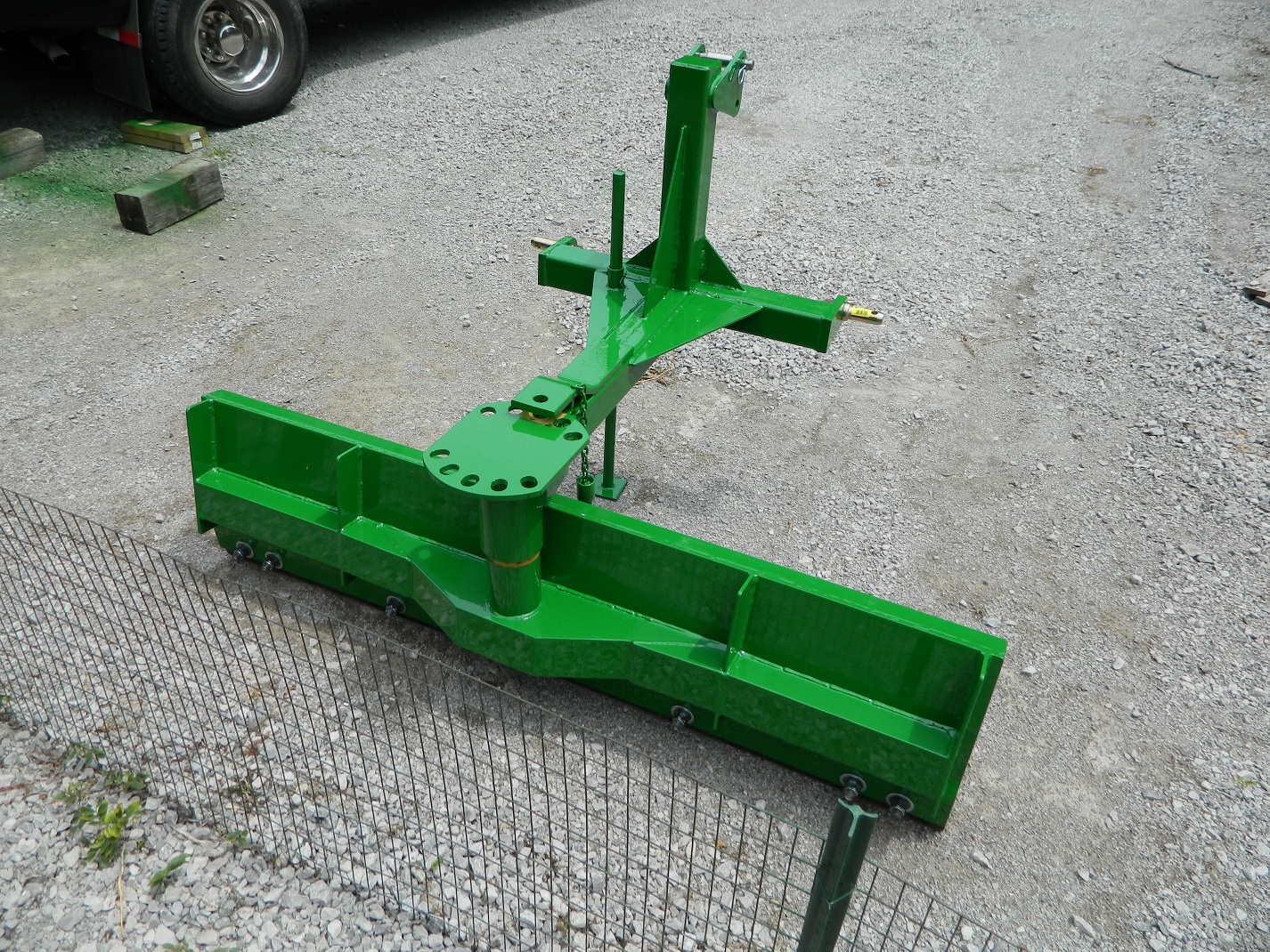

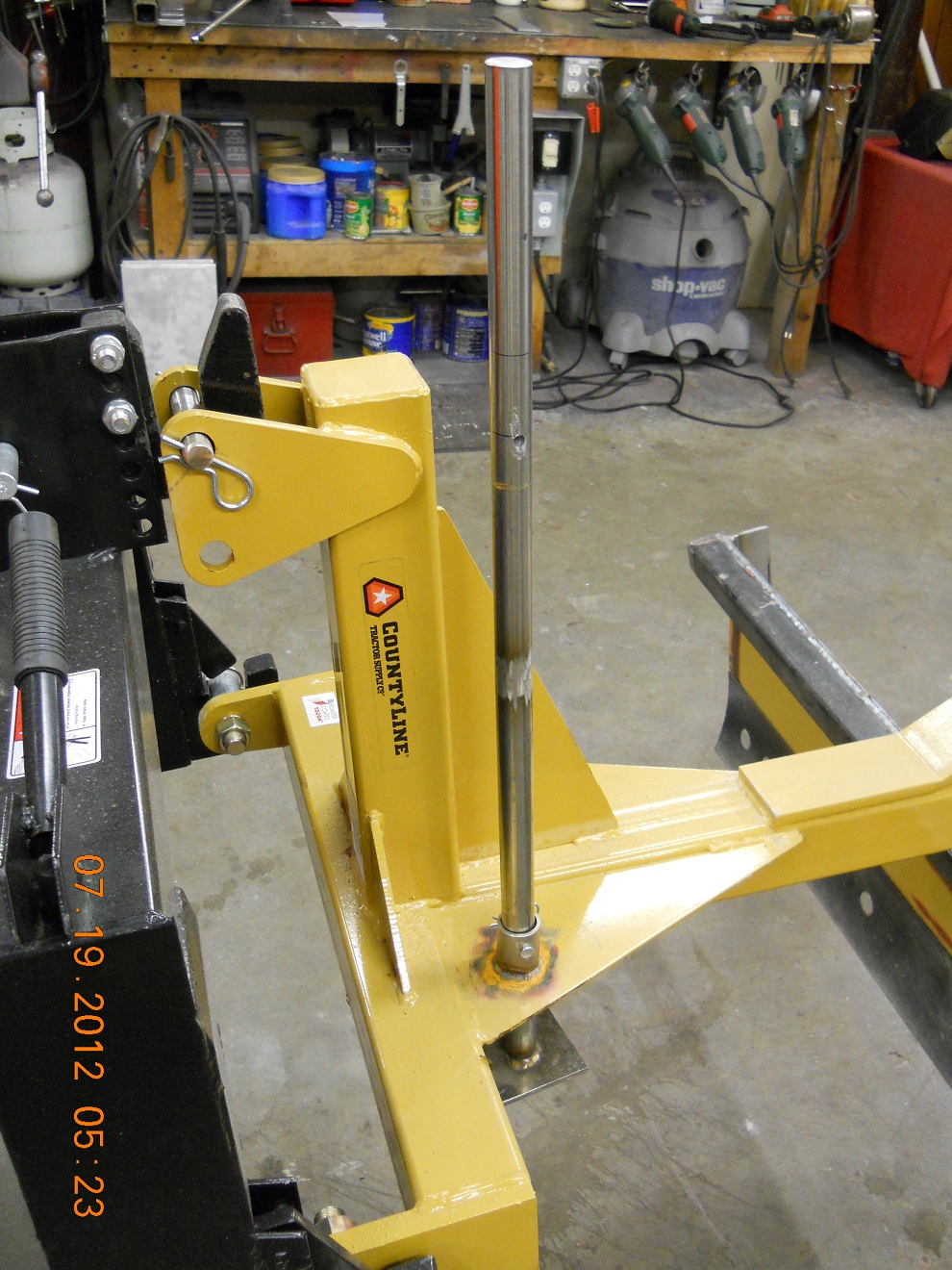

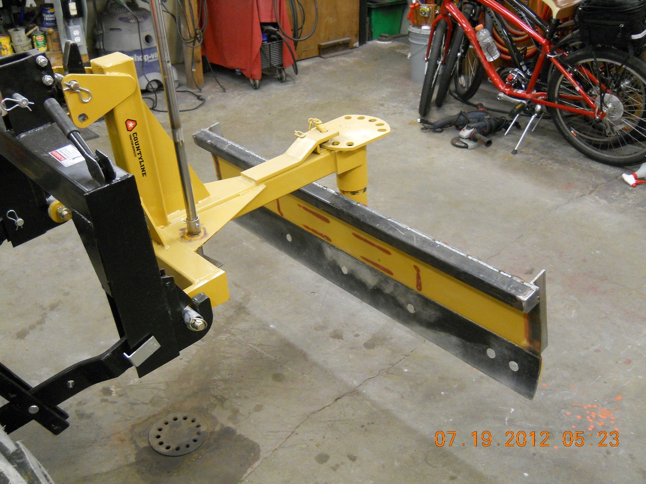

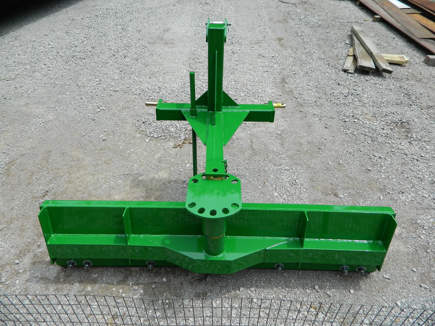

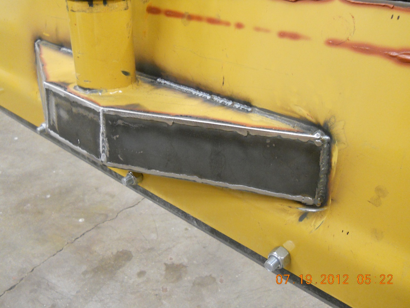

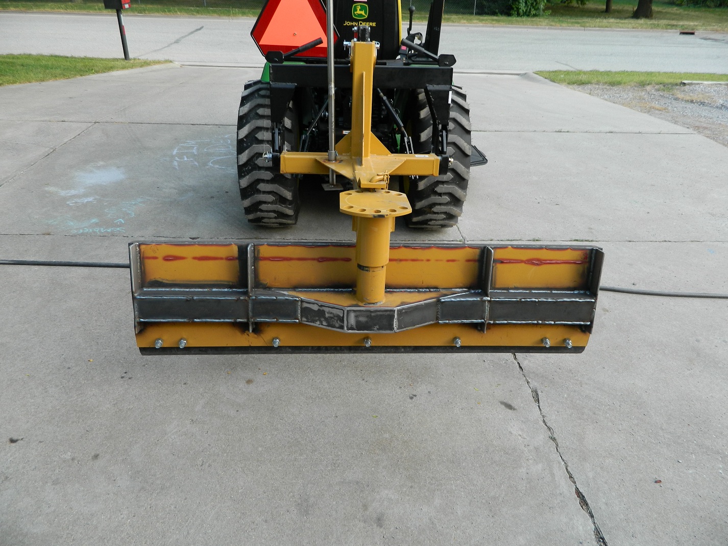

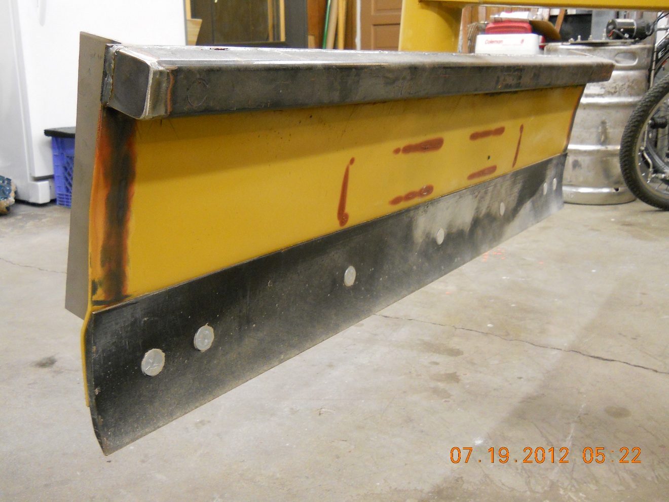

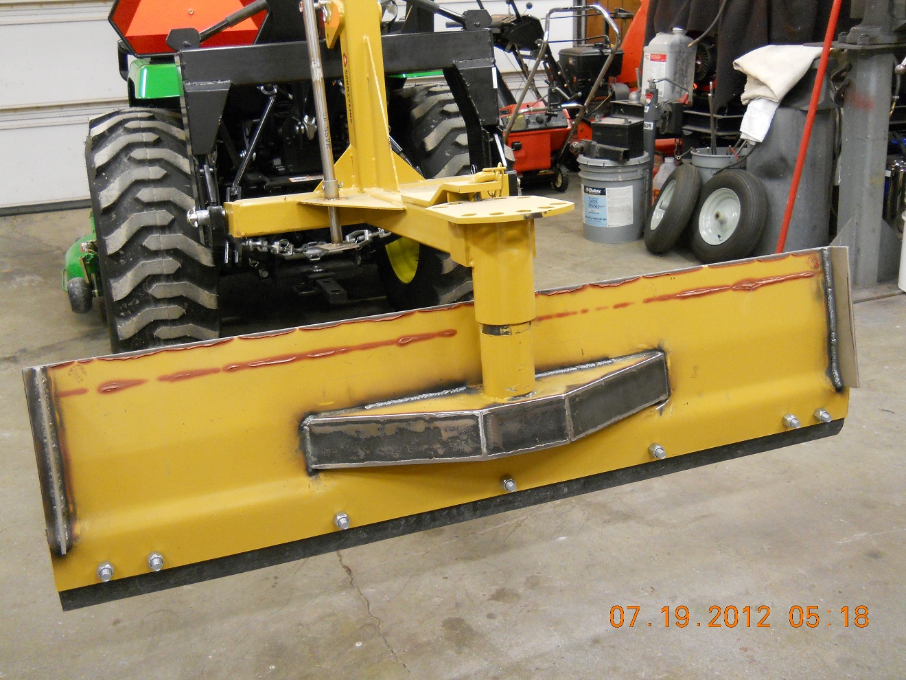

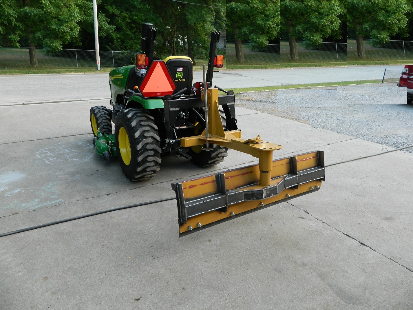

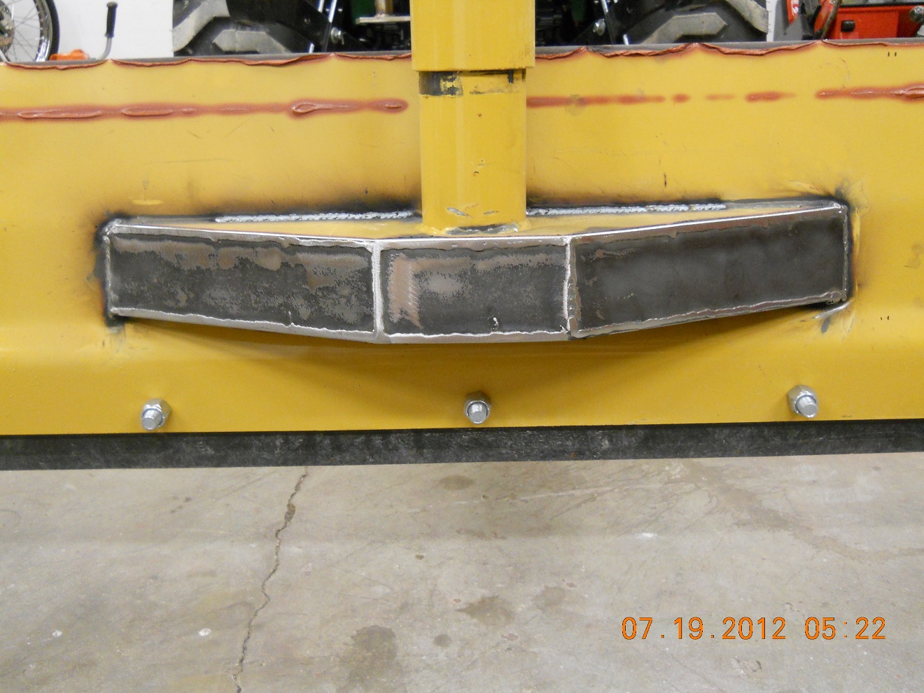

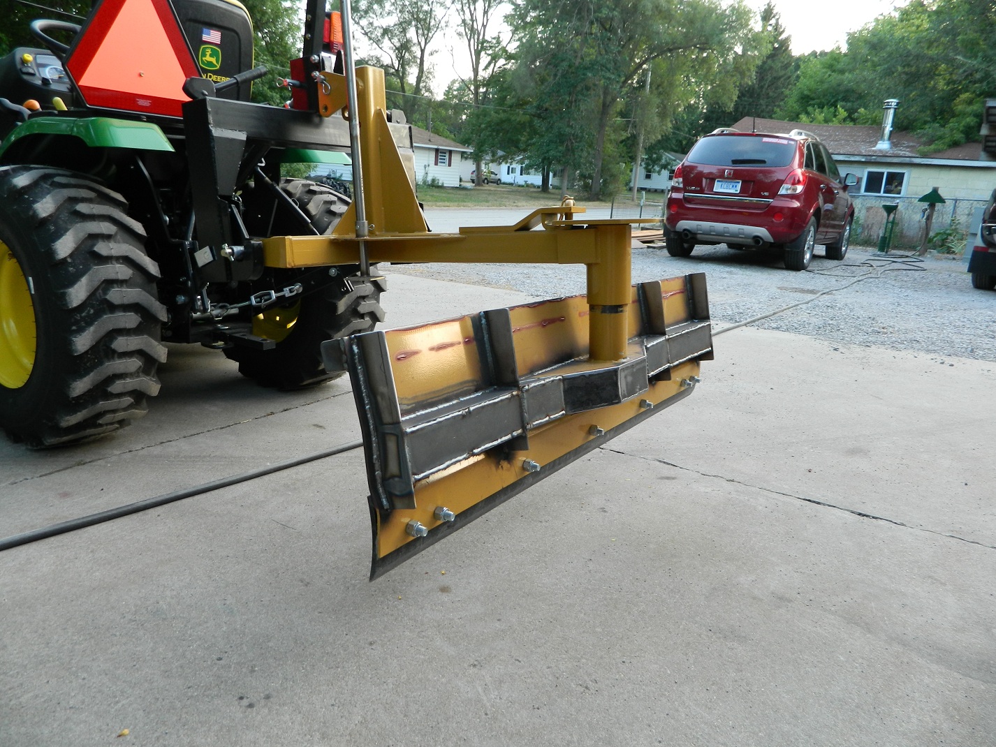

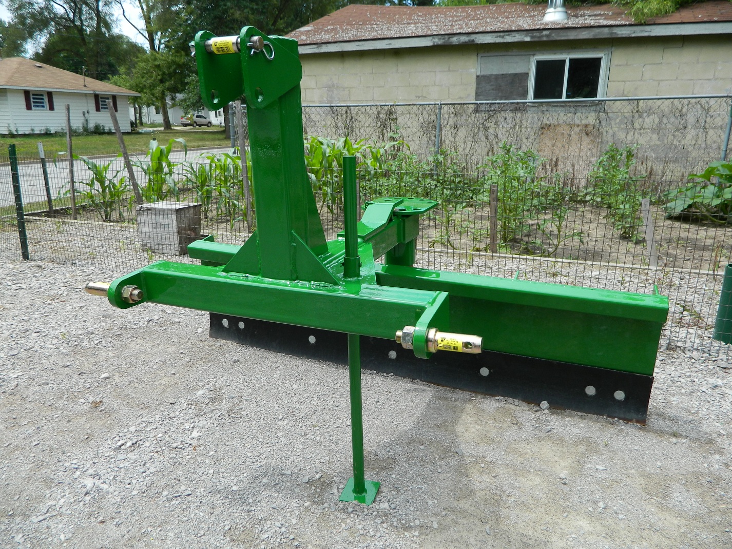

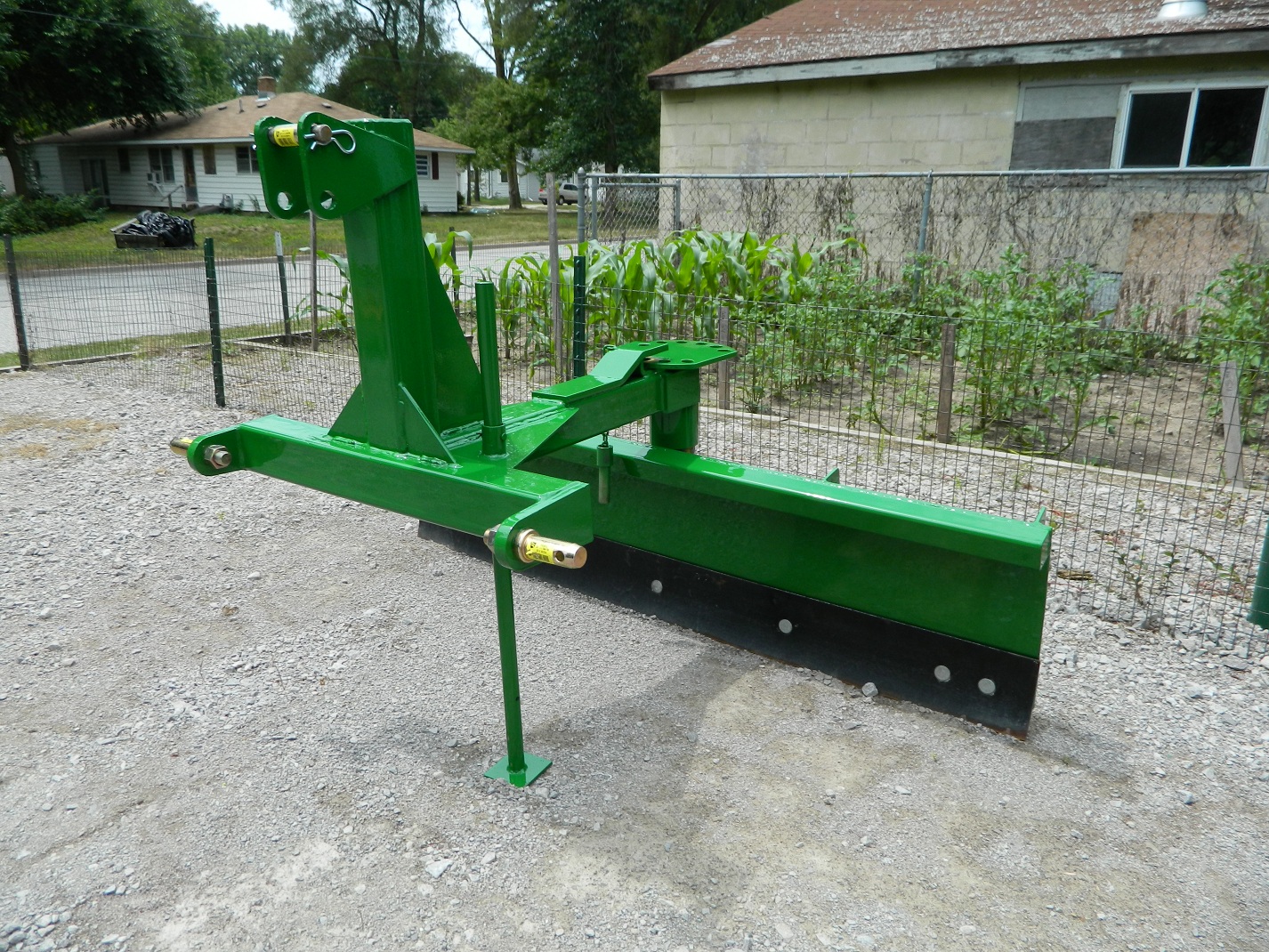

I WENT WITH THW TSC BLADE AND MADE SOME WELDING MODIFCATIONS TO BEEF IT UP.
I AM WORKING ON STAINLESS STEEL ADJUSTABLE SKID SHOES THAT CAN BE REMOVED.
I ENJOY WELDING AND AND THE TSC BLADE WAS IN MY TOWN / NO SHIPPING COSTS.
ANY OTHER BRAND COST MORE PLUS SHIPPING RATES WERE EXTRA.

   / 5' straight rear blade vs box scrapper? #17
Nice modifications:thumbsup: Very professional looking

The blade looks good. You may want to use poly shoes to keep from scratching your driveway.

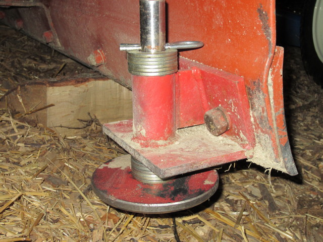

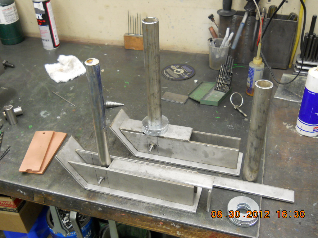

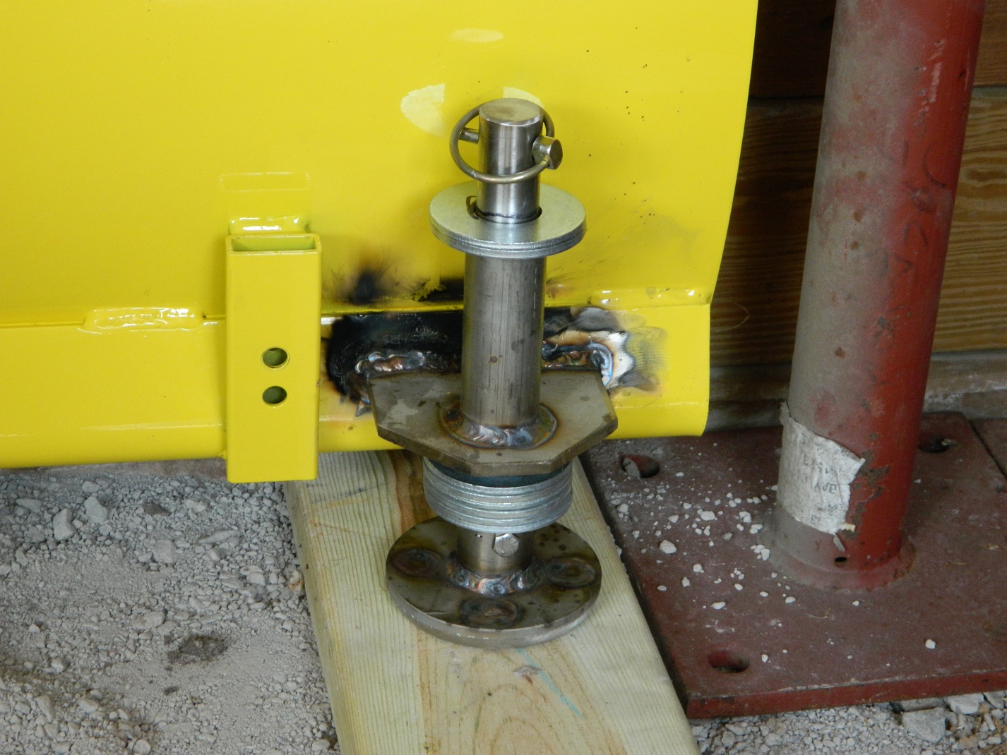

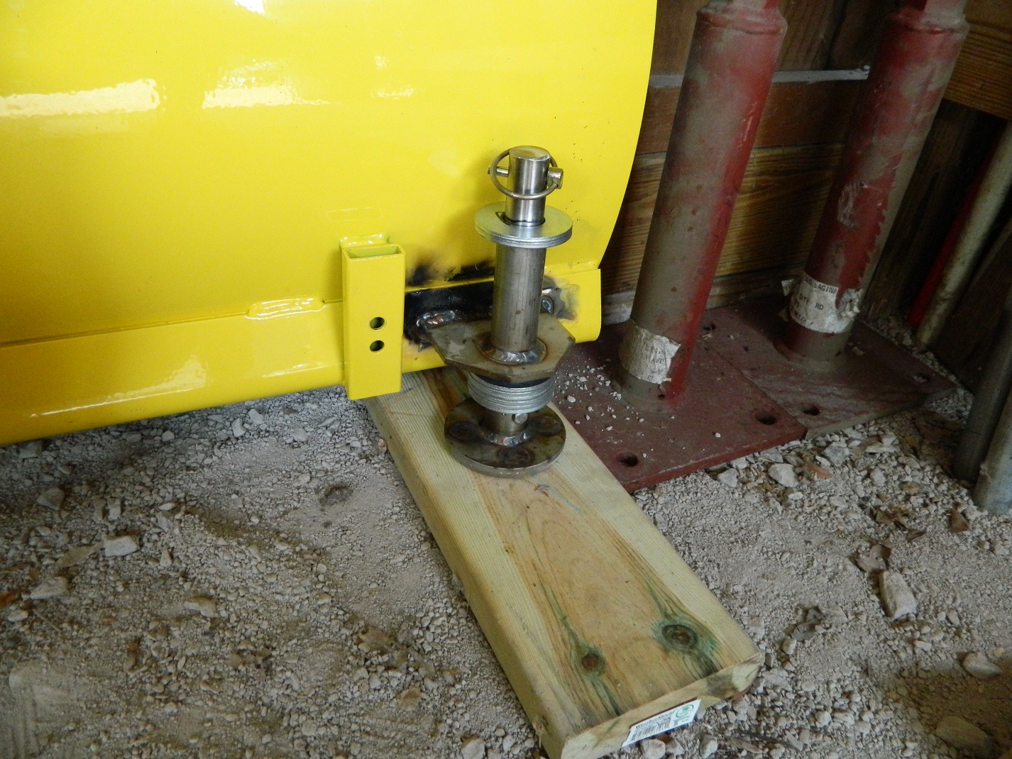

Here are the shoes I made for my Rhino blade. I can change the height by switching the washers from top to bottom. To take the shoe off, just pull the pin when the blade is up and the bracket stays on the blade.rhino shoes 001_1.JPG

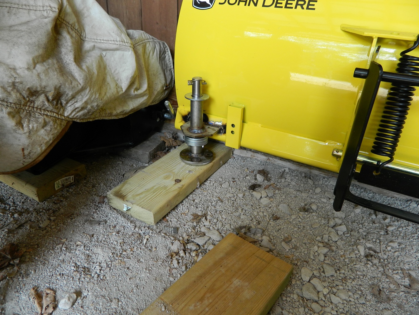

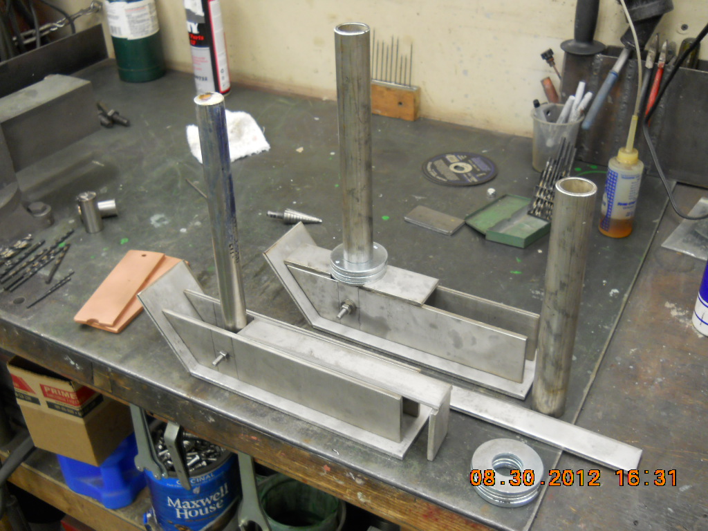

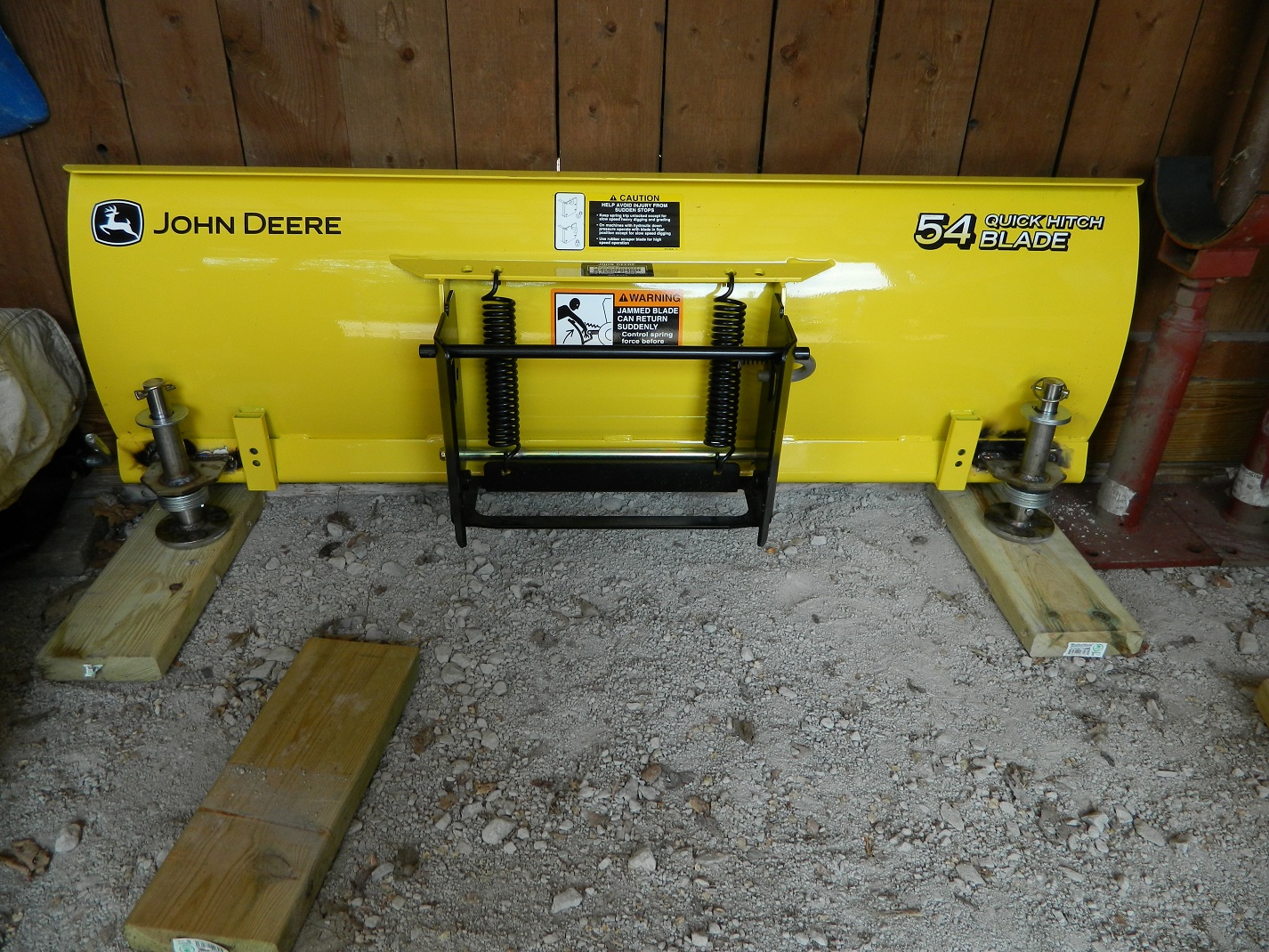

YES!
THAT LOOKS REAL NICE.
I HAD THE SAME IDEA WHEN I DID MY FRONT PLOW. I HAVEN'T QUITE FINISHED IT YET.
FOR MY REAR BLADE I AM WORKING ON A LONG SHOE THAT CAN BE USED FOR LEE=VELING GROUND TOO.
I MAY USE BOTH STYLES WITH SEPERATE MOUNTS???
