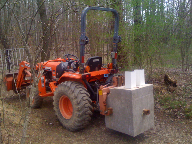

Your 2910 is pretty close to my B3300 in size. My barrel is about 800 lbs and none too heavy. Did you go with water just for the reason that you can "make the 400 lbs go away" and 400 is all that fits in the barrel or because you feel that's all you need/want for weight? Like just about every other attachment that we use, either unhook somewhere out of the way or unhook on a pallet and move it with forks.

On the weight, (55gals water = 445 lbs) in what I do, gut feel is 400 is about the minimum and I'd prefer heavier. I know what zero on the rear is like, and 400lbs on the rear is better, but not enough to be "comfortable". I'd like 600 or 800 lbs. Filling my rear wheels, especially if theres a good way to do it (washer fluid?) may be the ticket. As I said before, not planning to go the "foam filled" $1000 route this time. $100 might be OK.

I assume you're talking to the OP (because of the references to a barrel quoted below) ... he actually has a 2710 ...
I'd agree ... if I want the weight to "go away" then I'd just unhook ... a lot less time consuming than emptying (and then having to refill) a barrel.
Having a Quick Hitch on the 3PH, and having the ballast block set up to fit it, does make the unhook/hook go a little faster tho':

445 lbs barrel + 30 + 15 of attchmts is about 500 lbs
OK let me revise what I wrote above. Tractor wheelbase is 65", and the CG of the ballast is 42" behind the rear wheels. This comes out to be (65/42*500=) 774 lbs ballast weight transferred to the rear wheels (some removed from the front) - so maybe I'm OK with 55 gals of water (full to the top of course) !

My water barrel remains full (especially if frozen). Pretty easy to unhook the 3-pt. attachment although not as easy as a quick hitch. Also I can unhook from the 2" receiver hitch. I suppose 445 lbs barrel + 30 + 15 of attchmts is about 500 lbs, which comes out to be 600+ on the wheels so maybe I'm OK.
After shimming the PRV on my loader, I was able to (easily) pick up that ballast block with the forks on the loader and move it ... with only the box blade (around 500 - 600 lbs) as a counterweight on the rear ...
So yeah, for most stuff, you're probably fine ...
Still, like CDN Farm Boy states, for some stuff 800 lbs is none too heavy.

Windshield washer fluid won't freeze and shouldn't corrode your rims and is probably environmentally safer VS calcium chloride (salt water) that farmers used to use because it was heavy and wouldn't freeze, but it can corrode your rims and if it leaks out in one spot that spot is probably never going to grow anything ever again, as salt can't evaporate.
Check out Rim Guard as one possible alternative.
Don't forget that by transferring weight from the front to the rear you are lessening the effectiveness of the front wheel drive.... as with all things, there are trade-offs. ;)

If you want more weight than the 445 lbs using just water gives, you could throw some heavy rocks or scrap iron in the bottom. Something that weighs more than a gallon of water but takes up less space. For my BX i use an old garbage can and 320 lbs of concrete, if i need more weight i'll throw some 60 lb sandbags on top
