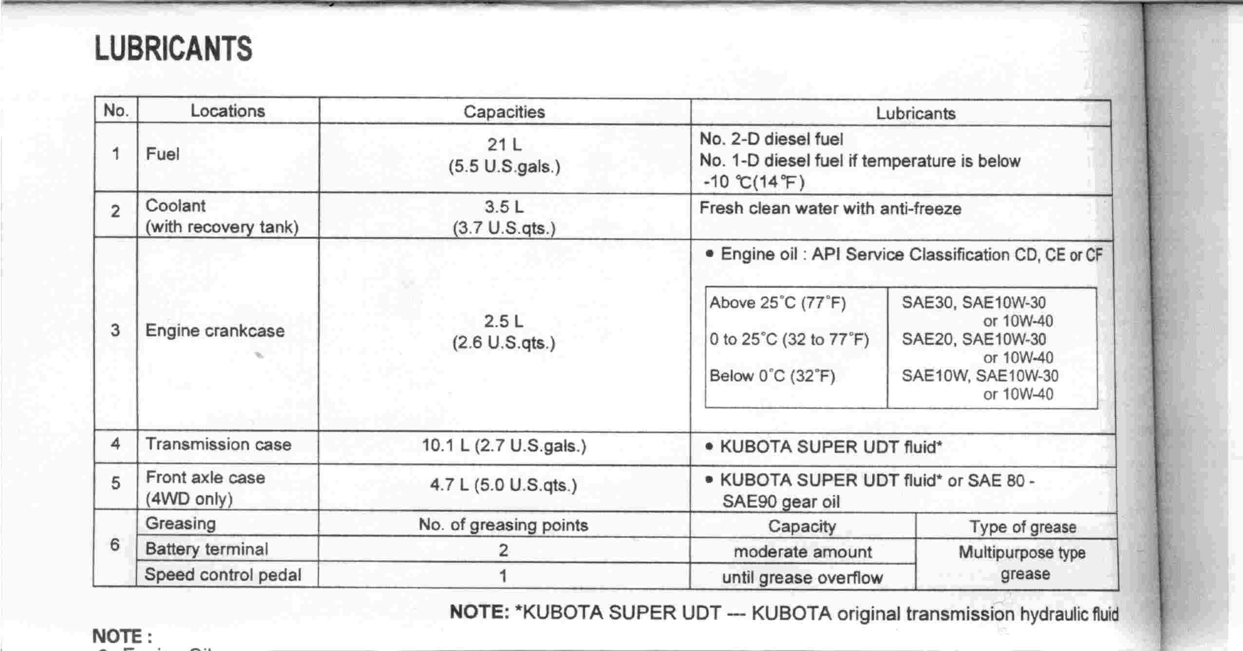

You are not being wise at all.
By the way my wife just saw your dogs CUTE!
Any way the manual for my 2004 Specifies SUDT, and it was the factory fill on my machine. I don't know if that is BX-23 specific or not.
Dealer told me Kubota is insistent on SUDT for my machine.
I have heard of problems with some after market fluids.
I saw -20 here last winter Near Albany, NY. That is extreme cold to me. Heck I don't really like it below freezing. /forums/images/graemlins/grin.gif /forums/images/graemlins/grin.gif

just curious did you see my attachment?
Your owners manual must be different than mine. Maybe it is a BX-23 thing. Backhoe maybe??
   / 50 hour service. Price for the kit #15
Brian,
Yea, I saw your manual, so I went to the shop and looked at mine. The BX2200 says the same as yours and the L3430 says it's ok to use the regular UDT or the Super UDT, either or /forums/images/graemlins/confused.gif I'm going to stick with what my dealer recommended, the regular Kubota UDT. Kubota probably recommended it because it is more expensive.
