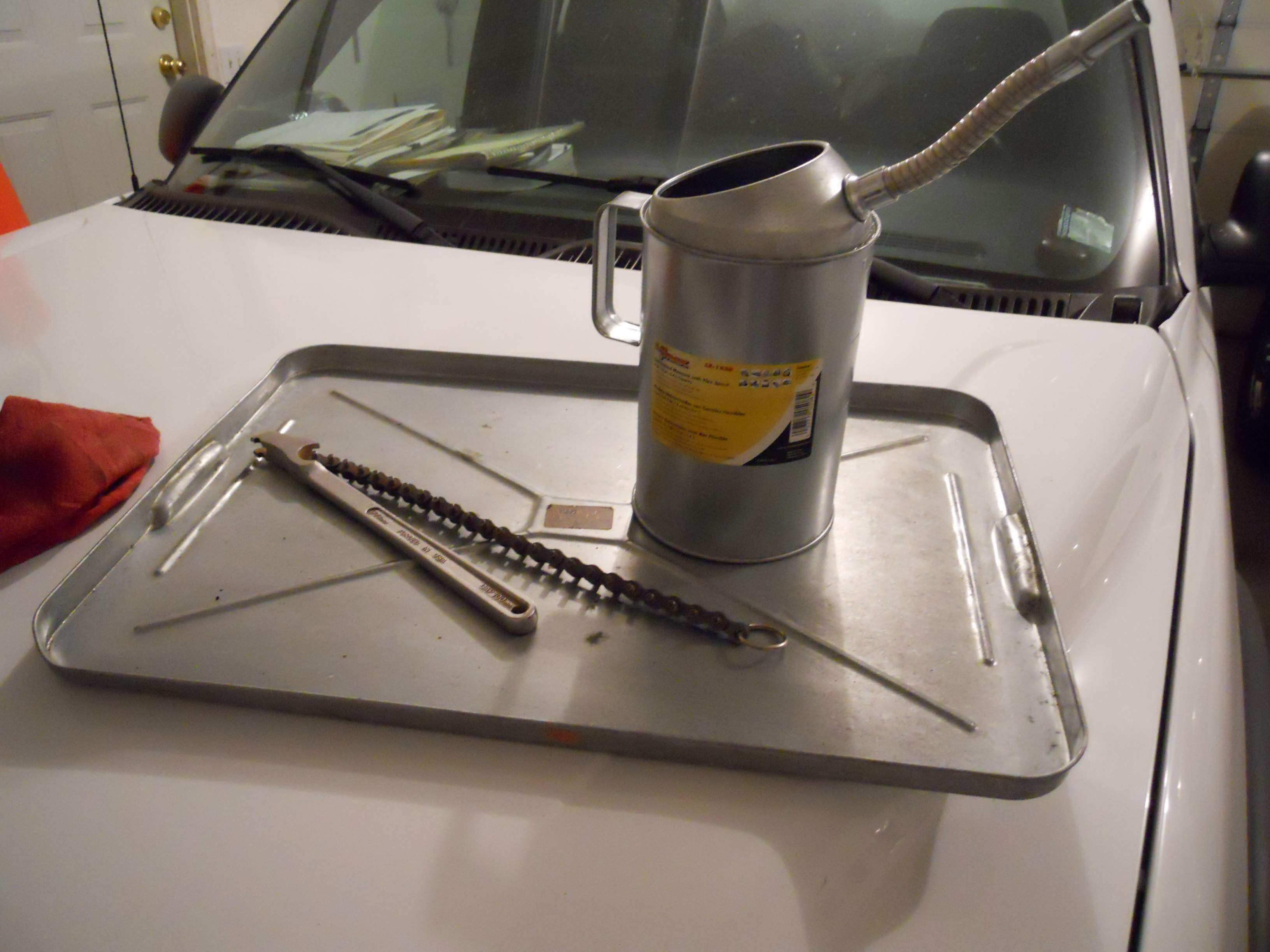

First of all , the three things that helped the most were the chain wrench for the hydralic filter , the big drip pan , and the fill jug that Holds one gallon for filling the hyd oil . I spent about 4.5 hours total and still need to check clutch and brake free play . Maybe one night this week ! I thought most drain plugs I removed where not very tight for my comfort . I had problems draining the front axle . left side drained quik , but right side was slow the hole way , and I never got the almost 2 gallons drained that should have been in the front axle .(half hour draining) I had the plugs open for venting and also rocked the tractor back and forth . Anyone else had this problem ? I also could not find the two grease fittings labeled (power steering cylinder) page 7-19 in owners maual . Have they been eliminated ?
Overall comments on the tractor at 50 hours are good , but I will wait for at least 100 hours and write a review. I will say the shifting has become smother and seems to have more power . With the new hyd. fluid ( shell Donax ) the brakes seem to be stronger also . Only flaw so far is the shuttle shift could be taller , a little hard to reach , but I am 6'1" . Thanks in advance !

RE: any drain plug. Dealer told me just snug enough or risk stripping out the pan's threads!
/ 50 hour service #3
At 24 hrs I'm 1/2 way along to the 50 hr service.
I checked my DK35 HST which I believe is the same frame as the DK40. Like yours it does not have grease fittings for the Power Steering Cylinder noted on Page 7-19.
While checking for those grease fittings I took the opportunity to remove the front axle oil level check plug as I could not see the oil in the little window (the level was fine). As carhartt mentioned I also found it easy to remove and was careful to reinstall it with what I hope was similar torque.

What I found most worth while - I think it was 25 bucks - was the 5 gallon pail lid pump for the hydro fluid. If you don't mind hand crank it was definitely a time saver from the dip and pour I would have been doing. I just did my 100 hour too. Well most of it - I kinda combined a 50 and 100. All filters and fluids - except engine coolant - will do that soon. Need to check greasing and all the levers and latches yet too. But so far no issues so I will do that first warm day.
I did buy a multisize pack of grease fittings - probably want to do that next time you are at the supply store. Broke a couple of those with the greaser - nothing a quick easy out and reinstall doesn't fix - but nice to have em on hand. That is probably the second best thing I purchased - a decent air compressor driven grease gun... and the extra 10 bucks for the flex hose nozzle. I can grease the whole beast now in just about 15 minutes.
