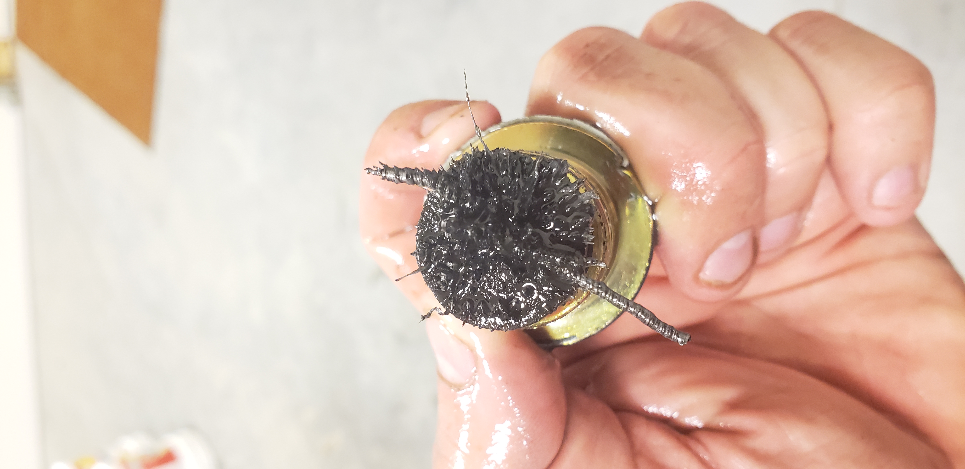

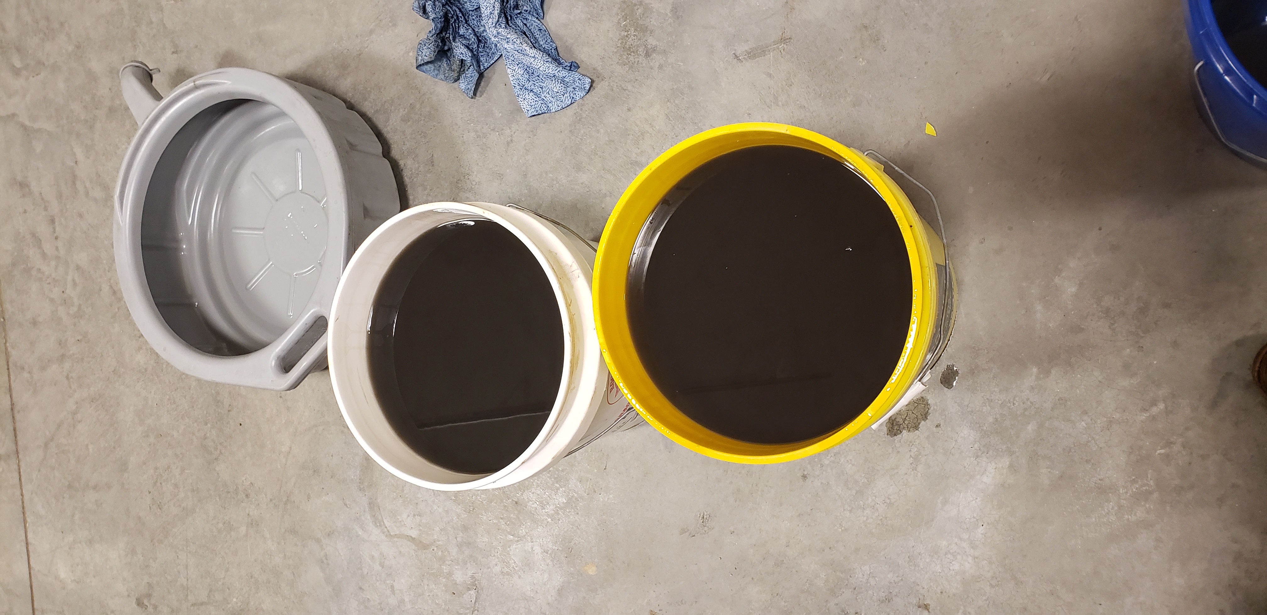

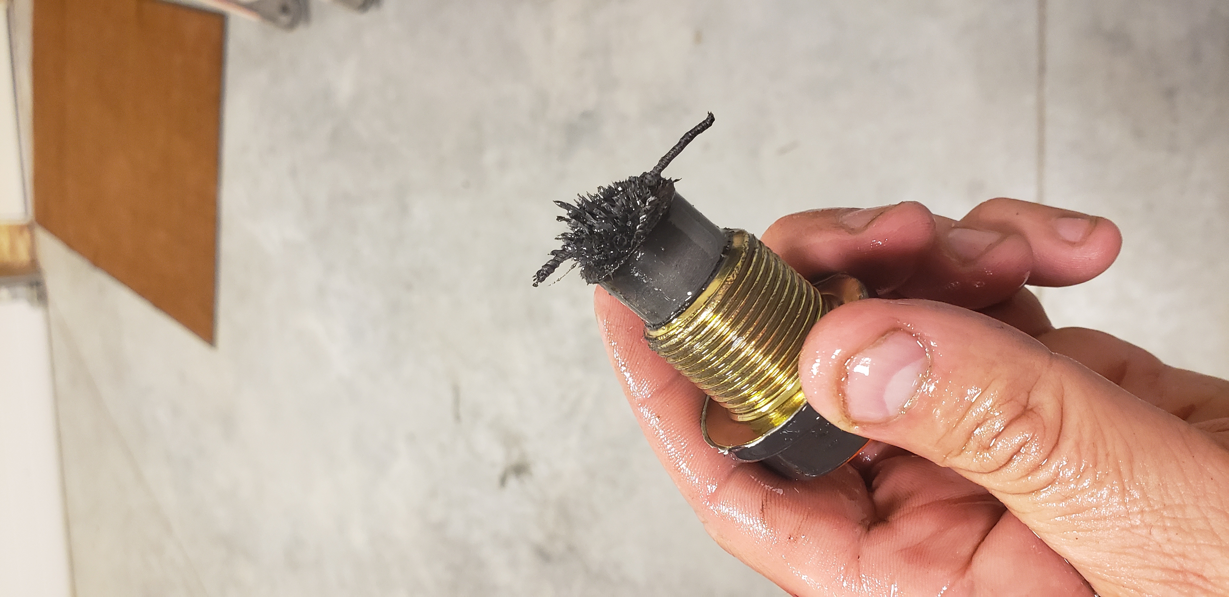

Just an FYI on the 80w90 gear oil. It is the same thickness or viscosity as the hydraulic oil...30 weight oil. Gear oil viscosity is not apples to apples with say engine oil. They do it this way so you don't put gear oil in your engine. It doesn't have the proper additive package to be used as engine oil.
Anyhow, on to the point of this post. I drained and refilled my transmission/hydro fluid tonight with 85 hours on the clock and I'm reporting back. I found TONS of shavings on the magnet and I'd have been glad I changed the fluid for that reason alone! The fluid was fairly dark, however not likely that it NEEDED to be changed. I really didn't expect any difference in gear noise. I figured I'm putting back in pretty close to what just came out of it, so it shouldn't make much difference. Wow, was I wrong! I sure wish that I had taken a DB measurement with the app I have on my phone just for a ballpark on the difference it made because it is noticable! I plan to run this fluid for the next hundred hours or so just to flush any other metal out of the system and catch any more break in debris if there is any, then I will change it out again for a good quality synthetic that should last a couple thousand hours (with filter changes and periodic sample testing of course). On to the pics...

I am amazed at your results. I changed my hydro fluid at 200 hours and there was nothing on the magnet and the fluid still looked like new oil.
I must not be working mine hard enough.:laughing:

I'm thinking that pulling a plow has to be just about as hard as ya can be on a tractor without abusing it.
Did you pull all 3 plugs when you drained it? Only 1 plug was full of shavings, other 2 were clean. I'm sure glad I changed that fluid out even though it wasn't called for. Kinda wish I had changed it sooner.

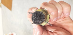

View attachment 601220View attachment 601221View attachment 601222
I can't believe the crap on that magnet. It's a good thing that there was a magnet on the plug! I changed the trans/hydraulic fluid on my Kioti CK30HST at about 65 hours and it didn't look anything like yours although there was a little debris on the magnet. I switched it out to Amsoil Tractor/hydraulic fluid and I couldn't be happier. My shed is at the far edge of my property and so it isn't easy to warm up the tractor much before I start to blow snow. The hydraulics work at the same speed be it summer or winter (this fluid isn't thick in the cold)and that's important to protect all the internals of the system. It meets Case, JD, Kubota specs as well as many others and is an all-season oil so that it doesn't need to be changed with the seasons like some lubes do. It's not cheap but if I order it direct and wait for a promotion I can usually get it shipped for free. It is a long life lubricant too, although it would be best to do UOA to determine how it works in each application. I currently have about 250 hrs on my oil fill and looks pretty clean yet. As a matter of fact, it's hard to read on the dipstick. See info here... AMSOIL Synthetic Tractor Hydraulic/Transmission Oil SAE 5W-3 Dutchy
Yes I did pull all three plugs.
