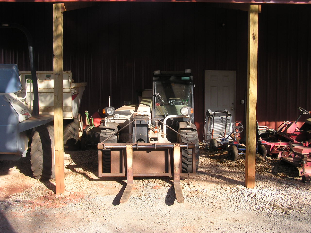

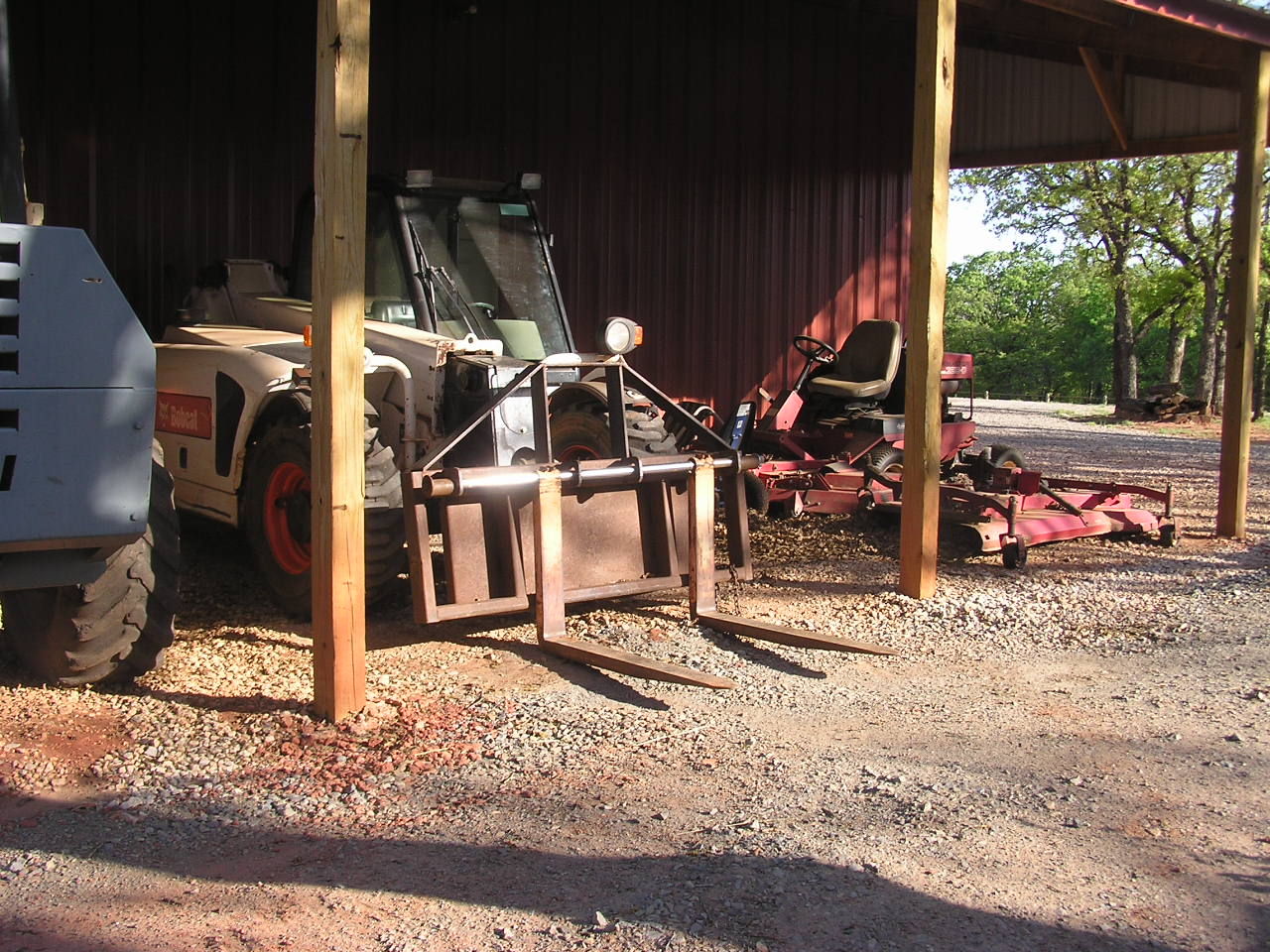

No not a skid steer, you need a compact telehandler! :thumbsup:

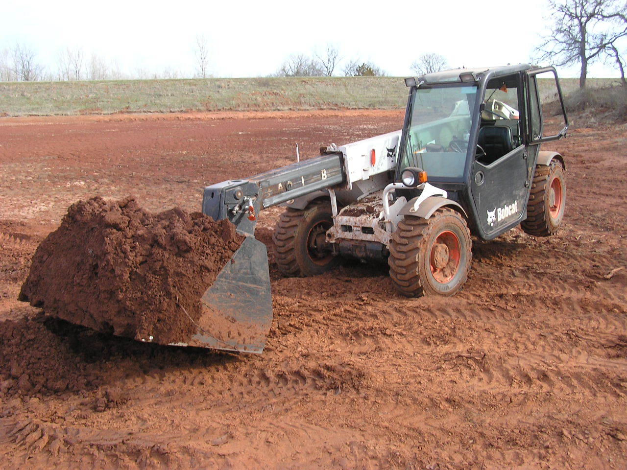

With the pallet forks, rated to lift 4,400 17' high.

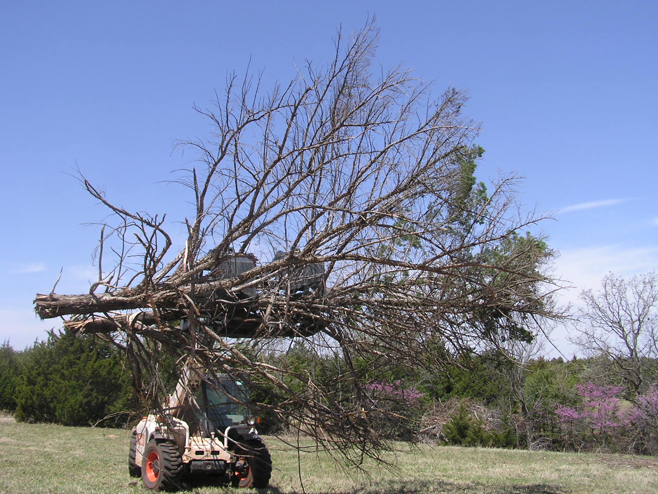

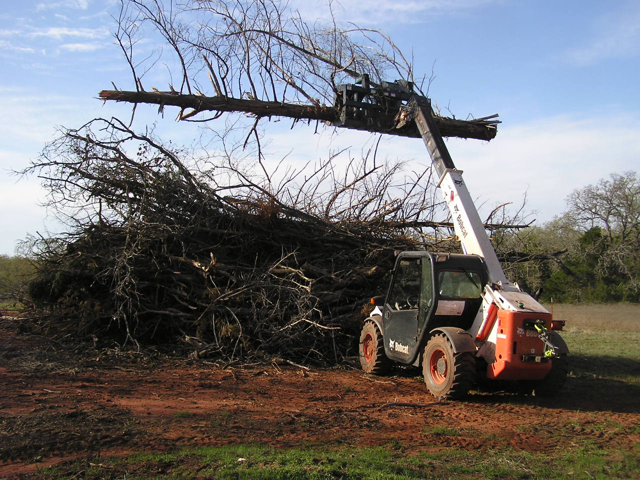

Use the grapple the most.

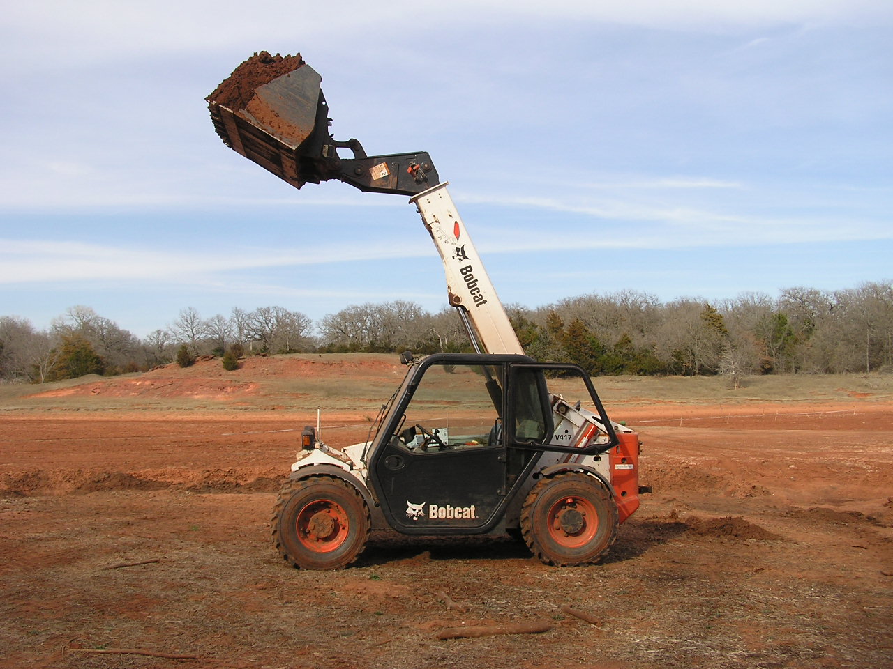

The 1 cubic yard, 6' dirt bucket, heaped, retracted the boom and raised it.
It will go 5.5 feet higher if I extend the boom :eek:

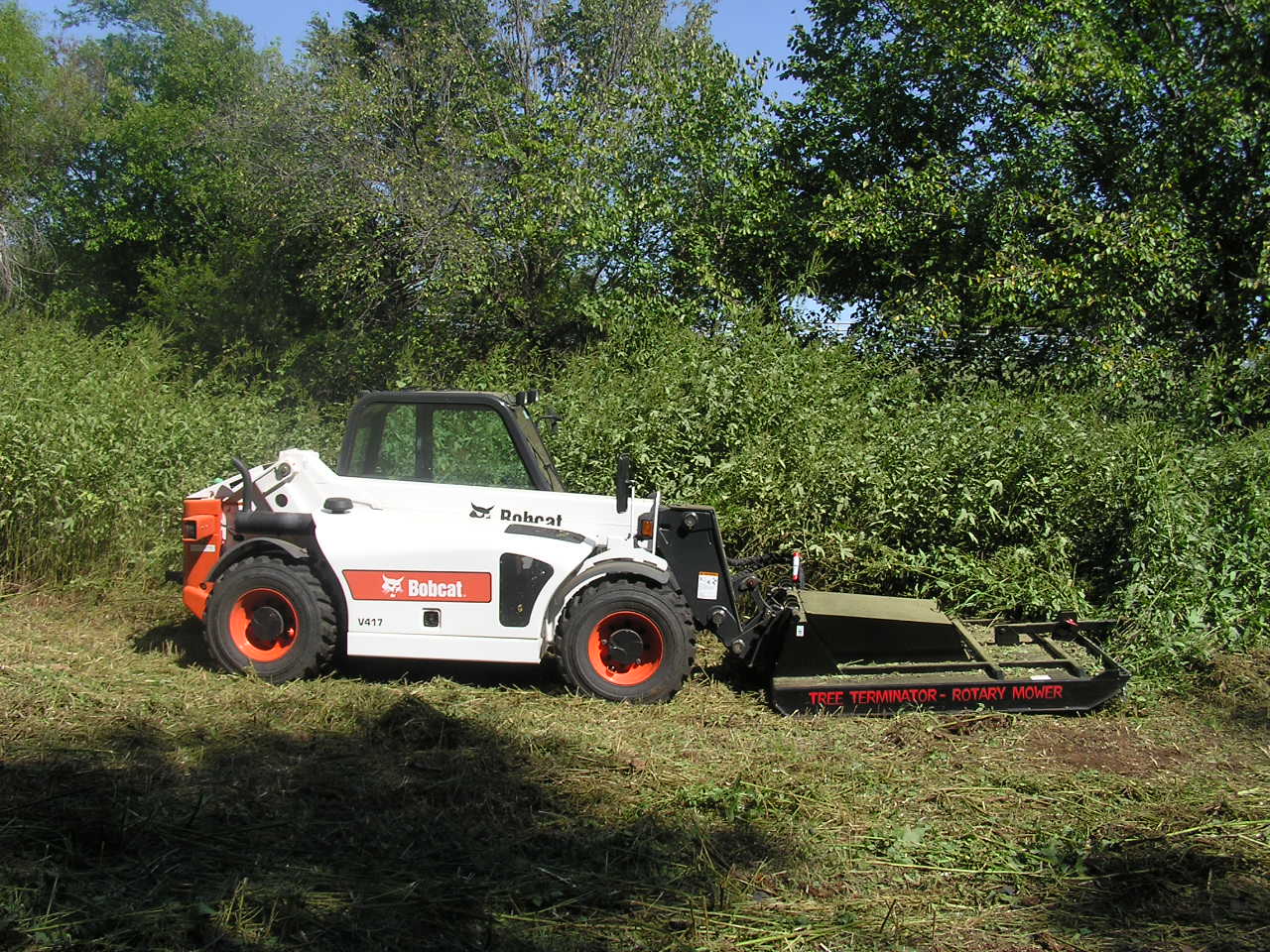

The 7' brush hog.
The V417 is 6' wide, 6.5' high and 13' long. Tire size is 14x17.5. Top speed is 15.5 mph, drawbar pull is 7,000 pounds, boom breakout force is 6700 lbf, bucket breakout force is 4700 lbf and it will lift over 5,000 pounds, 17 feet high.
