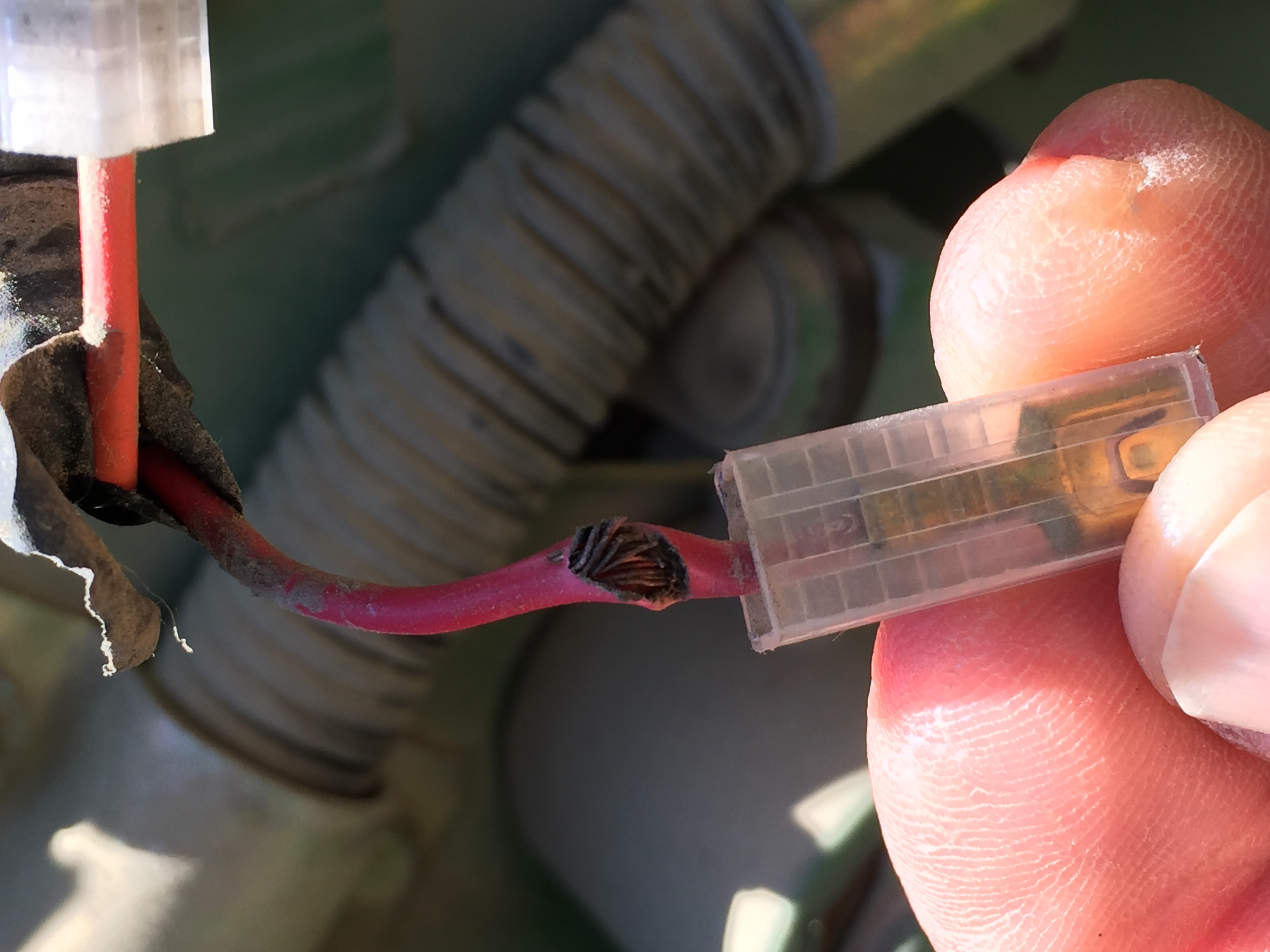

I had my battery tested as " good" and charged it with charger. Installed it in tractor but replaced 30 amp ACC fuse before battery. I unplugged the temp sensor. Tried to start tractor and got 1 click from switch, not starter. Got jumper cables out and connected to tractor. Decided to measure voltage (with digital volt meter) across other end of cables and got 1-2 volts! My positive terminal was arcing if I moved it by hand. I disconnected ground and tightened positive terminal very tight. Those factory lugs are not meant for repeated removal. Anyway that did it! I measure the same voltage across the other end of cables (12.85 Volts) as the battery terminals. Decided to not hook jumper cables to truck. Tractor cranked right up. The bad news is whenever I install a new 30 amp fuse in the ACC fuse block location, it smokes. Tractor on or off, key in or out. The tractor cranks fine with temp sensor plugged in or out! So what I concluded is the 30 amp fuse failure has probably been there since tractor new. If the 30 amp fuse smokes with temp sensor open and tractor off there must be a dead short in the 7 pin connector. I looked at the 7 pin connector and 5 of 7 pins are loose . They wobble if you touch with finger.
Does anyone know where the relay is that energizes the 30 amp ACC fuse? I don't see it on my fuse block. Also , I am going to try to find the problem that makes my 30 amp ACC fuse blow every time I install one (if battery connected). According to wiring diagram, the only load on it is 7 pin connector on trailer wiring harness. As I mentioned earlier, 5 of 7 of the pins are loose and wobble if you touch them with your finger. If I measure the resistance of each of the 2 auxiliary load pins with respect to ground ( pin 7 I think), I should see very low resistance if a wire is cut and touching frame compared to infinite resistance if the hot wires are not grounded? Does this make sense?

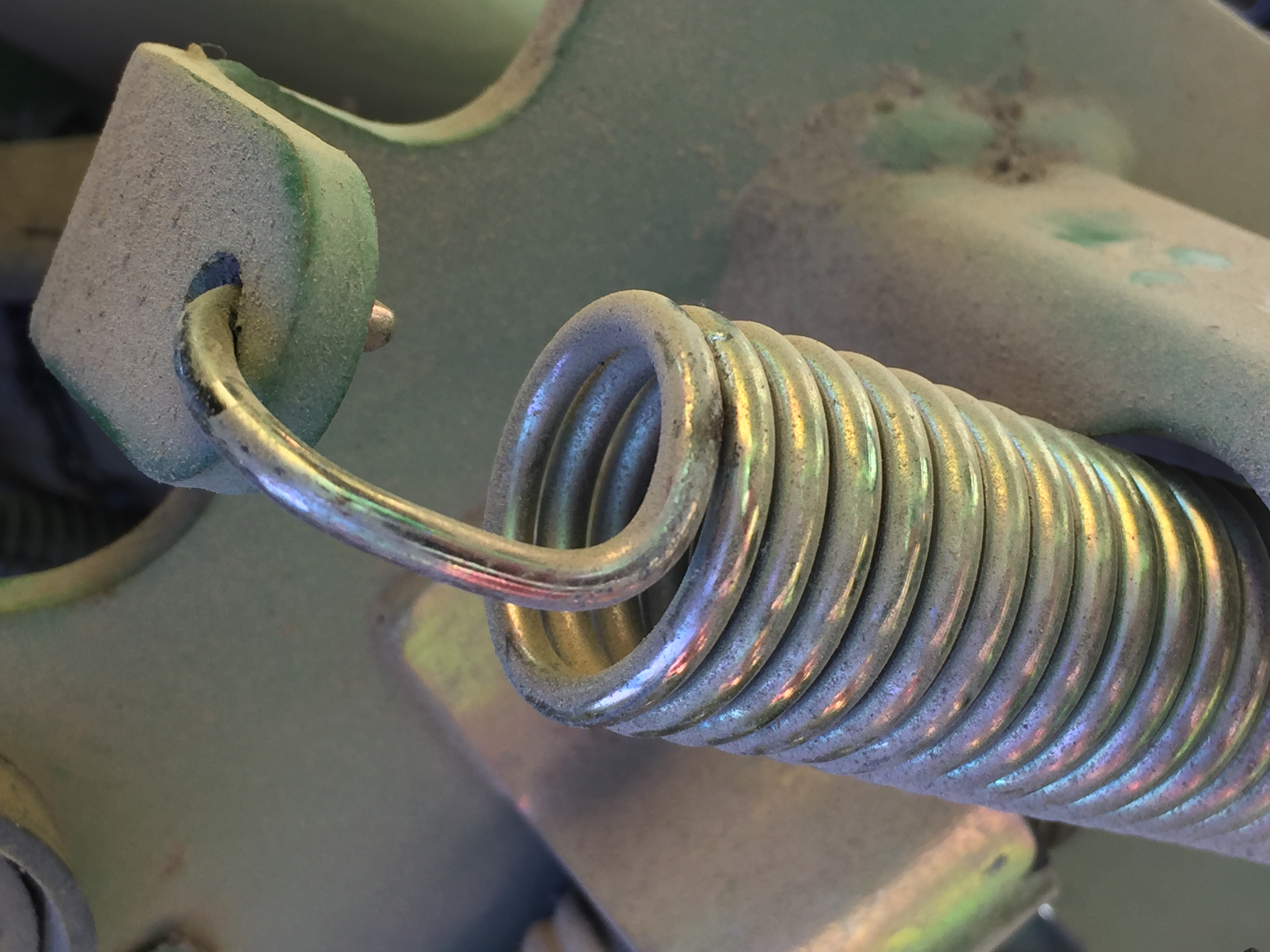

Finally found short in 30amp ACC fuse circuit. There are 2 wire connectors behind instrument panel near turn signal. It is on the 30 amp ACC circuit along with 7 pin connector for trailer. It can be used for an aux load or a horn. There is a corresponding pair of spare connectors under hood in battery compartment for a horn. The hot wire behind instrument panel had cut insulation and was caught between 2 coils of the clutch return spring. Once the short was removed by installing new connector and taping ends (since not used). I now have the 30 amp fuse (not blown for first time) and can measure 12 volts between hot and ground wire on 7 pin trailer connector. IMG_5620.JPGIMG_5621.JPG

It was a Deere Tech that works out of his Service truck. He was very good. I was with him so it was very educational. I think I can remove hood side panels, instrument cluster, face plate containing key switch and fuse block without breaking anything, now.
